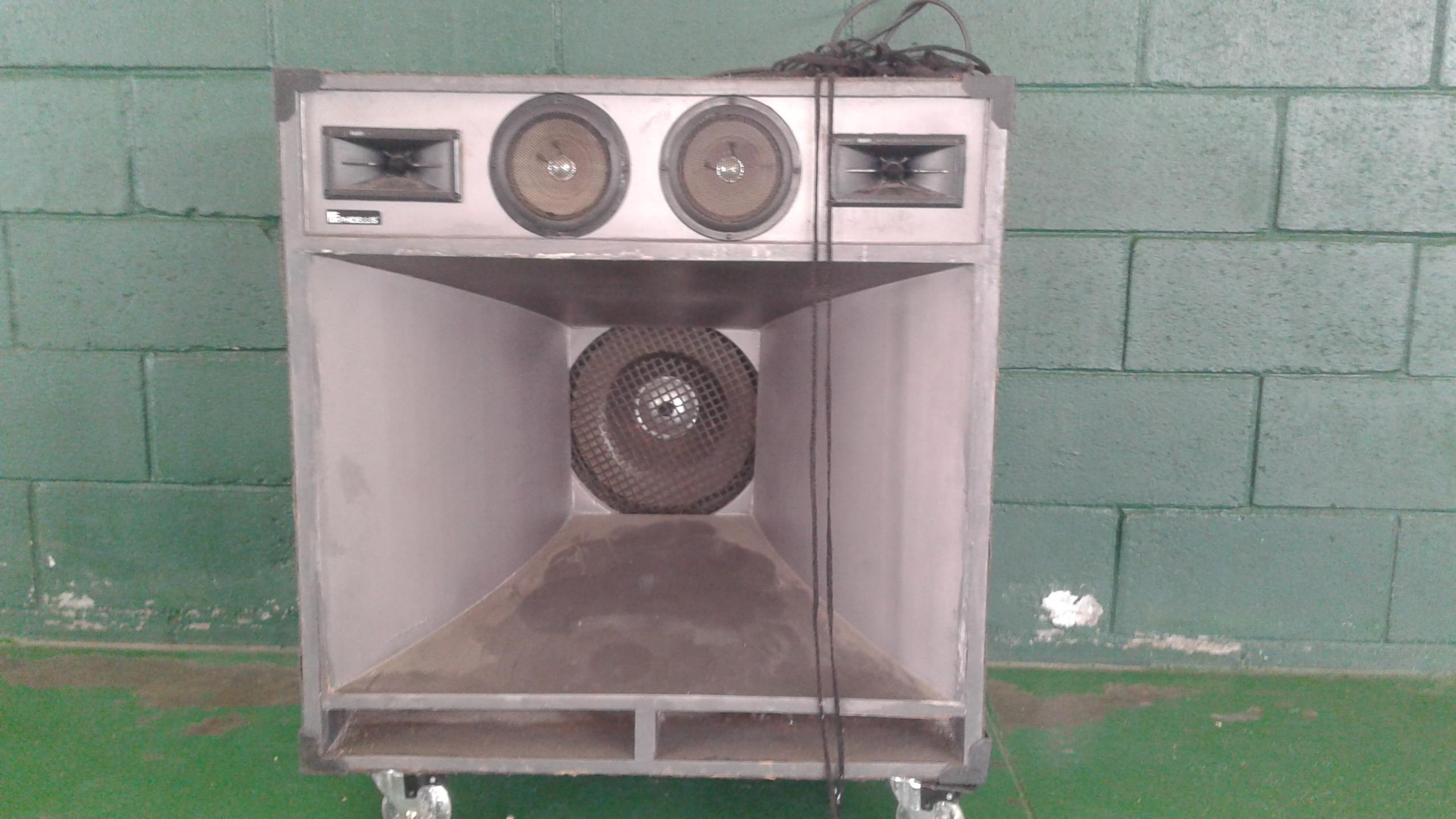

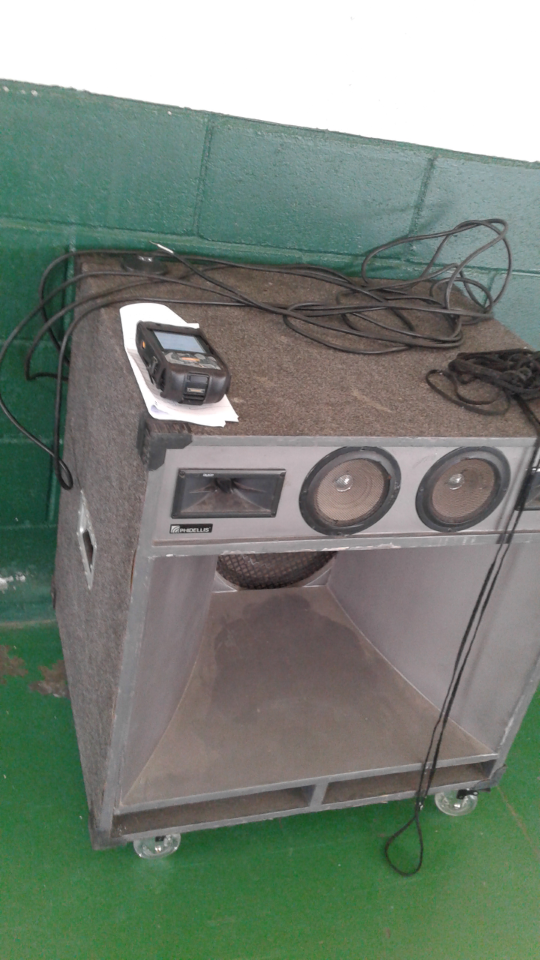

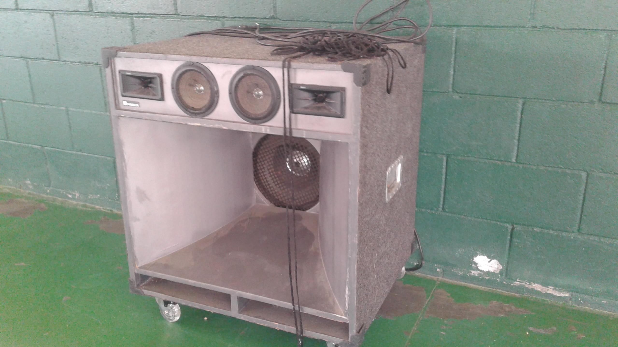

You guys know what model this box is? It is used for broadcasting at a local school. They claimed to have five of these at the sports gymnasium, another 2 at the entrance and two more spread elsewhere.
That paper sitting on top is an A4 for size comparision.
Particularly I liked it.
So, could someone guess what brand it belongs to?
It reads Phidellis.

I would now like to ask an question: does this horn have the capability of working on the quarter wave principle (and what bass it gives)?

Yeah the principle states a horn can work as an one close ended pipe that ressonates at the frequency corresponding to 1/4 the wavelenght of the lowest tone, which in turn is assumed to be exactly the horn mouth/ lenght. For example, at 340Hz the wavelenght should be 1m long. A 25cm folded horn is said to work at these frequencies. So, the quarter wave principle states a horn can have almost the same good results for waves 4x that long (i.e. it is 1/4 the lenght if the said wavelenght).
So theoretically the pictured box with its horn having approximately 50cm could work just fine with wavelenghts up to 4x50cm = 2m.
Given the formula f = v/ wavelenght ( v is the speed of sound and f the frequency), f is 170Hz, which is actually good for broadcasting voice.
But I doubt it can do that!

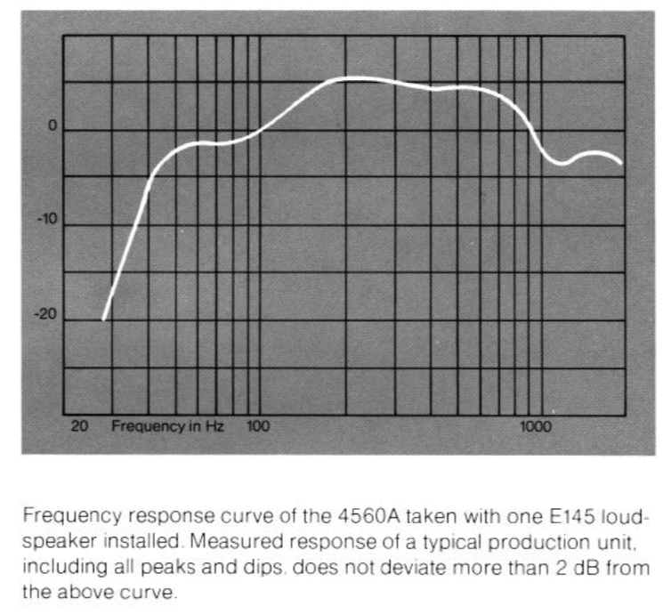

I need someone to tell me how far that JBL horn (which looks like to be the same cabinet except for those extra hi end stuff they've put into it) should be able to deal with.
Bern,I need someone to tell me how far that JBL horn (which looks like to be the same cabinet except for those extra hi end stuff they've put into it) should be able to deal with.
A horn similar in dimensions to the JBL 4560 box (36" x 30" x 24"deep) provides around 6 dB on-axis gain from 160 to 800 Hz.
The response below the horn Fc drops down to the ported response of the speaker used.
As can be seen by JBL's response curve using an E145, the 4560 horn does virtually nothing in the range below 100 Hz, but is an effective mid-bass horn.
The side by side placement of the mid/hi drivers in the "Phidellis" cabinet insures lousy off-axis response due to the path length differences introducing comb-filtering.

if there really is five of these i'd stack another one upside down on the first to make a big "sorta" D'appolitto with two but you would still need subs.
and some delay on the mid and highs...

Bern i may be mistaken but without a better close up it looks like someone used a collar/adapter and mounted a 10 inch driver into a 15 inch opening, or that's a weird compound cone bass driver??

Here are te box measurings
Width 70.5cm
Lenght 60.0cm
Height 71.0cm
Upper hifi bar (counting wood diameter) 17.8cm
Horn vertical apperture 45.5cm
Ports 2x 5.5cm by 33.5cm
Ports diameter (thickness) 1.8cm
Te corner protections are 5cm
