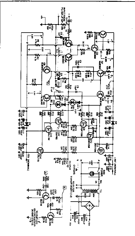

I have removed and checked all resistors in this kit. I have checked all wiring, especially on the output side. The fuse still blows with the volume down and no speaker attached - no load or input (this was when the FETs where in) Unfortunately I don't have a Variac. Thanks for the suggestions. Here is the schematic if it helps.
Liam.
