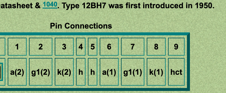

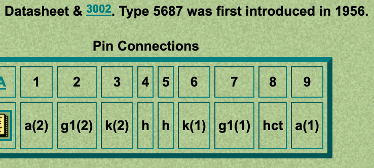

Hello I have a Audio Note Kits (ANK) Canada Dac 4.1 with tube output stage with two 5687 tubes.
For tube rolling I bought this socket from eBay
"1PC Convert Tube Socket 12BH7 (Top) TO 5687 (Bottom) Tube DIY Adapter Socket"
1PC Convert Tube Socket 12BH7 (Top) TO 5687 (Bottom) Tube DIY Adapter Socket | eBay
After using this socket with 12BH7a tubes instead of 5687 and starting the DAC big distortion in sound started with very little audio signal. The tubes got very hot. I immediately switched of the DAC.
After I removed the adapters and just used my original 5687. Still the same distortion and my tubes got very hot.
Did I destroy the DAC?
Can anyone of tube experts help please?
The Tube output is connected for I think 12volts heater supply to 5687.
So what I need to repair? Is main power transformer burned or I have to change some capacitor?
Thanking you in advance😕

^^^^^ THAT.
And measure and post plate and cathode voltages.
I suspect you lost bias or grid to ground reference because of some poor connection or mismatching and unbiased tubes pass tons of current (all they can), overheat, and operating point goes to h*ll.
All of which matches your symptoms.

Good News as per your tips I checked the heater voltages and plate voltages and the Tube socket Pins. Plate and heater voltages were right . One of the heater voltage pin was very near tube fixing screw so I straightend it .
And somehow now today it works !!!!! Normal. and good sound. All distortion is gone.
