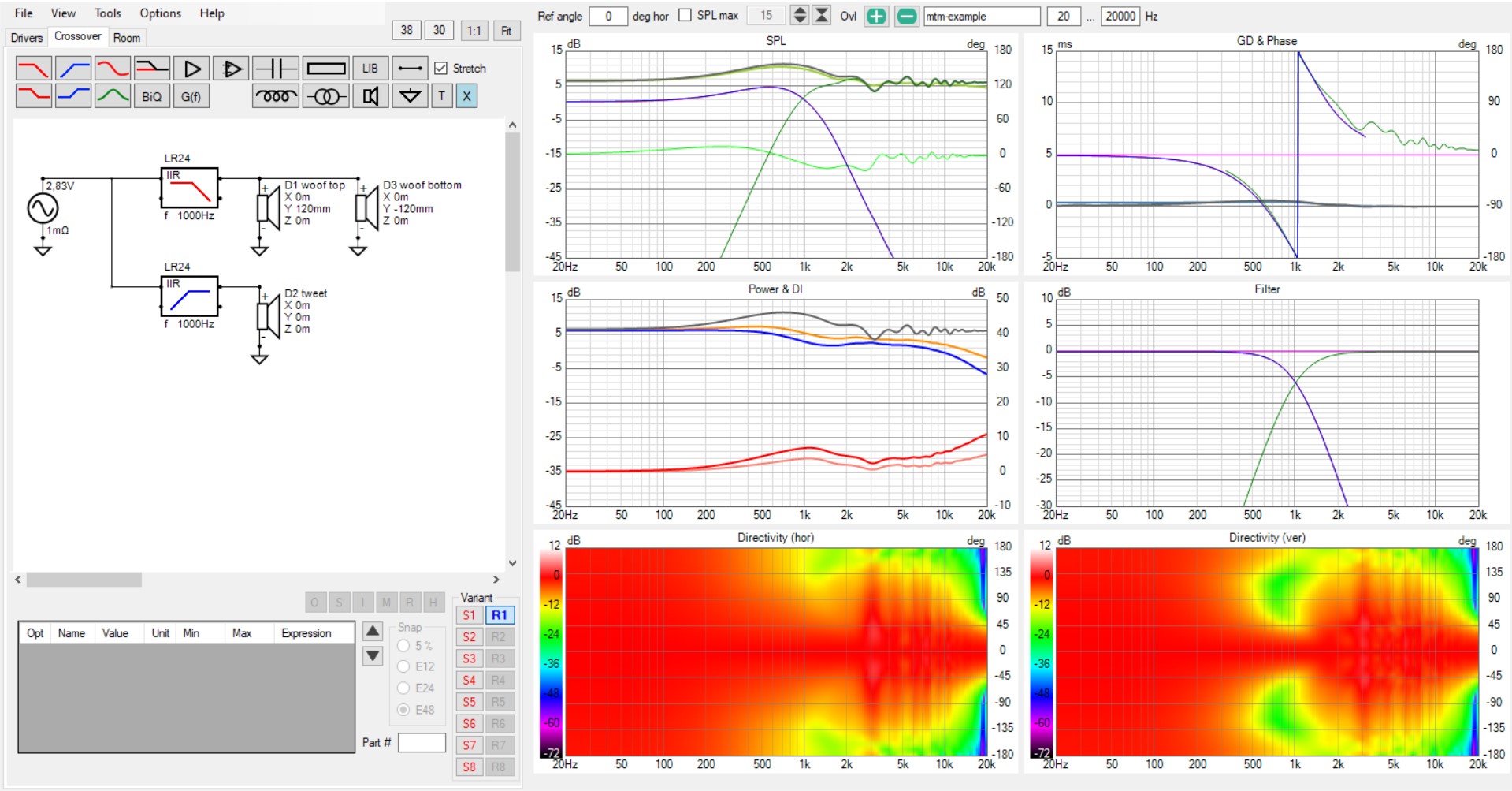

FYI ideal drivers in MTM configuration simmed on 18x42cm baffle.
1. ~24cm c-c, op drivers crammed as close as possible, xo 1kHz
2. xo 2kHz
3. xo 3kHz
4. reduced c-c with 2kHz crossover (not possible in reality with these drivers on a flat baffle)
5. all drivers coinsident ( not possible in reality ).
1" tweeter without waveguide crossed to a 6" driver makes peak in directivity index and dip in the power response no matter the configuration MT or MTM. Smaller woofers or waveguide for the tweeter would make things better.

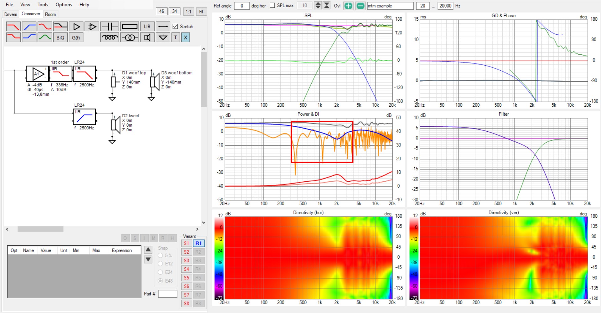

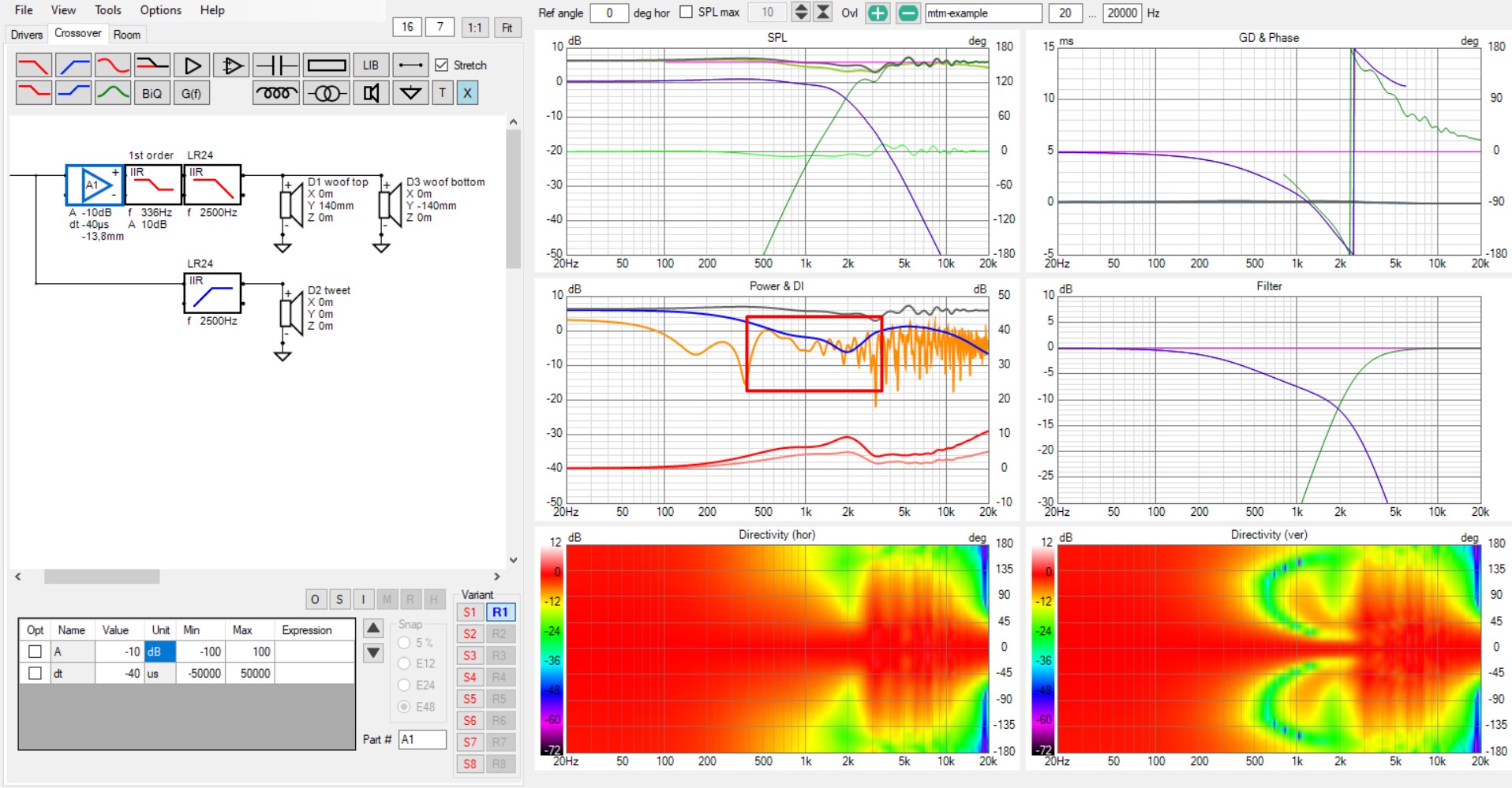

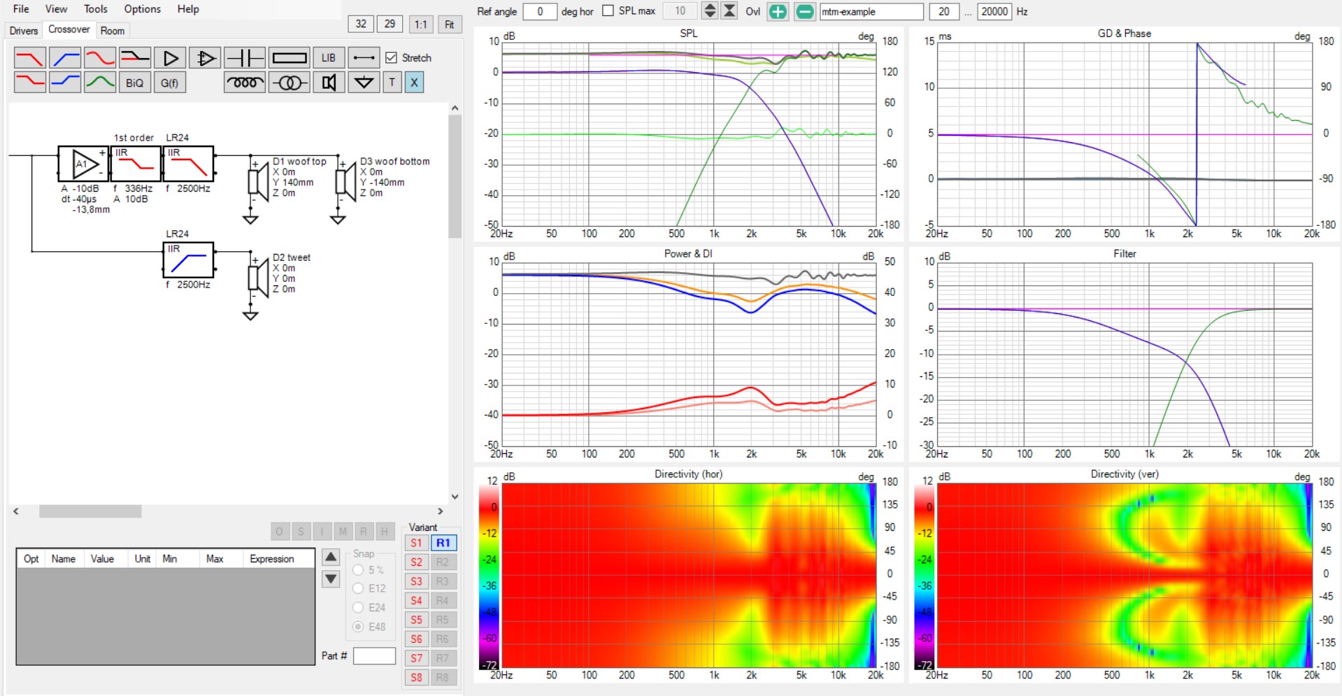

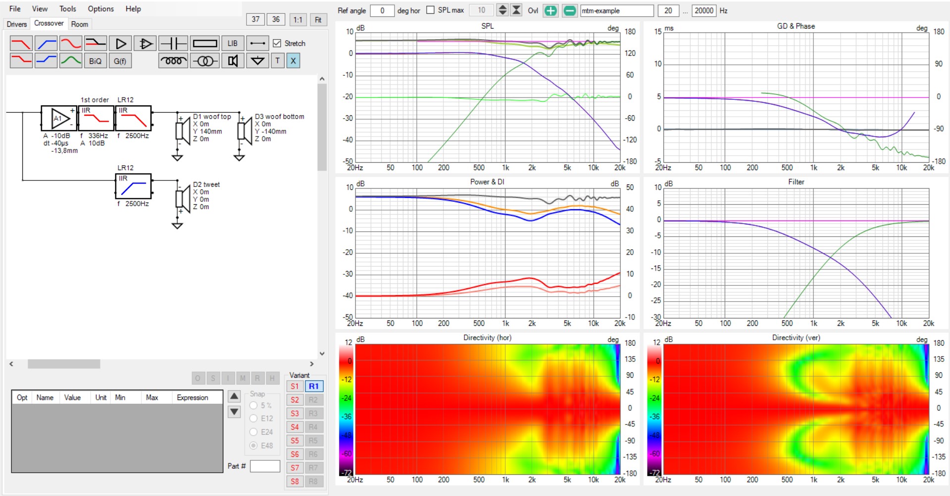

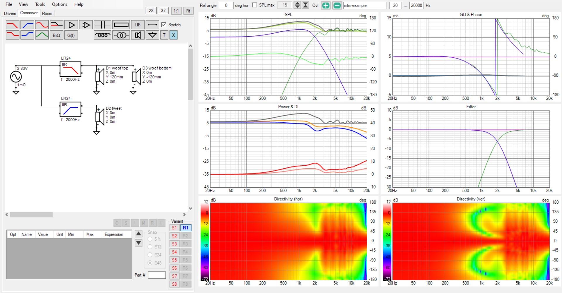

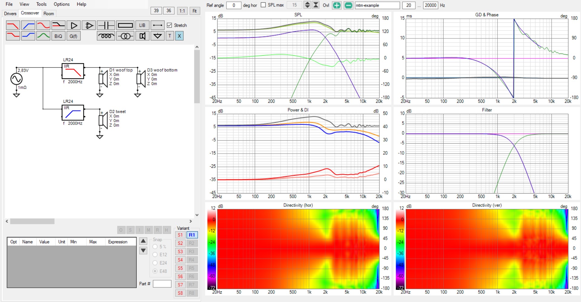

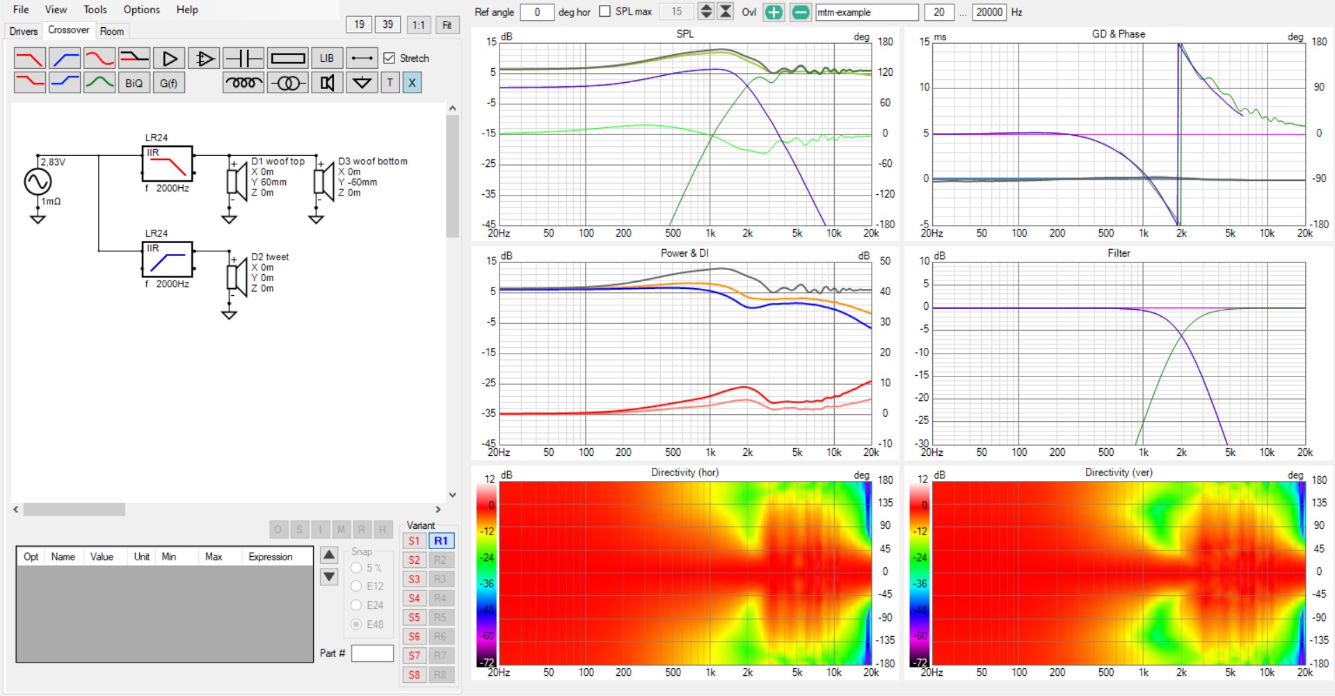

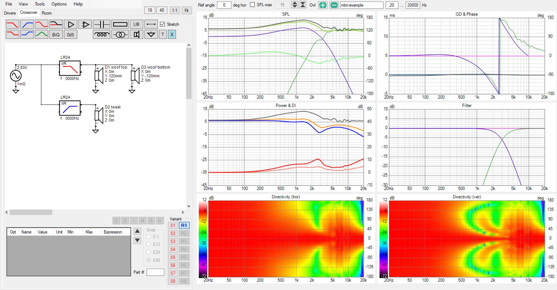

Since I still had the project open here is quick modification for previous example to your c-c and xo frequency. Added some baffle step compensation boost. Delay on the woofers is small and no much difference.
1. with LR4 filters
2. LR2
Yeah MTM smoothens out the floor and ceiling reflections. The orange line on the last two attachments is room response estimate with 240cm high ceiling, 90cm tweeter and listening height, 3m listening distance.
3. MT setup
4. MTM setup
Based on simulations I suspect if there is better sound in an MTM speaker it is due to this, reduced interference of floor/ceiling reflections around ~1kHz. If that is the case then this would be nice feature for any type of loudspeaker. At leas to my eyes the sims look like some other qualities like high frequency dispersion and power response smoothness is traded of for reduced floor and ceiling reflections where the ear is more sensitive... In which case there would be no point going for much smaller or larger mids, to get the reduced vertical dispersion here.

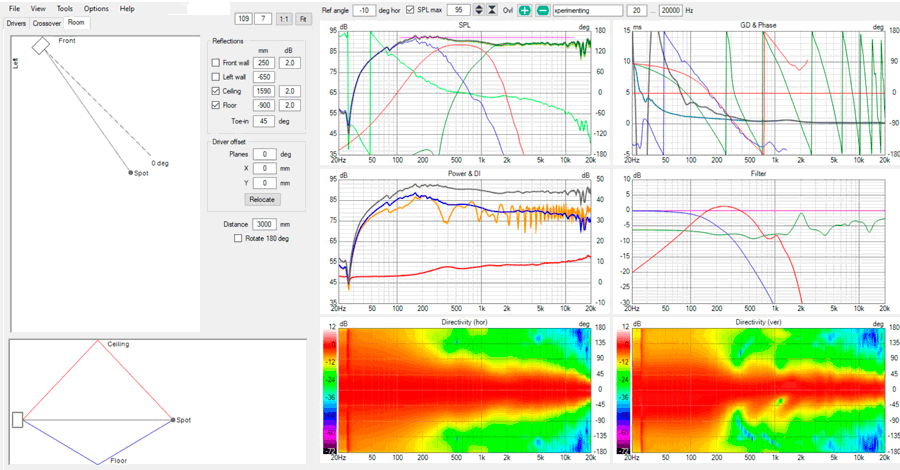

One more for the monolog. Popped up the c-c experiment mentioned earlier, modified it by little by adding another M above T. This is simulation of tall system with cardioid mid. It is originally WMT, 8" mid. In MTM setup c-c of the mids is 40cm with waveguide between.
It looks like that by luck the vertical dispersion gets narrower for the whole mid bandwidth for the current simulation of WMT. If i mute the waveguide tweeter massive lobes appear :O didn't investigate further. DI goes flat by luck, horizontal is a bit wider on the mid than on the tweeter and with MTM setup the roles change, if it matters at all. Anyway, nicer looking graphs with MTM is possible, although not sure if it sounds better. The orange in room estimate contains ceiling and floor reflections mentioned earlier, 3m etc. and their effect gets smaller with narrower vertical dispersion. Unfortunately the >1kHz region has still mucho effect on the ceiling and floor since the waveguide is not narrow enough. Make it narrower and everything else changes again.
Attached is a gif showing difference.
