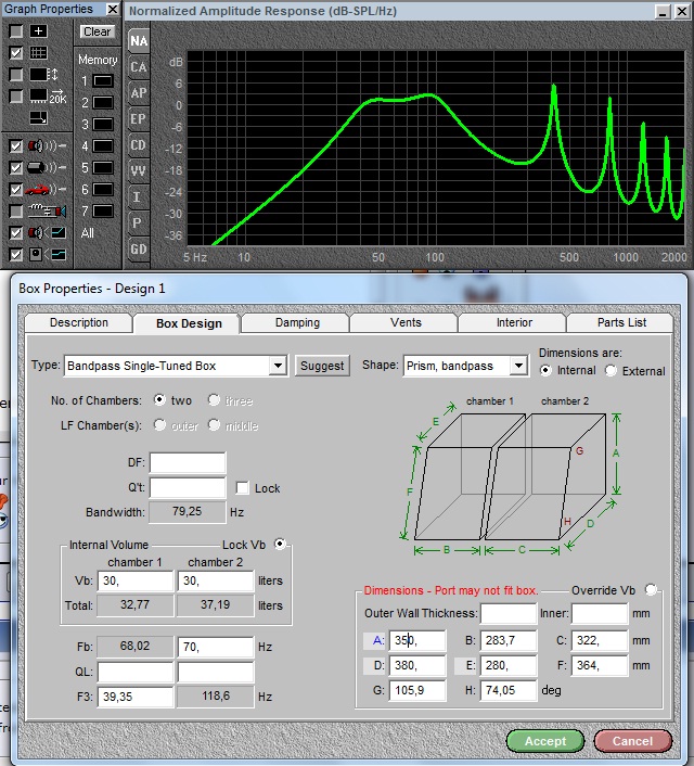

I have a Domotec 10'' MS-810 sub and a vw beetle. I want to design a sub for the beetle, with the mentioned driver.
T/S specs for the domotec (published not measured) are as follows:
Fs: 35,35 Hz
Revc: 3,80 Ohm
Zmax: 31,66 Ohm
Sd: 0,028 m2
BL: 7,2 Tm
Qms: 4,19
Qes: 1,22
Qts: 0,94
Vas: 56,97 l
Xmax: 6,86 mm
I've entered those parameters in BassBoxPro 6 and modeled up a BP4 box.
-First of all: i barely understand what DF and Q't in the box properties sheet means, and don't know what values to put in there.
-Secondly: Im unsure about car response. I've read somewhere that car gives a 12db per octave gain going down fro 80Hz.
I'm planning to put the sub in the free space behind the backseat of my bug...
so, any help on those numbers?
box dimensions where not the IDEAL suggested by software.
thanks in advance

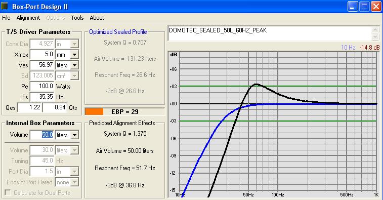

The simulated response looks absolutely horrible with cabin gain. I approximated the cabin gain from an internal cabin length of 1.9 meters. I could have done better, but my own beetle (-68 1500) is buried in a meter and a half of snow, so i cant measure it at the moment. 😱
I think you would be best off with as big of an closed box as you can live with, and stuff it full of that white fluffy stuff that people put inside of pillows. Such a box still needs a bit of boost in the bottom, but most car amps have that option anyway.
Your bandpass:
Sealed 60 liters:
Your bandpass:
Sealed 60 liters:
both sealed and bp4 has a huge and ugly peak at 50Hz, maybe i should flat it down with eq. I prefer a bp4 over a sealed for excursion control, and the extra output, so maybe moving the passband up can solve the peak.. or not?

Well, just for clearification, here is the sealed box together with the bandpass. I don't know what kind of power these subs can take, so my program just assumes 100w each, but that is not an issue below about 100Hz. The driver runs out of xmax before that:
This really messy graph shows what happens if you raise the port resonance frequency:
Oh, and i included a graph of a slightly larger box with two ports that goes all the way down, but still has that huge peak. A driver with a lower Qt is really needed for a good bandpass...

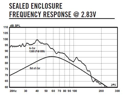

Hi gaston_pdu
My understanding for car sub is the box is tuned for high Q. Cabin gain will raise the lower frequencies.
Graph from JBL GT5-12 (12" car sub), shows Q and 12dB cabin gain for sealed box. From your TS parameters, you can't do a bandpass. Your Domotec MS-810 is for a sealed box. Any volume from 25L to 50L will work. Hope it helps.
can you explain why a bandpass design won't work? or it will work but the response will be too ugly?
thanks
gaston
thanks
gaston
thanks
gaston
Front loaded horns and single-reflex bandpass boxes are narrow bandwidth alignments. By juggling the variables, you can trade bandwidth for efficiency.
The problem that you're going to run into is that the high QTS value of your subwoofer will make it very "peaky" in one of these alignments.
It's not impossible to pull off, but you'd need a woofer tester and a microphone to flatten out the response.
If you're willing to invest the time, you'll be rewarded with an efficient box with low distortion.
If you don't have the tools to measure and tweak things, you'll likely end up with a box that's a one note wonder.
Limited bandwidth alignments like these can sound very clean if built properly, but they're very easy to screw up.
For a Bandpass, 150L box. Not very pretty. More important is Bandpass designs demand very accurate Thiele Small Parameters. Unless you can measure your sub, I would advise against it. I measure all my woofers and I can say less than 1% actually is the same as the manufacturers' specs. With a Sealed Box, it is much less of a problem.
