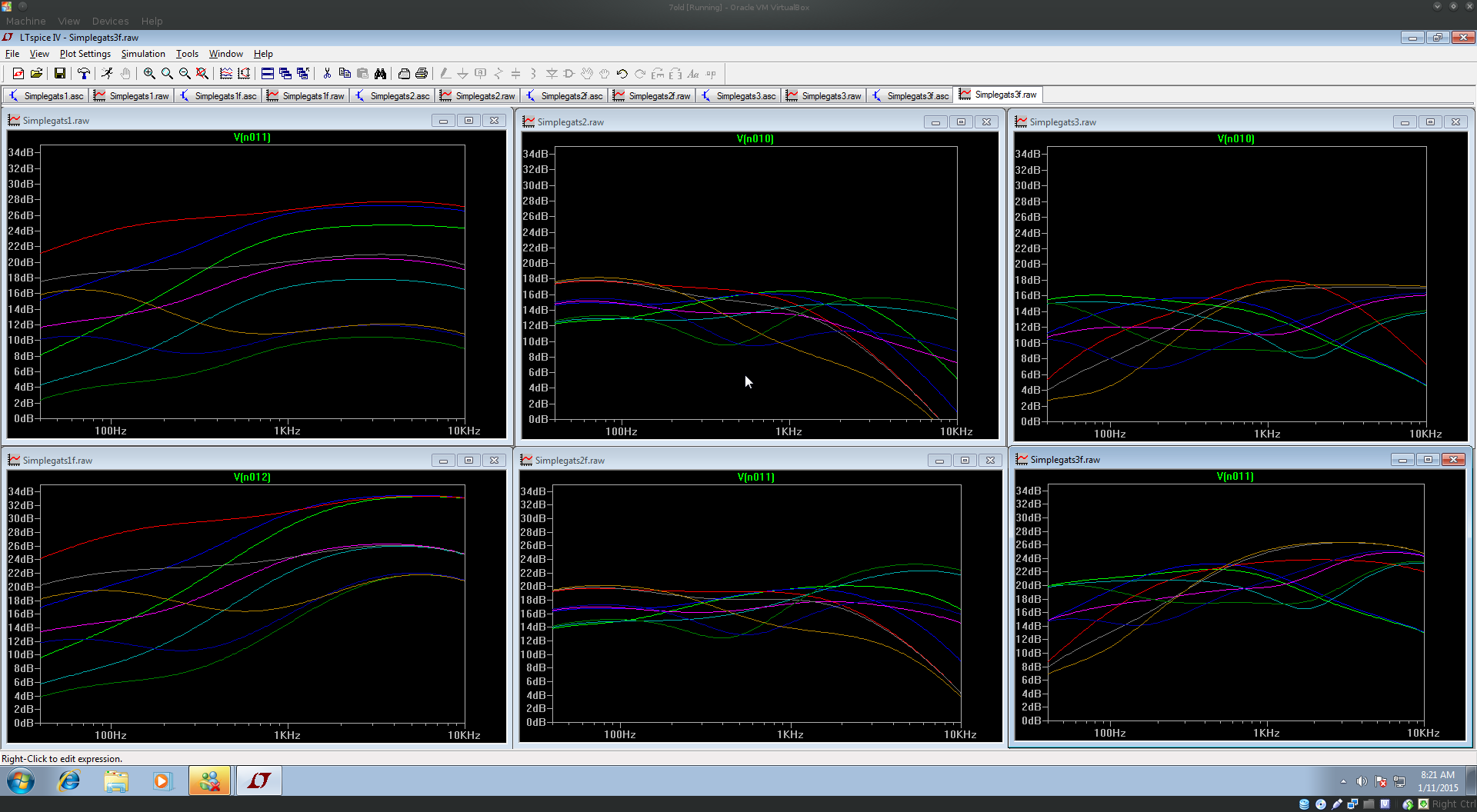

I'm trying to choose a tone stack for a guitar amp. I am inexperienced w/ guitar, and have only one one commercial guitar amp for comparison.
So, I'm basically wondering, what looks good for guitar tone controls, in the attached image?
Top row is w/out a source follower. Bottom row is with follower.
Left to right are the three different circuits I've tried. Left is the 'route 66' tone stack, which is well regarded.. But from the looks of it, it's not all that interesting.. Plus it is high heavy. And actually, w/ the follower, they're all high heavy.
But, maybe that's what I want in a guitar amp, since I can filter the highs directly at the guitar.
Any opinions?

It's very subjective I suppose, but I like the look of the top - right response. It seems to give a lot of control over the mid frequencies.
When I design an amplifier (for instance guitar amplifiers) I tend to only consider the frequency response of the whole amp. Are the sweeps you posted the whole shebang or only the tone stacks?
Whole amp, minus speakers... Those measurements are at the output transformer on my model.
I agree w/ Malcolm that the top right looks the best, but it's also the most lossy.
I like the higher gain of the cathode follower version, but it's top heavy. But like I mentioned before, maybe that's ok since I can roll off the top end at the guitar.. I'm not sure what guitarists usually like.
Right now the amp has got the top left, route 66 tone stack.. I'm not impressed.

It's kind of hard to know what voicing you prefer or like to use in a live situation. One thing maybe worth mentioning is the 'look' of a frequency plot and what you'll hear in the realized amp. Go for what your ears like, not your eyes. (I.e. I take it you know you can use wav-files as input in LTSPICE, then put out a wav file.)
If you don't wanna tinker with LTspcie any more build amp with the stack that gives you the biggest ranges regarding attenuation. Then you probably be able to find some sweet spots due to the fact that the alternatives are so plentiful.
The tone-stack that caught my eyes was the middle one in the lower row. It looks a little bit like the AB763 tone-stack. Well, my ears has got a thing for that tone-stack...

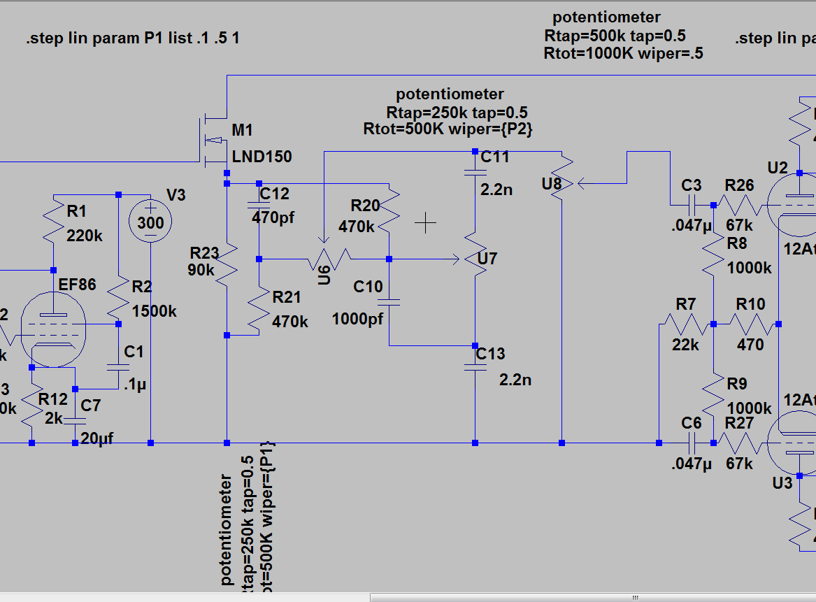

Would you mind posting the schematic?

I can't take any credit for it.. It's the 'bone ray' tone stack. Google for more info.
(Everything from (and including) the lnd150 to the last pot, labeled u8 in my schematic. Plot above this one, top middle in the pic in my first post, is the same tone stack w/out the lnd150)
Never hear of that tone stack. Seem a bit elaborate to throw in a FET in a tube amplifier... Ever consider going all tube? If you like to I can help you out with an all tube schematic (in LTspice).
Further, if you're not satisfied with the tone stack have a look at the 'tone stack calculator' Download. It's a simple way of getting inspired as they have multiple tone stacks presented in the soft ware.
Actually, couldn't be easier! only 2 parts.. the fet, and a resistor. No heat, no hole in the chassis. Using a tube would have been much more complex. It's a great way to quickly add a follower to any tube circuit. They're practically transparent, when used as followers, so no "sand sound" to worry about.
And yes, I did consider all tube, but I have limited space in the chassis I'm planning to use. (and I already have all the tubes I'm using.. This is a 0 cost project, just for fun)
