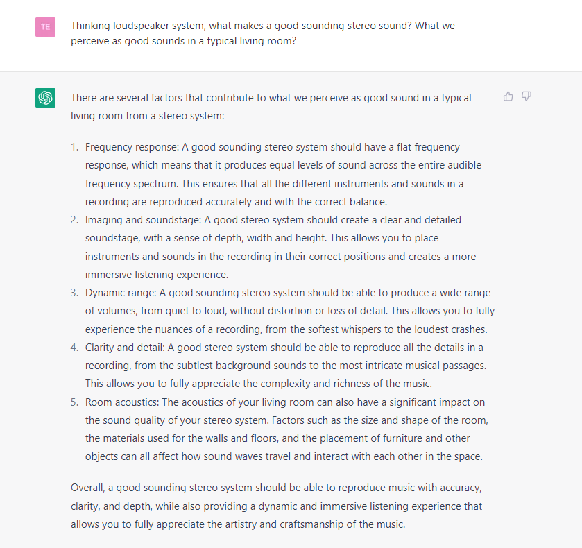

Perhaps my approach to speaker design is no better than whats in the opening post. Perhaps there is better approach to interact with the AI!? Hopefully people try it out and share if they find interesting things. All we care is nice sound with the resources we have, enjoying music and having fun with a hobby, right? It would be nice if anyone could have that without years of study and fat wallet 🙂
There is probably million ways to approach these tools. Below is one, just regular conversation type of thing starting somewhere and then led to more specific stuff. Minus side here is that one has to know what to ask because the ChatGPT starts to point to a professional loudspeaker designer / acoustician and for example the math seems to have some issues 🙂 Pointing to a real professional is good advice as such. I would think currently that this kind of a long winded discussion would give much better rate of success how to make a good loudspeaker than just asking for blueprints. Well, perhaps it would give nice blueprints, never asked 😀
Me:
how to make very good loudspeakers?
ChatGPT:
Designing and building high-quality loudspeakers requires a combination of technical expertise, attention to detail, and a good understanding of the principles of acoustics. Here are some general steps that can help you create very good loudspeakers:
Determine the application: What will be the primary use of the loudspeaker? Is it for home audio, professional audio, or something else? This will help you decide on the size and configuration of the speakers, as well as the components and materials you will need.
Choose the drivers: The drivers are the components that actually produce the sound in the speaker. This includes the woofer for low frequencies, the tweeter for high frequencies, and possibly a mid-range driver. Choose drivers that have a good frequency response, low distortion, and a high power handling capability.
Design the cabinet: The cabinet is the enclosure that houses the drivers. The design of the cabinet can have a significant impact on the sound quality of the loudspeaker. Factors to consider include the size and shape of the cabinet, the materials used, and the placement and configuration of the drivers.
Select the crossover: The crossover is the component that divides the audio signal into different frequency bands and sends them to the appropriate driver. A good crossover will ensure that each driver receives the appropriate frequencies and that the sound is balanced and coherent.
Assemble and test: Once you have all the components, assemble the loudspeakers and test them thoroughly. This includes measuring the frequency response, checking for distortion, and listening for any anomalies or issues.
Fine-tune and adjust: Finally, fine-tune the speakers by adjusting the crossover, cabinet design, and other factors as necessary to achieve the desired sound quality.
It's important to note that designing and building high-quality loudspeakers can be a complex and challenging task, and may require specialized tools and expertise. If you're not confident in your ability to design and build speakers from scratch, consider using a pre-designed kit or working with a professional speaker designer or manufacturer.

Design the enclosure: After selecting drivers, you will need to design the enclosure that will hold them. This involves determining the size and shape of the enclosure, as well as any additional features such as ports or passive radiators.
Fine-tune the design: With the basic design in place, you can start fine-tuning the loudspeaker to achieve the desired performance. This may involve adjusting the crossover network, selecting suitable damping materials, and optimizing the driver placement within the enclosure.
Overall, while selecting drivers is an important step in loudspeaker design, it's generally best to start by determining the intended application and choosing a basic design. From there, you can select drivers and make other design choices based on your goals and requirements.
Me:
how to determine which loudspeaker design suits my application? How to outline my application?
ChatGPT:
Determining which loudspeaker design suits your application depends on a variety of factors. Here are some steps you can take to outline your application and choose the right loudspeaker design:
Determine the intended use: Are you designing a loudspeaker for home theater, music playback, live sound, or some other application? The intended use will affect many of the design choices you make.
Determine the room size and acoustics: The size and shape of the room where the loudspeaker will be used will affect the overall sound quality. You'll need to consider factors such as room reflections, resonances, and other acoustic properties when choosing a design.
Determine the power requirements: How much power will the loudspeaker need to handle? This will depend on factors such as the size of the room, the intended listening level, and the type of music or content being played.
Determine the desired frequency response: Different loudspeaker designs have different frequency responses. You'll need to consider factors such as the desired bass extension, midrange clarity, and high-frequency detail when choosing a design.
Determine the budget: Loudspeaker design can be expensive, so you'll need to consider your budget when choosing a design. Keep in mind that higher-end designs may require more expensive components and materials.
Once you have outlined your application using these factors, you can begin researching and comparing different loudspeaker designs to find the one that best suits your needs. Consider factors such as the design's frequency response, power handling, and cost, and be sure to test out different designs if possible to find the one that sounds best in your particular application.
Me:
Its living room use, for music playback. I don't know what my room acoustics are, its a typical apartment living room. Big window, some furniture like sofas, hard walls, floor and ceiling. I cannot use much power, its expensive. I need to use small class-D amplifier that drinks small amount of power. Frequency response needs to be from 30Hz to 20kHz. Budget is limitless, manufacturing capability is also limitless but I don't want to use any audiophile nonsense, just good engineering principles.
ChatGPT:
Based on your requirements, here are some loudspeaker design recommendations that may suit your application:
Bookshelf loudspeakers: Bookshelf loudspeakers are a compact and versatile option for music playback in a living room. They are typically designed to be used on a bookshelf or stand and can be paired with a small class-D amplifier to keep power consumption low.
Sealed enclosure design: A sealed enclosure design is a simple and reliable option for a bookshelf loudspeaker. It provides good low-frequency extension and can be designed to have a flat frequency response across the desired frequency range.
Two-way design: A two-way design with a woofer and tweeter is a common choice for bookshelf loudspeakers. It can provide good midrange and high-frequency performance, and the woofer can be chosen to provide good low-frequency response within the constraints of a sealed enclosure.
Use well-regarded drivers: While you don't want to use audiophile nonsense, it's still important to choose high-quality drivers for your loudspeaker. Look for well-regarded drivers that have a reputation for good performance at reasonable prices.
Consider crossover design: The crossover network, which divides the signal between the woofer and tweeter, is an important part of loudspeaker design. A well-designed crossover can help ensure a flat frequency response and good performance across the desired frequency range.
Overall, a sealed two-way bookshelf loudspeaker design with well-regarded drivers and a carefully designed crossover should be able to meet your requirements for a living room music playback system. Be sure to prototype and test your design before committing to manufacturing to ensure that it performs as desired.
As far as I can tell, it's currently an information aggregator with a pleasant user interface that can often repackage the ideas of others. It writes interesting text at times that makes people think it's thinking deeply, but it's not. Engineering/technical pursuits beyond those that have already been precisely described by someone else require a level of precision, understanding, and extrapolation that seem missing from these kinds of tools at this time.

No, there is no standard size for all speakers.
So I asked chat gpt to design a speaker to see whether it is work ready and ready to work for us. How would you improve chat gpts design, do we need to add details about box stuffing or lining? Crossover points and slopes etc? Are the box dimensions right? Has speaker design plateaued or will new technologies arise?
New speaker technologies will eventually emerge, but each could be seen as just another plateau.
The box dimensions are not right or wrong, a "design" would specify crossover components and wiring diagram, individual chamber dimensions (the sealed back tweeter does not require a separate chamber) Fb, and would include bracing and stuffing details.
