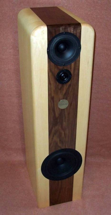

Below is a photo of my Sonatello 3-way design/build that used your SB woofers in a 25:1 tapered TL.
Paul

I love your designs Paul! Great craftsmanship and they got a nice retro feel to them, great job!Below is a photo of my Sonatello 3-way design/build that used your SB woofers in a 25:1 tapered TL.

I appreciate your compliments about my speaker building endeavors.

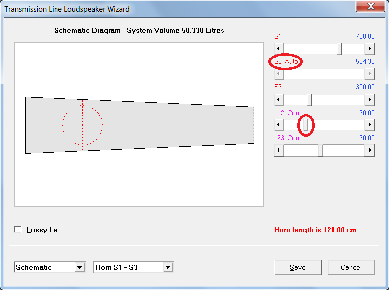

I have a really hard time to dial in the optimum values for S0, SL, line length and especially the driver offset.
Using the loudspeaker wizard, set S2 to Auto by double clicking on the 'S2 Manual' label. Adjust L12 to change the driver offset without altering the overall length or taper. Press Crtl+C to capture current results, and Ctrl+V to view captured results as a light green trace. Press the Esc key to hide displayed captured results.
For a given driver, it should be possible to optimise a TL design in Hornresp in a few minutes.
OMG, thanks David. I knew everything except the cut and paste -> green trace, brilliant! The loudspeaker wizard is great but it would be great with a higher resolution graph window...Press Crtl+C to capture current results, and Ctrl+V to view captured results as a light green trace. Press the Esc key to hide displayed captured results.
