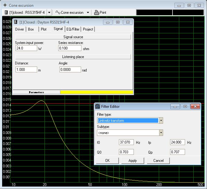

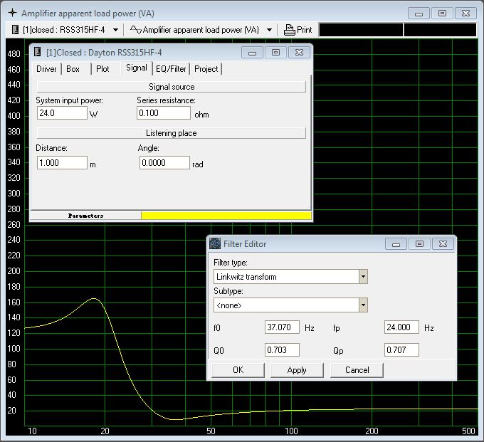

I've got what I think is a pretty good design for a subwoofer (see http://www.diyaudio.com/forums/subwoofers/191769-sealed-sub-rss315hf-linkwitz-transform-10hz.html) but I'm not sure how powerful of an amp I'll need. I used WinISD to calculate all my specs, yet the apparent load power seems very low compared to what I've read low boost circuits need. Attached are pictures of WinISD's calculations of apparent load power, and signal input to achieve the maximum cone excursion (xmax + 10%) acceptable in a sub. I thought these low boost circuits required many more watts than rms for the sub, which is why I'm very confused as to how it only needs 160W (according to the graph.
Just as a follow up, I did all the calculations by hand, and came out with the same voltage requirements, roughly 170 watts. This doesn't seem true, but my linkwitz transform only adds 7.55dB of gain, and the PEQ adds 4, resulting in just about 10.06dB of gain at 20Hz. Using that compared to speaker sensitivity and my desired listening level at about 98dB, I only get a load of 170W. How is this possible? I thought LT circuits sucked up massive amounts of power. Is this design really that good? If so, I'll gladly build my own high end, low power amp (200W) instead of trying to save by buying some behringer or peavey powerhouse.
Ten dB of gain is the difference of 170 watts to 17 watts. Most would think that is a massive change, though somehow 100 to 1000 seems like more, even though it is the same.Just as a follow up, I did all the calculations by hand, and came out with the same voltage requirements, roughly 170 watts. This doesn't seem true, but my linkwitz transform only adds 7.55dB of gain, and the PEQ adds 4, resulting in just about 10.06dB of gain at 20Hz. Using that compared to speaker sensitivity and my desired listening level at about 98dB, I only get a load of 170W. How is this possible? I thought LT circuits sucked up massive amounts of power. Is this design really that good? If so, I'll gladly build my own high end, low power amp (200W) instead of trying to save by buying some behringer or peavey powerhouse.
If 170 watts does not exceed Xmax, and gets loud enough for you, no problem.
However, 98 dB at one meter will be only 92 dB at 2 meters, and 92 dB at 20 Hz sounds about as loud to your ear as 40 dB at 1000 Hz.
Maybe cabin gain will work in your favor, there is always hope 😀.
WinISD has an apparent load (VA) tab that tells you what power is coming out at what frequencies - very useful for stuff like this. I only discovered it after building my first half-decent subwoofer, and now understand why it ran out of steam so quickly.

Ok. I just wanted to make sure I was calculating correctly. And I had a feeling it was right but I wasn't sure. And I do get that it's going to be quiet, but that's why I built two of them. Somewhere in the thread I linked to earlier i have a graph of spl with two subs (around 106dB iirc).

A lot of the questions are similar, but I never recalled getting a definitive answer. I was still very skeptical about only needing around 200W per side considering the RMS power of the driver is 400W. I was planning on having to buy some huge expensive amp which is why I never finished them (budget issues). But now that I know they'll only cost around $200 to finish, I'm going to get started on them again. That thread got so long that I honestly forgot what had been discussed and what hadn't, so thanks for being patient with me!
10 dB is a lot to ask for out of a LT. I try not to exceed 6. If I remember, Siegfried cautioned everyone about getting carried away. Use the room, or just plain get a sufficient driver. My subs ( pair of 12" Peerless XLSS in 70L boxes) measure pretty weak out in free space, but are quite musical using the room boundaries. My cement floor helps. I prefer clean to more.
Plenty of definitive answers from others in that thread, as well as the generalizations I made.A lot of the questions are similar, but I never recalled getting a definitive answer. I was still very skeptical about only needing around 200W per side considering the RMS power of the driver is 400W. I was planning on having to buy some huge expensive amp which is why I never finished them (budget issues). But now that I know they'll only cost around $200 to finish, I'm going to get started on them again. That thread got so long that I honestly forgot what had been discussed and what hadn't, so thanks for being patient with me!
You are the only one deciding definitively what will work for you, and your room will make more difference in the response of your speaker than anything else, finish the subs and EQ them to the room and your taste.
