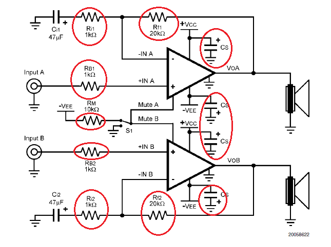

I am trying to build a stereo amplifier based on TI's L4780 chip using the LEAST possible number of external components. I am using a dual rail power supply. I checked the forums and every circuit diagram I found is based on the reference datasheet from TI. Most bill of material have 6 more resistors and 4 or more capacitors.

Please see the attached image.
If I use a good quality power supply, can I eliminate the 4 capacitors (cs) that are in series with the power rails? How about getting rid of the resistors that I circled in red?

No one of the resistors can be deleted, because they fix the negative feedback to the amplifier, ensuring gain and distortionless operation. Caps are not recommended to be eliminated, they decouple the amplifier. Moreover, you probably MUST add some components, like a zobel network at the speaker end of the coil. Also, probably must add some ceramic .1micro 50V between power rails and ground, as closely to the chip as you can.

That is about as basic as you can get ..for a non inverting amplifier. You could get away removing another resistor by building it as an inverting amplifier.From the questions you ask i can tell you have very little expirience. for the amplifier to be a working first build go have a look at the data sheet and use all components listed wrongly as optional.You really need a capacitor on the input to block dc too unless you can guarentee your source is dc free. Also do a search on this forum for lm3886 and read lots and lots. By the way the chip is made by national semiconductor and not ti . ti recently merged or bought out national semi but they still run as seperate companys Even when you request samples from ti it takes you to nationals site. Best of luck you will need it Watch out for your loudspeakers too.. see the man above knows what he is talking about

Ri/Rf controls the feedback loop (gain) and are essential. Removing Rm would mute the amp. Removing CS would result in an unstable power supply (they smooth out the converted AC wave to a steady stream of DC). RB is optional but unless you know what its effects are you should probably not remove it.

The engineers who developed the ICs are not magicians. The power IC must be decoupled from the power supply. If the chip seems stable, your leads from the main PS filter caps must be fairly short otherwise it can go into oscillation. I recommend PS decoupling film caps very near the chip and the whole arrangement on a star ground layout.
You may be able to get away without the output boucherot cell depending on the load characteristics, but I would include it.
I'd also include a low pass filter on the input to prevent frequencies beyond audio from entering the amplifier.

I don't think you understand. The point of the gain resistors is so you can set up an amp appropriate to the gain you want, based on input level, output level, power supply limitations. Some other chipamp chips do have fixed gain.
You wrote "good quality power supply". A good quality power supply is every component from the wall outlet to the chip's power pins. There is no need for the CS capacitors at the power supply, they are to reduce ripple caused by the chipamp in operation and thus, should be as close to it as physically (reasonably) possible.
That you can get a chip to produce sound and not have it oscillating in your particular circuit is no proof it is operating at the specs and capabilities. It could end up sounding no better than less costly chips, not reach its supposed output power so you wasted money on the power supply and heatsink size & capacity.

Saying "it works" is almost meaningless, unless you have the test equipment and knowledge to say HOW WELL it works.
Eliminating the four decoupling capacitors will not only set it up for possible stability and high-frequency oscillation/overheating problems. It will also limit the output's rise-time speed and hurt the transient response characteristics, making them dependent on the length of the power supply and ground rails, i.e. the rails' inductances. You will have raised the power supply impedance, as seen by the power supply pins, especially at higher frequencies (not a good thing, for sound quality). Those capacitors are meant to also act as a small local power supply, to supply the fast transient currents needed, since the rails' inductances won't allow the main psu caps to supply them. Without them, you get much larger fluctuations in the rail voltages (due to the transient currents attempting to flow through the rails' inductances), which can also cause instability and even oscillation, which can destroy the chip but would certainly lower the sound quality. You will have also increased the susceptibility to RF and other interference.
Eliminating the resistors, which should be mounted close to the chip pins, will expose the pins to stray capacitance and inductance (more potential stability problems), as well as worsen RF susceptibility. And a unity-gain configuration is of limited utility. Many chipamps are not even stable with gains of less than 10 or so.
