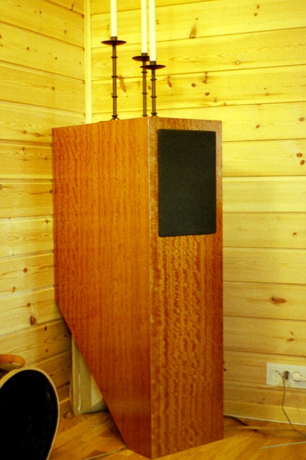

I am fan of lowther, i prepair to build plan for driver lowther, i loved plan: Big Fun Horn but it less information about it. I think by this desgin i cant successful to build Big horn - How can you help me detail of Plan (Cabinet) of Big Fun Horn and CNC of it
The Big Fun Horn is Ketil Parow's baby. A big rear loaded horn meant to be used in the corner, it is capable of bass response to the low 30's. Truly a full range system. The All Fun horn is similar, but smaller and slightly less bass response.

The plan as drawn seems perfectly adequate for a construtor to make this speaker with. I don't know what you mean by making a better plan? You mean a cut-sheet? That is quite a bit of work as each piece (and there are many) need to be drawn (or modeled) in CAD and them the program can auto optimize the placement for a cut sheet or a good designer can layout the cut sheet manually. Either way, you are talking about a full 3d design from a 2d plan.

There are some other drawings with a little more detail available here: Lowther-America
According to the website, Lowther-America also sells full-sized detailed plans.

Thanks all, how this Big fun horn is suitable for lowther driver ? Pm6, Pm2, Dx3, Dx4 ,...
I've just seen your thread and since I own a pair of plywood BFHs, I thought I might post a reply. The Big Fun Horn has a large but rather shallow compression chamber. The Lowther PM2A, 5A and 4A are too deep to fit in the BFH. the PM6A gives a very poorly controlled bass. I'd strongly recommend the PM7A. This gives a lovely balanced, very listenable, presentation and works well with a variety of solid state and valve amplifiers. The Lowther DX3 also works well giving a more 'modern' detailed sound.
