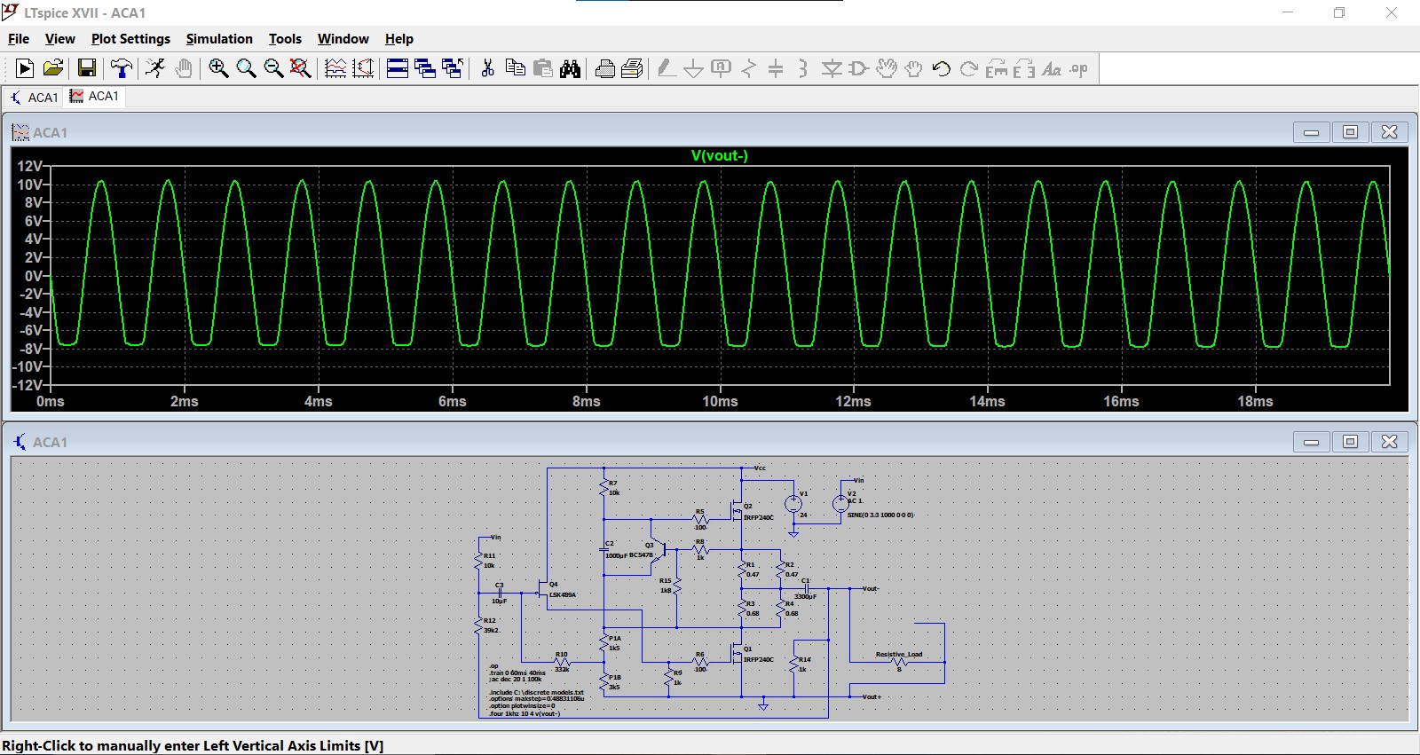

My simulation of the ACA shows about 7 watts rms into 8 ohms as a maximum achievable. If yours looks like this then you will probably find the midpoint volts is to low.
As you have a scope you can adjust the midpoint voltage setting of the ACA to give symmetrical clipping.
Are these ACA's built from the kit or are they totally diy'ed from scratch. Also are they using the recommended Meanwell 24 volt power supply?
