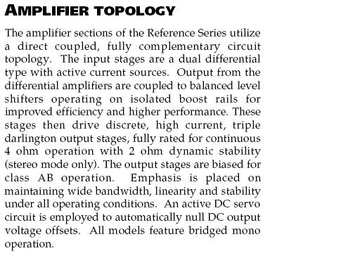

Hi tarnationsauce,
Okay, I couldn't find where they say it can't be serviced. I did find a description that gives you an idea of what the circuits generally look like.
Replace all outputs with new. Do not use parts from the other channel to find out what's going on. The other channel works, it's important you leave it alone. Without a schematic this is crucial!
-Chris
