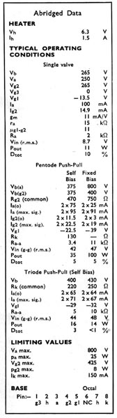

Your idea seems OK, although I have no experience with either the EL3N or the EL12, so I can't comment on their performance. Frankly, if I were you I'd go for something which is a bit more mainstream and for which there are many existing circuit designs. On example would be the EL34 in triode mode, which can be used with a 10k PP load for about 14w output - see attached extract from Mullard's original advert for the EL34.

Triode for El34 PP had 14 watts output must use 10K PP output trans.
There will be same as the El3N, El3n also use 10K PP had 9 watt pentode output.
any good triode El34 PP circuit to reference.
I will build one amp can change different tube for testing performance.
If the input & driver stage were same will be better!!
