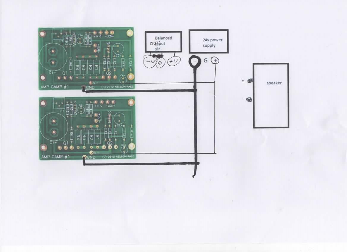

Hi need some help making a bridged pass aca (see attach) although there is plenty of info on bandcamp and it shows step by step if you have purchased the whole kit,i have not !! i have 4 individual pcbs , and lead to beleive you need 2 pcbs per channel ? if that is right can some one link the pcbs,xlr to pcb, pcb to speaker,power supply already done,and send me thanks most appreciated

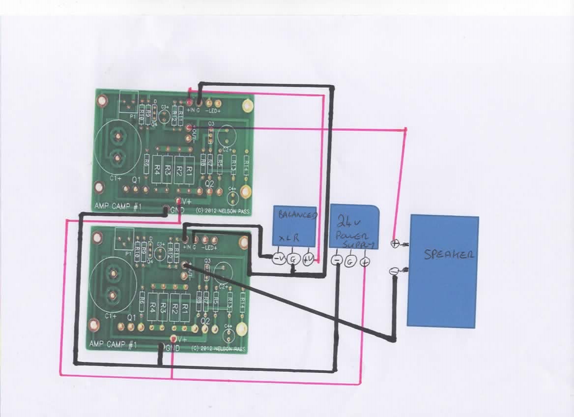

hi thanks mr p for your response !ive had a look at some pics on here, forgive me me for not being too smart with the terminology ,also ive no chassis at the mo , just heatsinks,idid try another way to wire up ( see other attach)but didnt sound great !! if you can just look at new wire up to see if that works ? if ok and also if i need any inline resistors to add ??many thanks
