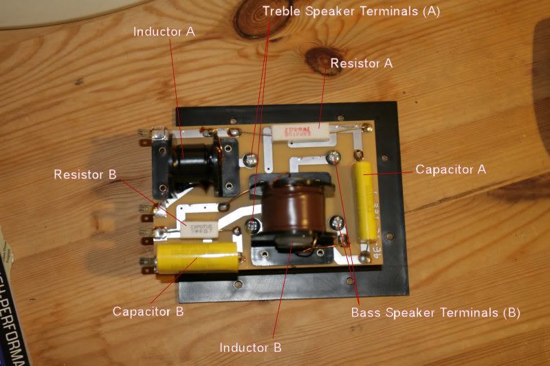

Here is a photo of the crossover (I hope I have identified the components correctly)
Components are labelled as follows:
Inductor A no label
Resistor A Expotus 7W 6.8ohms J
Capacitor A Expotus 4.7J 250V MPP
Inductor B no label
Resistor B Expotus 5W 6ohms J
Capacitor B Expotus 10.0J 250V MPP
Using my multimeter, the resistors appear to measure correctly, but I don't know how to test the caps or the inductors. I would expect to get continuity for the inductors, but don't - is that my meter or something else?
Any and all assistance with working out what's dead would be very much appreciated.

one thing to try is to wire each speaker one by one just directly to the amp to see if you get output (without the crossover) that way you can be certain if it's the crossover or not.
Yes, the inductors should have a resistance of less than perhaps 10 Ohms.
I assume you know that the inductor wire has an enamel insulation, so you can only easily measure from the board foil at the input and output of the inductors. That said, a blown inductor would usually show signs of a lot of heat, and I don't see that.
Caps need a special instrument, but when you connect the ohmmeter you should see a small "kick" of the needle (?) or flicker of the digits as the cap charges very briefly when connecting the meter.
Could there be a fuse tucked away somewhere? If you connect the ohmmeter or a 1.5 Volt battery directly across each driver, do you hear a small click? (Ohms X 1 Scale.)

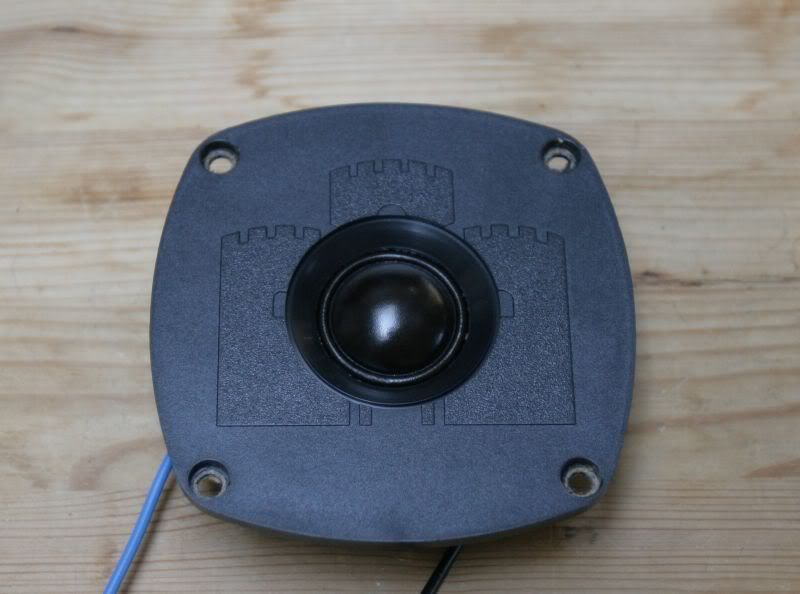

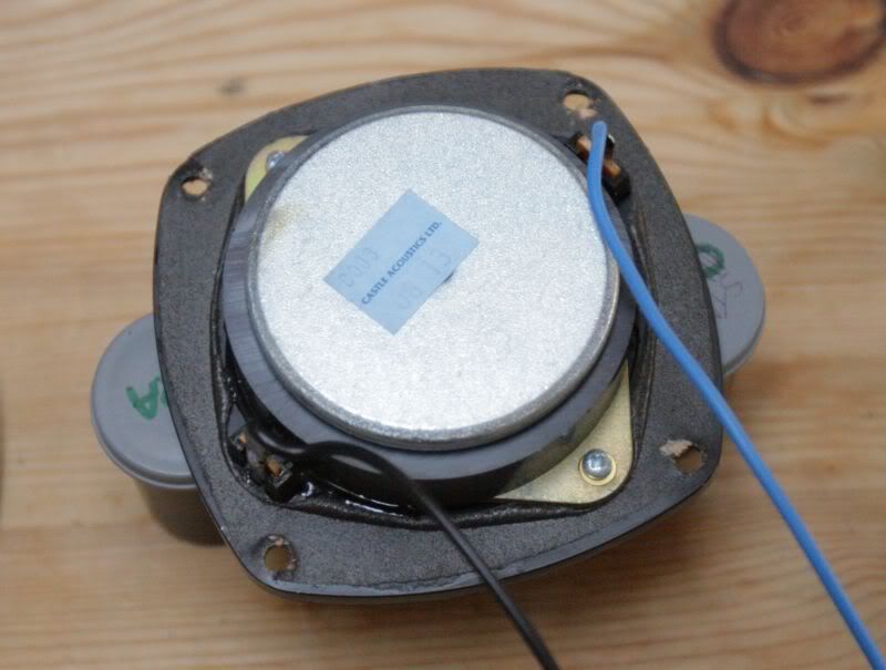

Okay, I've extracted the tweeter from the cabinet:
Front:
Rear:
Nothing really to see - no signs of scorching etc. I get an open circuit across the terms. I am assuming that the delicate wires in the voice coil have probably fried?
What likelihood is there of getting these drivers repaired as opposed to replaced?

jw2k_fr said:Okay, I've extracted the tweeter from the cabinet:
Fried voice coil.

Your crossovers look decent, those are film caps, coils are perpendicular...
You might try to replace the coils with air-core coils (available in any audio parts shop, don't go for super-fancy stuff, just coiled copper wire on a plastic bobbin, lol).
Check the values of course !!!
(LCR meter comes in handy, if you don't have one, the guy from the shop will)
When testing speakers after a change of crossover, use a very low volume (in case you messed up), better now blow another tweet !
As for the capacitors, you may try to replace them too, but don't spend megabucks. Megabucks are better spent on a better source than on silver caps wound by naked geishas.

As an update, I got the first pair of drivers from May audio and found that the woofer was faulty (judging by the packing I am guessing that a damaged unit must have accidentally been put back into stock). They were really good though and shipped me a replacement right away. I soldered them up and all was good - I was totally stoked!
Ironically, I lent the speakers to someone for another wedding and his DJ popped the voice coil in one of the woofers again! So... I will have to order ANOTHER woofer (and I doubt I will lend them out again!)
I have also got myself a decent LCR meter and have found out the following:
Inductor A measures 0.333mH
Inductor B measures 1.84mH
I am having a little trouble measuring the caps as the digital meter I have doesn't really give me an accurate measurement. Any suggestions?
I have browsed parts express and wondered whether anyone would recommend Jantzen 15gauge or the Erse 14gauge coils?
The cost differential isn't much between either option, but wondered if anyone had experience of either or both?
http://www.partsexpress.com/air-core-inductors.cfm
Also, which is likely to make a greater change?
The resistors?
The inductors?
The capacitors?
I know that each crossover is different, just wondered what peoples' opinions were based on their experience?
Thanks again in advance for your help, insight and comments!
I don't think there would be a significant difference between the Jantzen and Ersa coils; choose the ones that most closely match the DC resistances of your current coils.
I would expect the resistor AND capacitor to make a larger difference than the inductors. I'd change both. I've had good luck with the Mills resistors, others with some of the Caddocks. Either will be smoother and better defined than the sand cast cheapies.
Capacitors; well there's been a lot of info available on caps here on these forums; my favorite budget caps, the North Creeks are no longer available, but there's a lot of good info at the humble site.
Humble Cap Reviews
Have you disconnected one end of the cap from the crossover before trying to measure? Sticking with the labeled values, which I believe are 4.7 and 10 uF, should be ok; an exact match to an existing, for example, 4.681 uF won't be necessary; 5% tolerance should be fine.
I guess MPP is Metalyized polypropylene??? If so, the existing caps may be decent.
You might want to consider replacing what appears to be a steel mounting plate with a plastic or aluminum one. I distrust steel/ferrous metals, especially as you are going to air core coils, which have a larger magnetic field coverage volume than cored coils. Ordinary steel (not designed for use in magnetic applications) tends to have hysteresis and nonlinear loss issues.
G'luck, and let us know. 😉
Humble Cap Reviews
About time...
So, it's only been about 20 months since I last posted....
Today I finally decided it was time to get my finger out and get the crossovers upgraded. I have had the parts for about 18 months and singularly failed to do anything with them!
Anyway, I went ahead and desoldered all the old components from the board. I thought about trying to do point-to-point wiring, but I didn't want to risk making a mistake. I ended up soldering everything back onto the same boards.
I was extremely nervous as I hit play and turned the volume up from zero....... and it works!!!! I M geeneeyus! Ahem... well not quite, but I am sure some of you can remember your first upgrade 😉
First impression was that they sound the same (okay so nothing is run in yet), but I take that as a good thing - I didn't appear to make a mistake in matching components. After half an hour, it would seem that the new one is a little louder and a measure less veiled than the old one. It remains to be seen how things unfold over the next few months.
I will take pictures of the old and new components and my ghetto crossovers later today 🙂 (I have little bubblewrap pads supporting the inductors 😛)
Thanks again to everyone who responded. I am pretty stoked - it was fun to do and I like the result. What else can you ask for?
