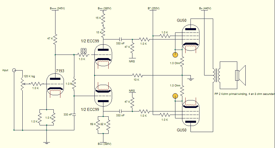

i added the schematic for my amp
Don't look at the weird tubes. The output tubes can be any good output tube. it was designed for 6550/kt88 tubes
The phase splitter is much more descent. If you make a ccs in the "tail" (replace the 10k resistor with a mosfet ccs) it will be even better!
