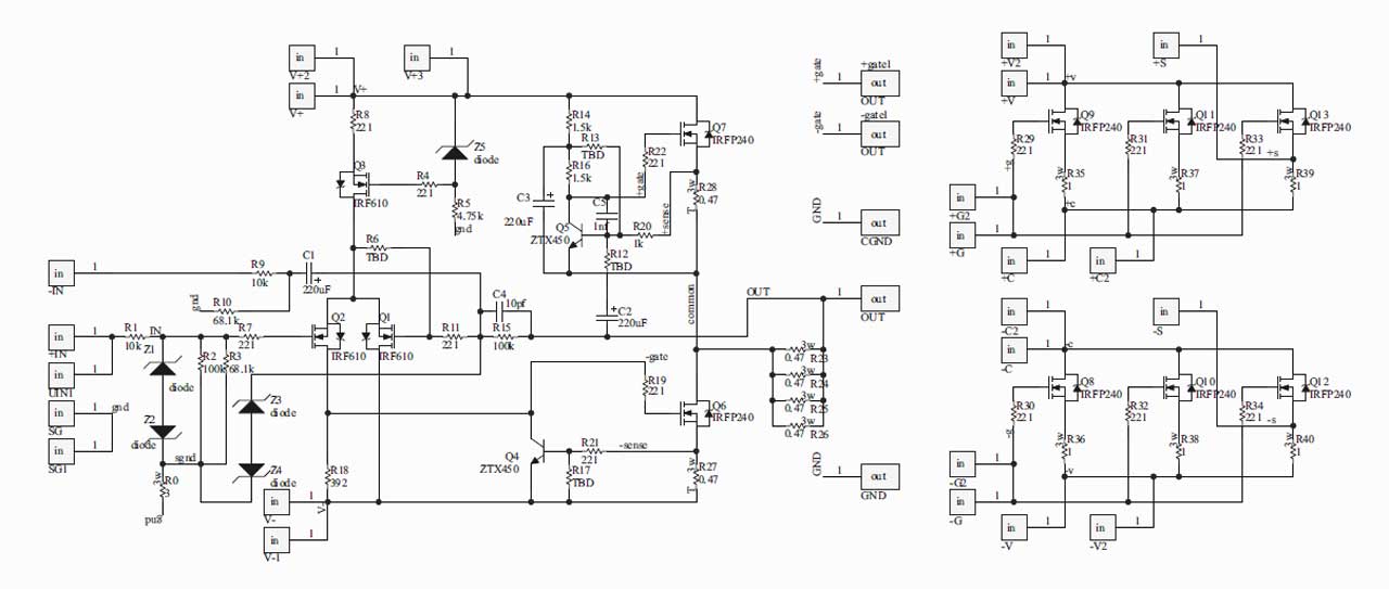

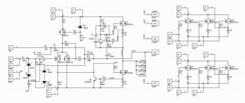

I have attached the schematic of the boards I have used.

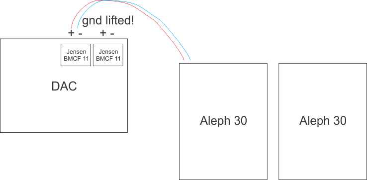

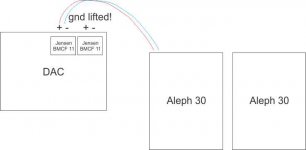

Yes I did try it with other source. I have connected it and even without powering up the source the humm and buzz is present... That source on the balanced out has Jensen trafos also gnd lifted...

I'm sorry, references to other projects is not very helpful. Your implementation is directly connected to your problem so make a detailed drawing of your arrangement so we can help you find your error. I realise that there is a slight language barrier, and it would help troubleshooting greatly.

Problem started with legato3 without caps on output. Cos there is 4-7mV of DC. Can that damage IRF610 on input?
Voltages that I measure referred to gnd:
Q1 S-3,8v
D-22,8v
G-0,33v and falling
Q2 S-3,8v
D-18v
G-0v
Q3 S-18v
D-3,8v
G-13,8v
Question is on C1(220uF 35v) on -in input, too... After amp shut down, dc on speaker terminals is same as on cap..about 3,5v dc and it fall slowly.
Q1 S-3,8v
D-22,8v
G-0,33v and falling
Q2 S-3,8v
D-18v
G-0v
Q3 S-18v
D-3,8v
G-13,8v

That's a very curious schematic, Q1-3 should be IRF9610. That makes your voltage readings incoherent.

all measurement points seems fine
current through LTP is ~20mA , if zenner is 9V1 it seems fine too .
problem is - your amps are mono blocks , so it is hard to say what can go south in same time on both amps ?!?
legato's few mV can do any harm , too - and even if some powering up/down spike exists ....... according to measurements - there is no any damage done
did you tried different XLR cables ?
it still seems that most possible culprit is in last change you made in system ;
something is wrong connected
Tried different cables , different source... exactly 3 different sources, also my AYAII which uses Jansen trafos for balanced out...
insert 10 ohm resistor in sources of Q1 and Q2 , then measure voltage across these resistors
it must be equal , in 10%
