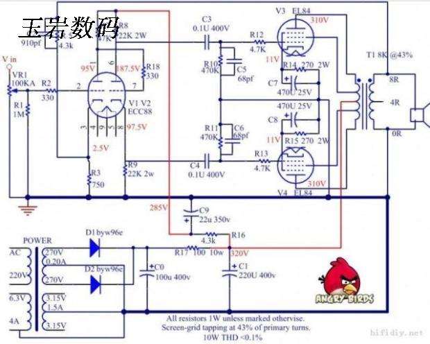

I am at my wits end and its eating me. So I built a new version of my old amp, fancier chassis, better OPTs. And its working great. But I took the old amp (that has been working flawlessly for five years) in to my workspace and thought I wanted to play a little with it. Tube rolling for one. Put some 6n6p in place of e88cc AND somewhere along the way - moving from the living room to my working room (not calling it a workshop, cause it isnt) and putting new tubes in it something has happened. Only one channel is playing. Playing fine, no hum, no hiss and the other channel is just dead. Tubes light up fine on both sides. Anyway, its not that I need the amp anymore but I figured it could be some training to get it running so I have changed the entire PCB (I have several) newly populated, only thing I had to move from the old one was the coupling capacitors. Same thing. Changed the input RCAs. Changed to another set of OPTs. Changed back to the old ones. Same, same, same. One channel is dead AND I have 80v AC in/on? the chassis and I can not see where that is coming from. I just cant understand. Anybody get any ideas what I should check. BTW I do not have any fancy instruments. Only a universal meter.
So the schematic is this but triode strapped and no feedback. On PCB and one channel works perfect as did it with the original board.

Both speakers are OK, I have checked. But as I said the + side of the dead channel has contact with chassis. And filaments are sort of on the schematic. 3.15x2 center-tapped goes to the two e88cc and 6.3 w/ 0 grounded to the 4 el84. there is a star ground point on the PCB and that is the connected to the chassis. ( and a ground on the primary side. ) Im gonna change speaker jack in the morning and see what happends.
Hello from Greece! It is important to check your power transfomer! Maybe you have leak between bobbins of your power transformer,and lamination which is grounded! Your amplifier is grounded or not? Never use electric or electronic device with metal chassis with out properly ground! Safety first!!
OK, so this is spooky. I bypassed the speaker binding posts. I.e. I removed them and connected the cables directly. NOW the other channel is the only one working. ( and yes I know left from right and a did swap speakers back and forth ) Now I dont believe in the supernatural so there has to be an explanation but so far Im at loss for hypotheses. AND still 80VAC on the chassis.
So, it turns out one of the 6n6p is faulty. I figured Ill check by swapping the tubes from one channel to the other, but I figured maybe one of the output tubes. But it one of the others. I do have a couple of tubes more so Ill get it running and check the AC on the chassis again. The grounding should be fine and as I said no AC with the tubes out.
