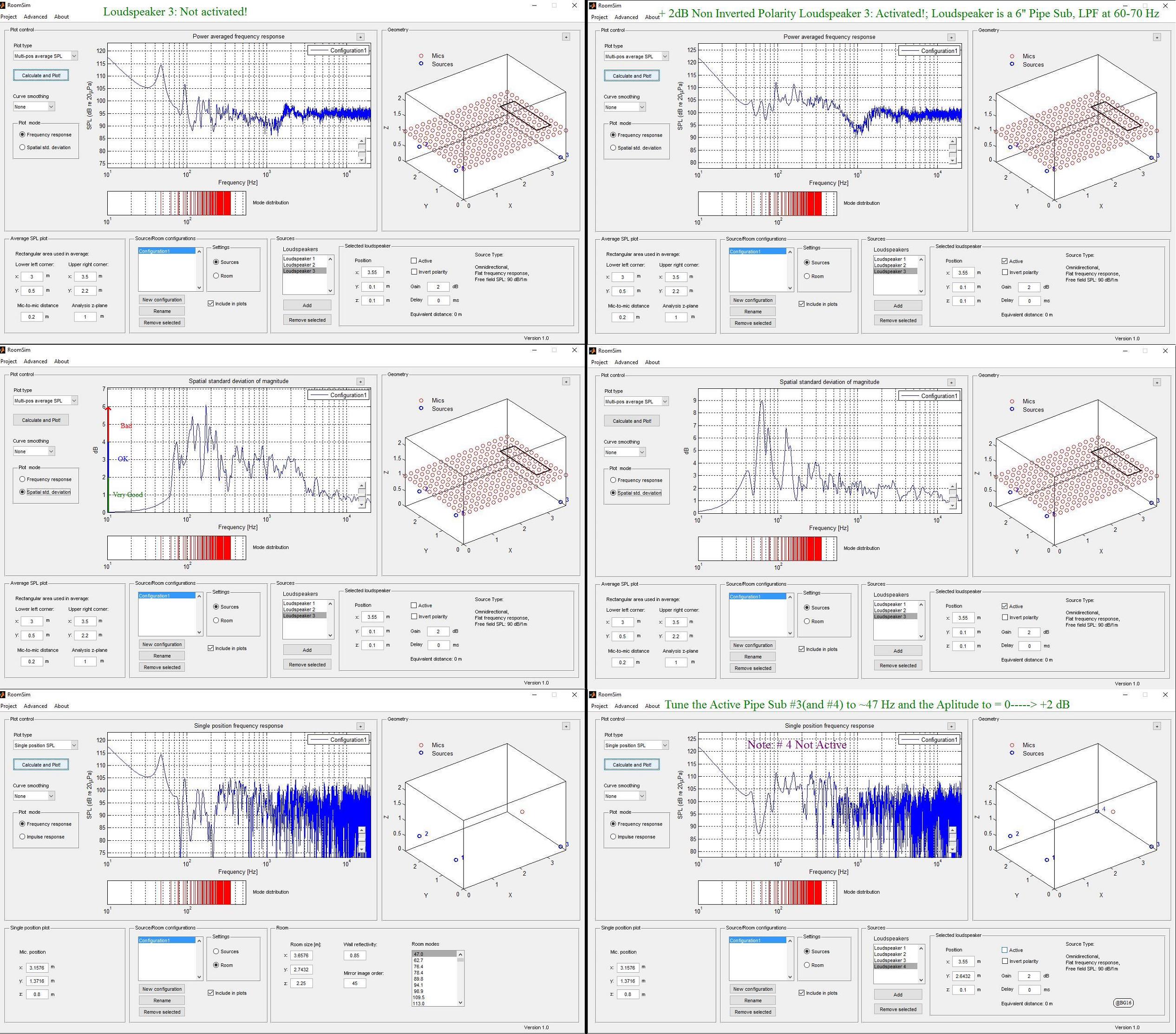

Hi GM,
I have a 45hz mode in my room due to the room length.
Also So it is a rather narrow bandwidth and high Q peak. How small can the pipe be? Is 4in diameter, or 4x4in square x 48in long sufficient? What is a good starting approximation for port size and length?
How many tubes do I need? It's a rather small room, 9x12 feet.
I'm already using quite a number of broadband rockwool traps, so I am only looking to target the 45hz with this MLTL absorber.
Thanks!!

Hi All,
FYI; Forget Passive Traps..IMO:Use instead One or Two Active Traps, i.e. an inexpensive 6.5" Driver in a TL-Tube ~LPF cut of at 60-70Hz , Mass-loaded or not to remove the unwanted BW. Terminus or port as near as 0.5 x Pi as possible.
b🙂

Hi Bjorno, thanks for the response and info.
Can I get a bit of clarification :
1. The 6.5in woofer in TL, tuned to 47hz. How do I drive the woofer, and what to feed into its input?
2. Is it an active bass absorber, or is it multi sub approach to even out the room modes- geddes style? I'm a bit confused after studying the attachment sims.
3. Maybe if you could explain the sims, that would help.
Thanks again!
