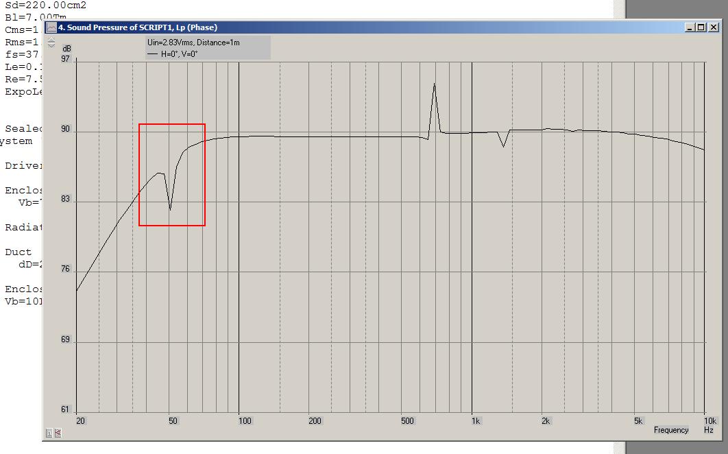

... There is pretty good probability that the Akabak software is able to simulate such system, only that someone more knowledgeable than me must get interested and write the code. 🙂 ...
Try this:
Code:
Def_Driver 'Driver'
Sd=220.00cm2
Bl=7.00Tm
Cms=1.00E-03m/N
Rms=1.00Ns/m
fs=37.6374Hz |Mmd = 16.00g not recognised by AkAbak, fs calculated and used instead
Le=0.10mH
Re=7.50ohm
ExpoLe=1
| Sealed enclosure with an internal Helmholtz resonator tuned to the system's Fs.
System 'S1'
Driver 'D1' Def='Driver' Node=1=0=2=3
Enclosure 'E1' Node=2
Vb=77L Lb=25cm
Radiator 'Rad1' Def='D1' Node=3
Duct 'Du1' Node=2=4
dD=2cm Len=4cm
Enclosure 'E2' Node=4
Vb=10L Lb=10cm
Note that the resonator and its port are impractically sized - this is a proof of concept only.
Thanks for that! If the effect of the resonator is the dip encircled in red on the simulation, then it works! 🙂 🙂 🙂

The only suspicion I had, was why the dip has such small extent, I would expect something like half octave at least. For instance if Fb is 50 Hz, then it should be between 37.5 and 75 Hz.
