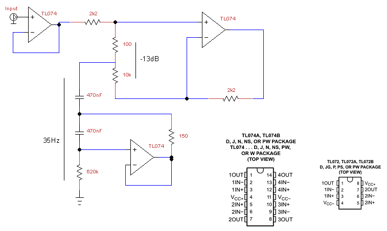

You can resolve this with a very simple notch filter (band stop) based on opamp gyrator topology, if you like to play with opamps.Would a Helmholtz resonator work for removing a 10dB resonant peak at 40Hz? My room is 13' x 15'.

I made one for my listening room, where I had a strong resonance at 35Hz that would be difficult to absorb and it was very effective.
On top of that, I have a 31-band EQ for other minor adjusts.
I know a DSP can do all this automatically, but I like to do it myself with analog electronics.
1xTL074 + 1xTL072 (3 opamps per channel)

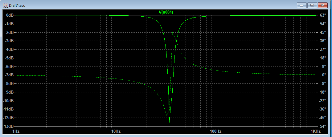

LTSpice FR
+1 on the notch filter... I struggled getting my Sub to integrate with the system, until I measured the in room response, and found the nasty room peak that was the source of the problems. A similar mono notch filter, in line with the sub, cured it, and made the system sound much more balanced.
