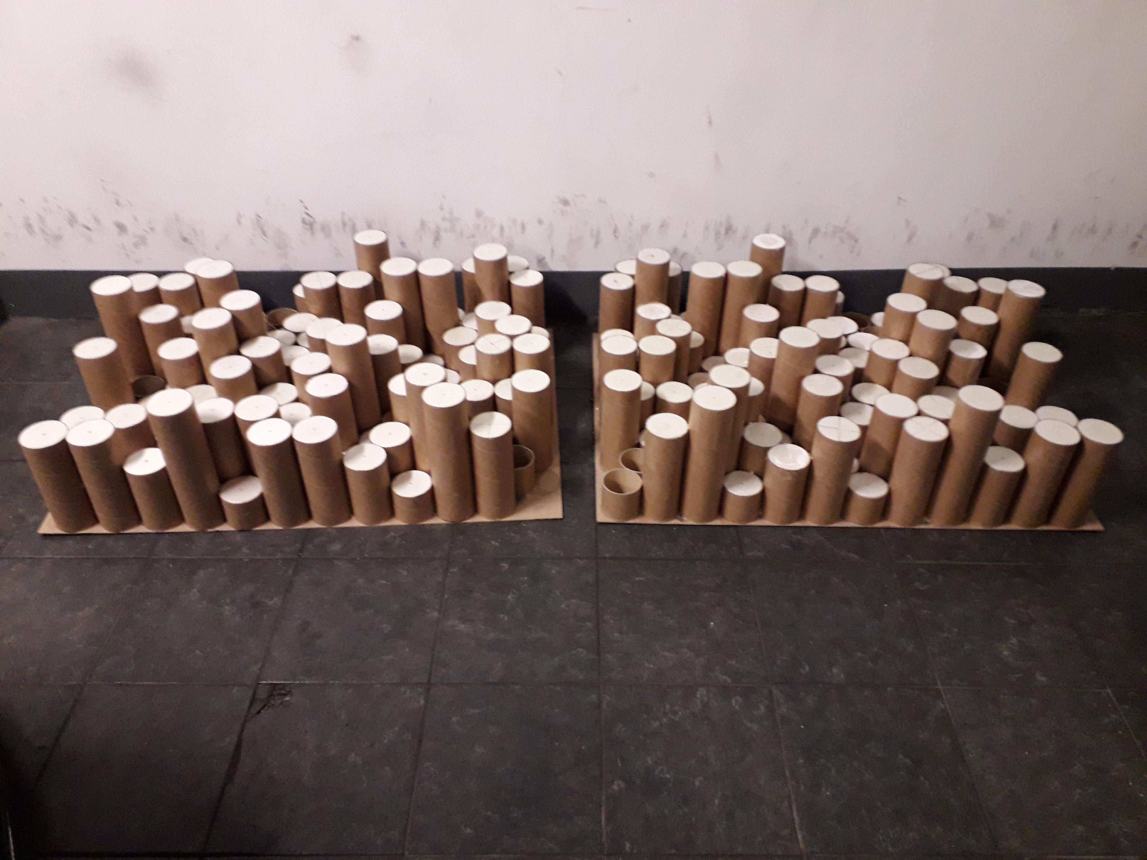

I would like to use the elements of a skyline diffuser i'm building as Helmholtz's absorbers to kick off the modal resonances of a little listening room.
Both have a narrow bandwidth and it is not possible to couple them by models (IMMO).
So I have to misure.
How?
Hitting the cavity by tapping? ... blowing in the hole :note::note: ? ... noise?

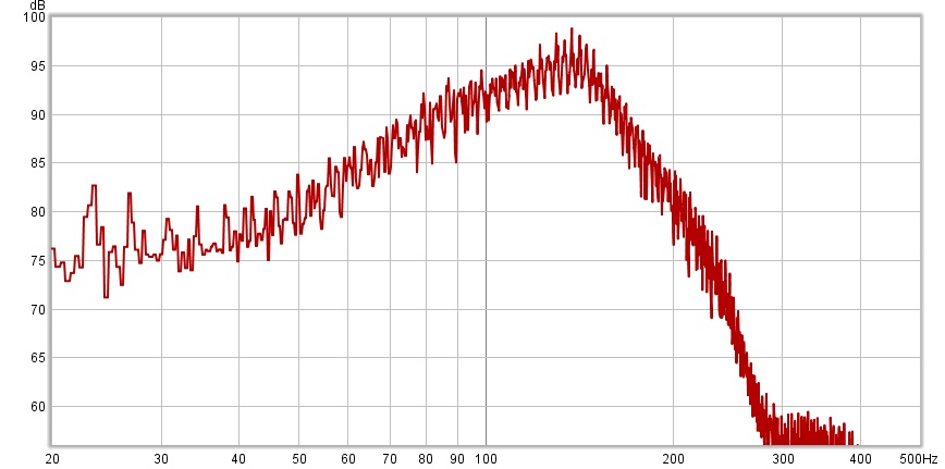

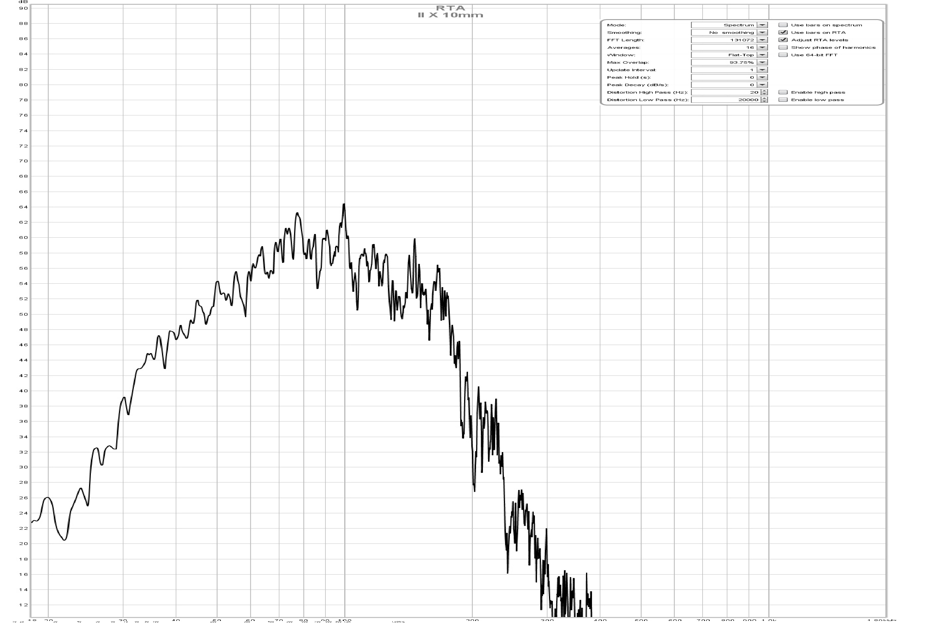

For the larger element, the original formula predicts the resonance at 140 Hz, and I see (empty cavity, mic in the cavity),
For the smaller resonator the formula predicts, 205 Hz and I see, tapping, blowing and using pink noise...
But now I think that the predictions of the formula are more accurate than my measurement and more precise than the holes I have drilled.

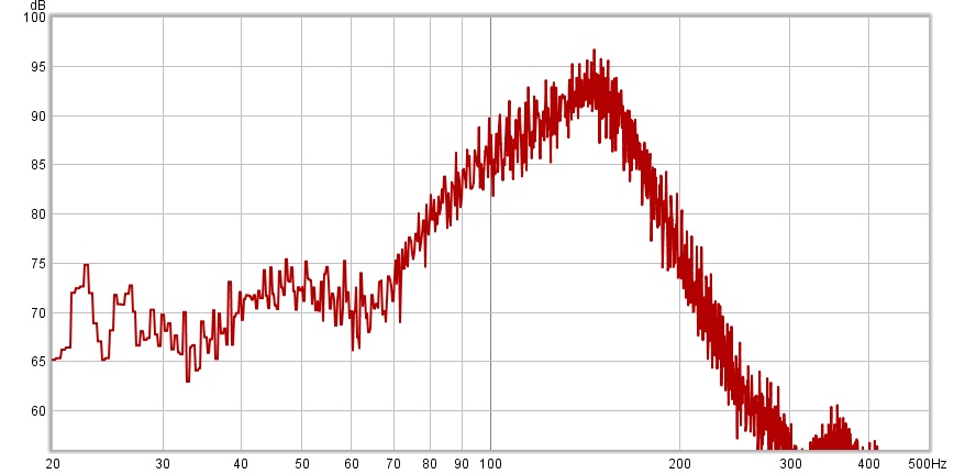

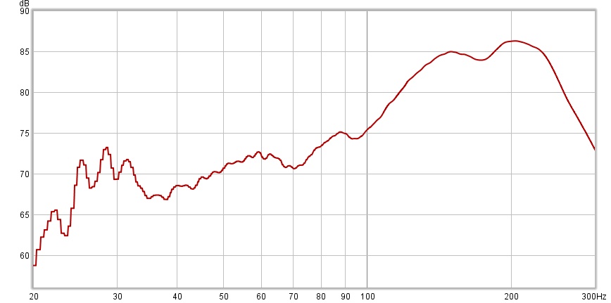

The prediction says 132 Hz for the element 15cm long.
My measurements say 147 Hz by tapping, blowing, or noising the empty resonator.
Maybe not rigid walls? Not sealed cavity? Dimensional error of the hole?
With the cavity losely filled with acrilic adsorber, I see 136Hz, and a larger chart.
They say that an Helmholtz resonator draws energy from the sound field, and partly dissipates it. Good
Partially it returns energy into the room, with a different phase. Good.
For a period of time that may be too long, damaging the decay. Not good.
Is there an empirical rule to handle this?

Nice experimentation!
As you have already noticed, stuffing the tubes with an absorbing material lower the tuning frequency but also gives a lower Q, meaning a lower peak in absorption, but more spread, which in some cases is a better option.
Try painting the tubes with some hardening resin, it should help you better match the predictions from the simulation.

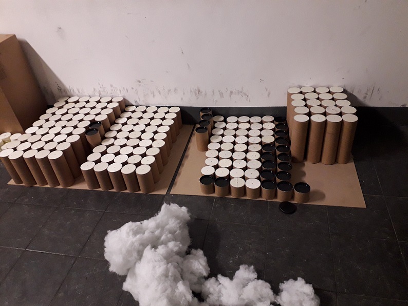

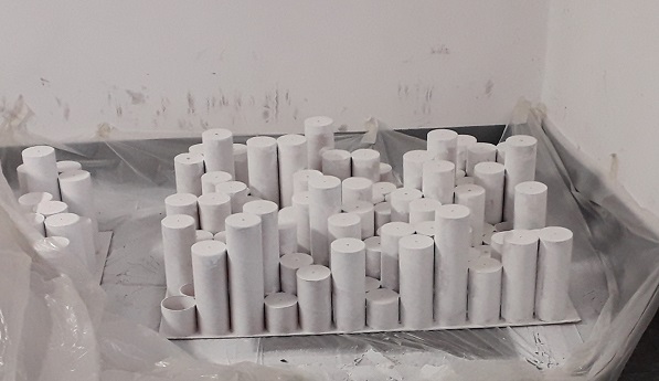

Painted.
The finish is not suitable for a living room. Perhaps an elastic and tight fabric could show its beautiful shapes and hide defects.

You can't put elastic or fabric across the front. it will interfere with how the resonator/diffuser works if I remember my physics right. Fabric can be put over plain absorbers.

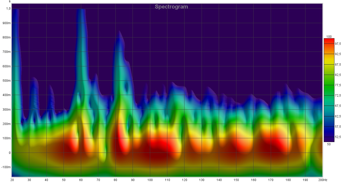

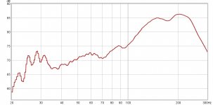

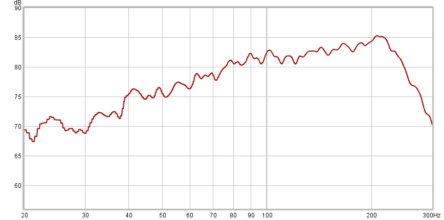

Looking at the spectrogram in the destination room.
The elongation at 22 Hz is the adjacent bedroom. It disappears closing the door: normally the system cannot reproduce below 30Hz. I would like working at 62 and 82 Hz ...
Did you do any before/after measurements?
Those would help pinpoint at what frequencies your resinators are working.
A waterfall decay rate graph will also be very useful at this stage.
