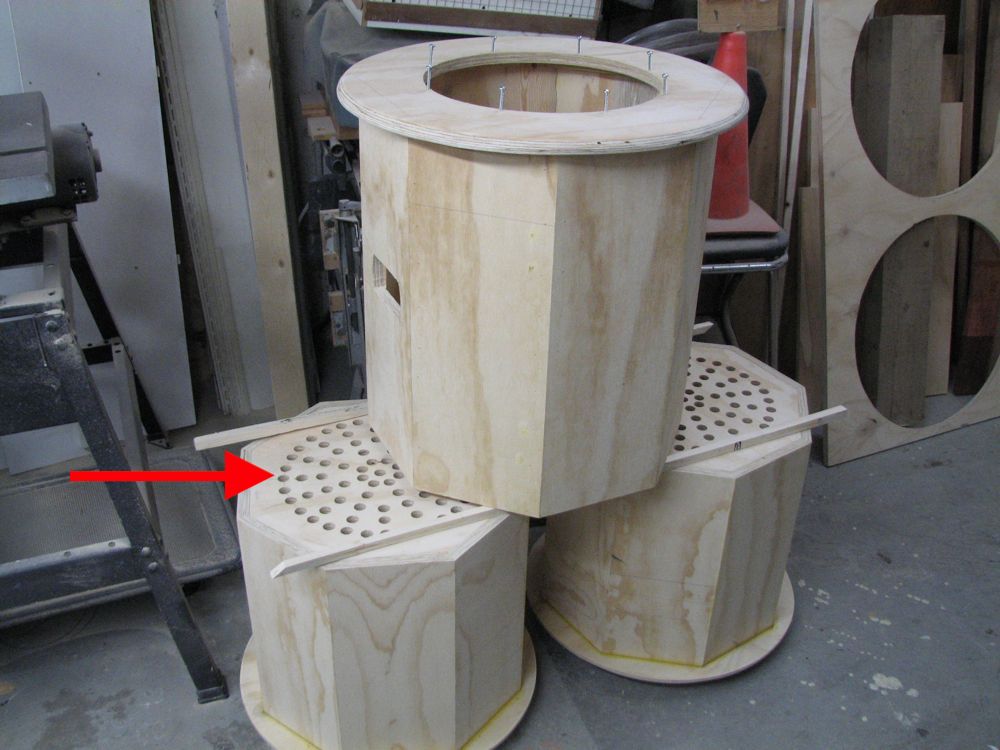

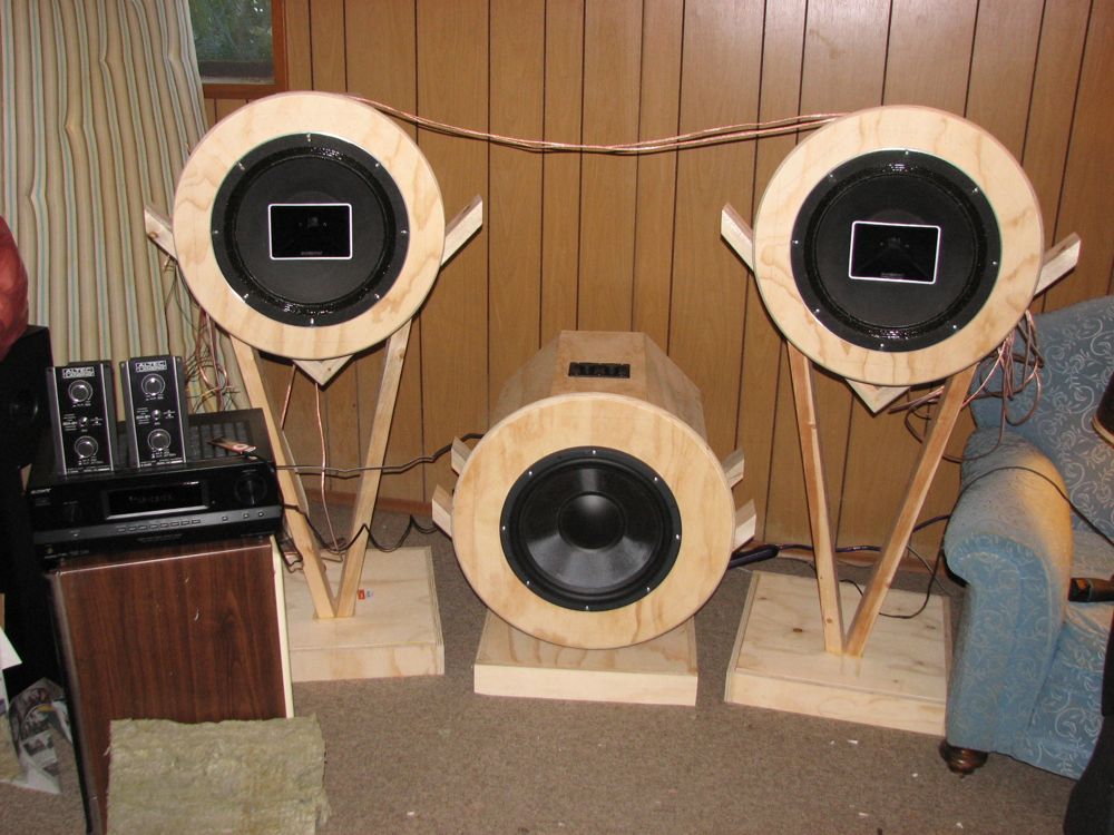

If it were me I would do the 416 in an Onken style as the bottom part of the cabinet and maybe a little fooling around with the 'airiness' of the 604 by poking some holes in the back like in the first pic. Mine, as you see it, has the CSS woofer for support and it is active. Consider going active with your system as well. The cost of passive parts hardly makes sense and active gives you that much better control. I cut the 604's off at about 100 Hz.
