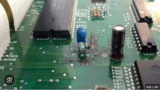

The gunge on the board is just just glue to secure the caps, are you sure they are actually faulty?

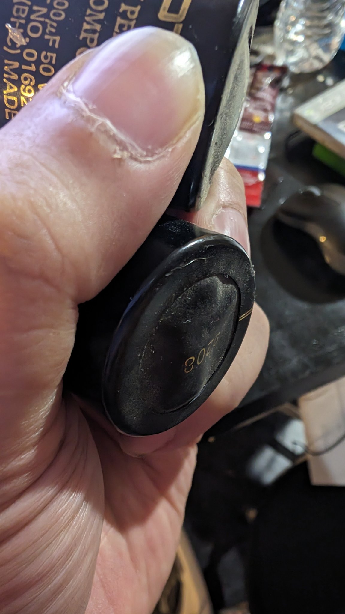

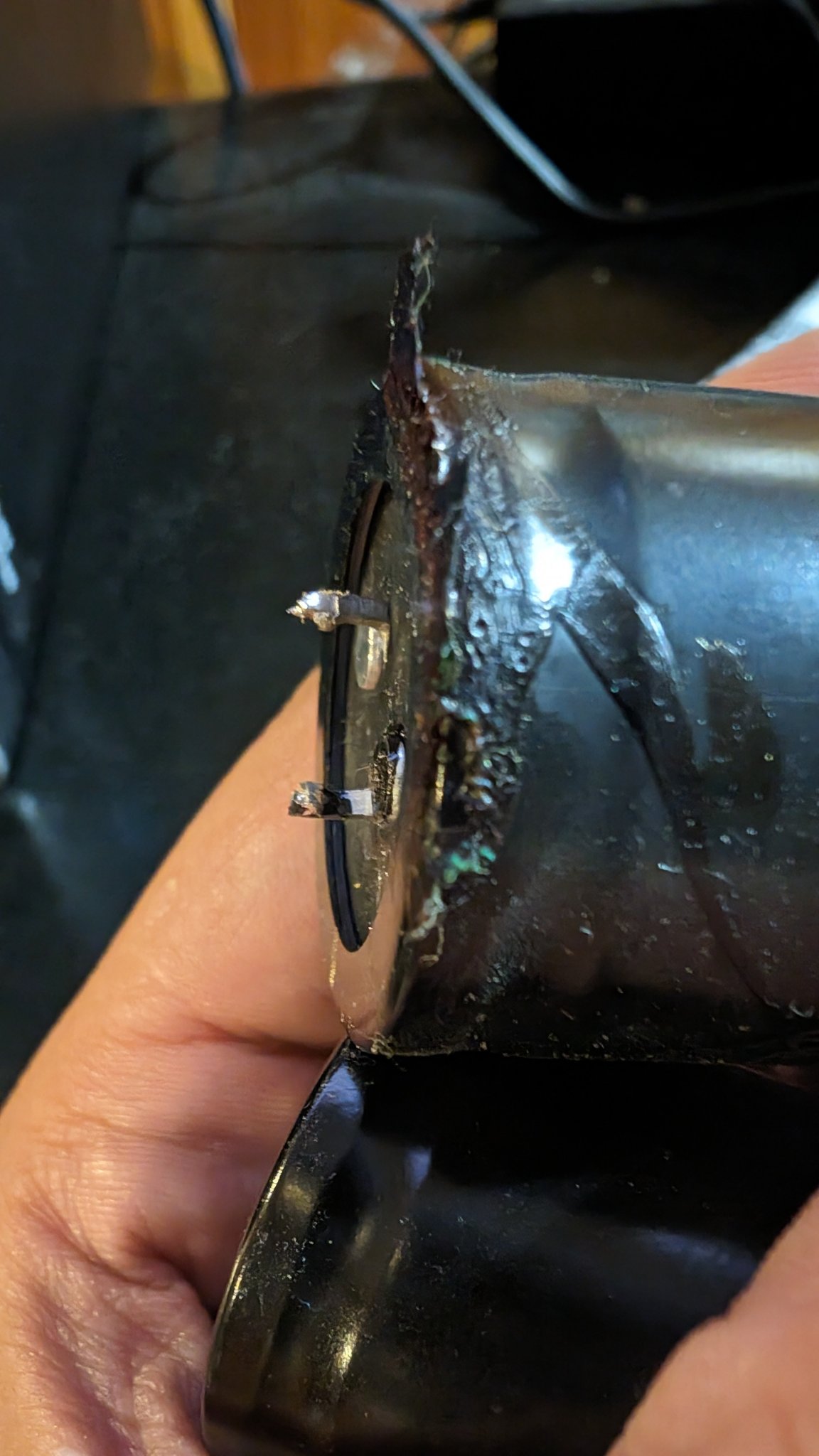

Thanks! definitely not glue, it's fragile and crackly, and I can see the black juice coming from 1 of the caps. Thank you for the info tho! there are just so many choices, I was hoping someone could recommend a specific one.
That really really really 🙂 sounds like glue. What I see in the pictures I would say is glue. If there is actual 'wet' electrolyte leaking from a cap then that is a problem but usually leaky electrolyte dries whitish and flaky.
I think thats the horrid yellow glue that becomes brown/black and conductive with age though, better to carefully strip it off the PCB in case it deteriorates. The cap's datecode is 1992 so they are probably good for a while - though if the unit's open its worth checking their state - new one's would be good for a long while...
Since you've removed them, might as well replace them if you can find suitable parts, even if they are still good.
