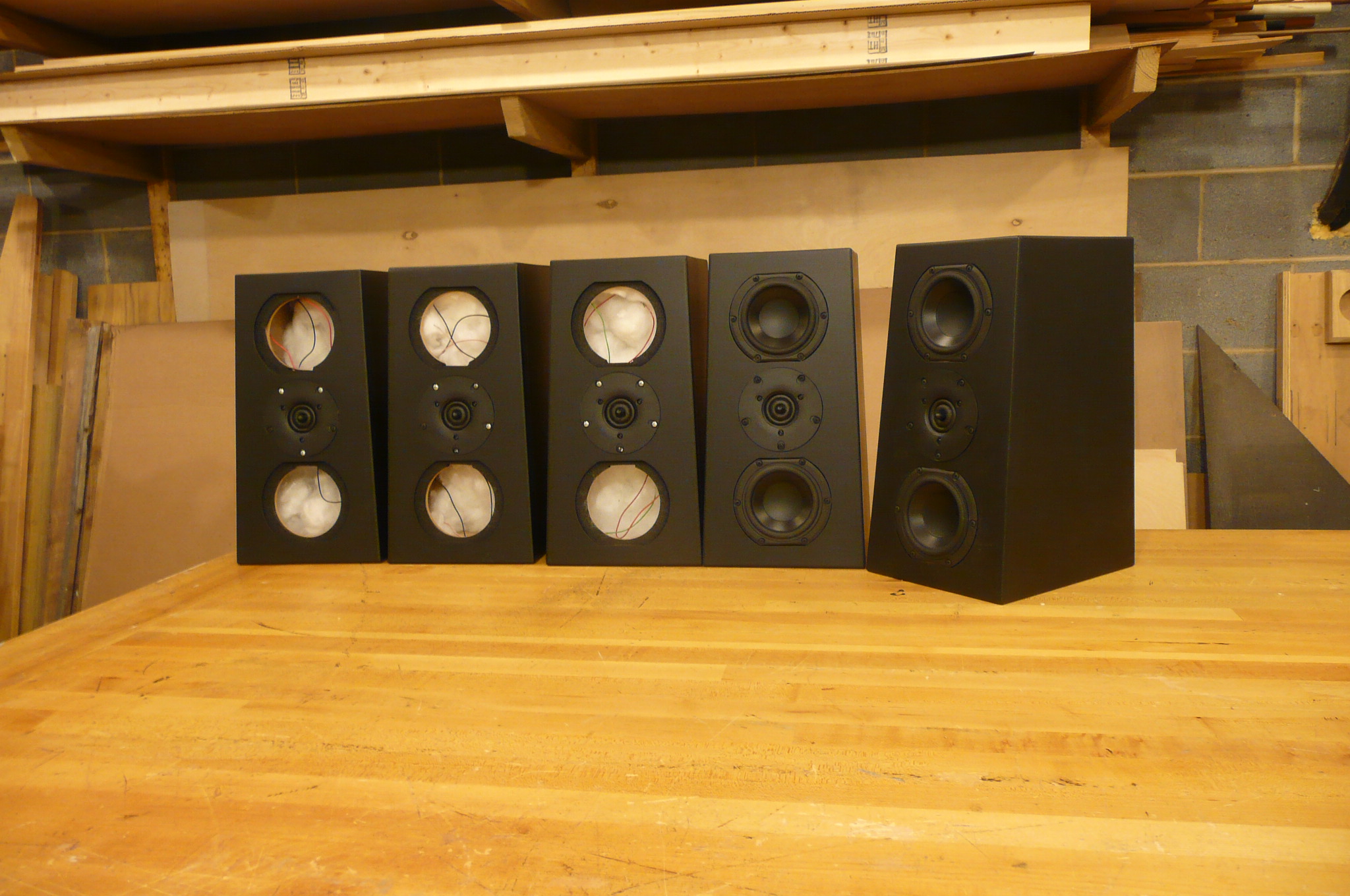

You want a high performance speaker for less? These are top notch. I did also post a thread in Multi – way HDS kits. Kit comes with tweeter, 2 woofers and impressive crossover (pre built). The fellows at Madisound did a nice job blending the cross over point.
http://www.madisoundspeakerstore.com/mtm-speaker-kits/hds-home-theater-kit-parts-only/
Pic of cabinets that I built used.
