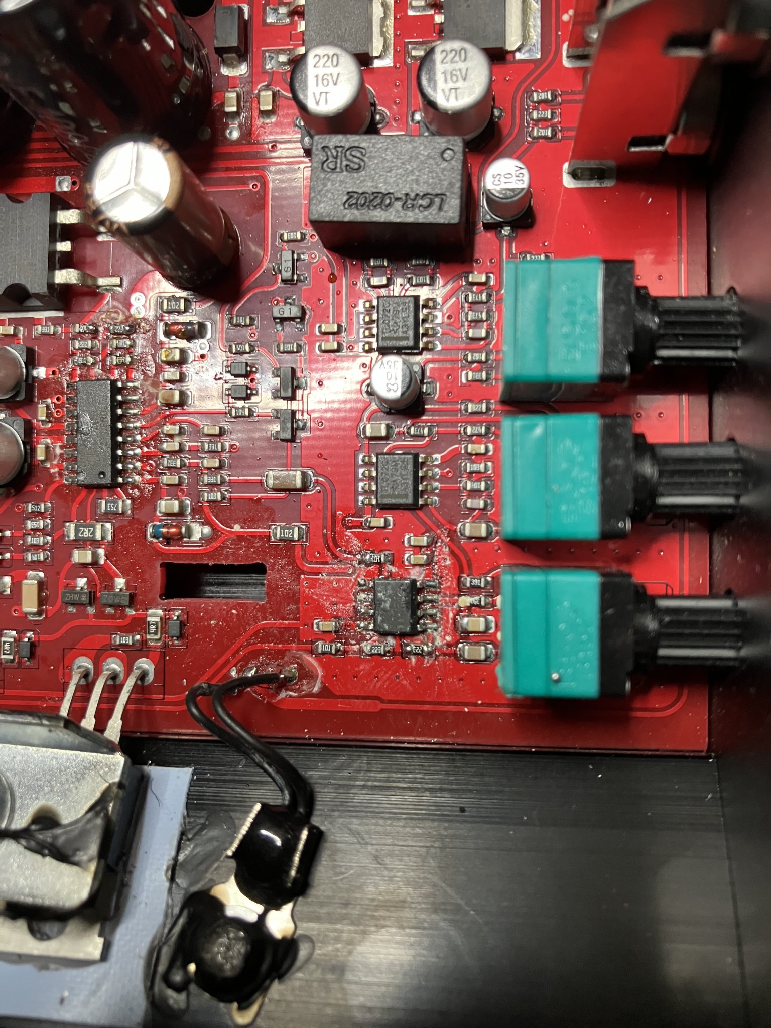

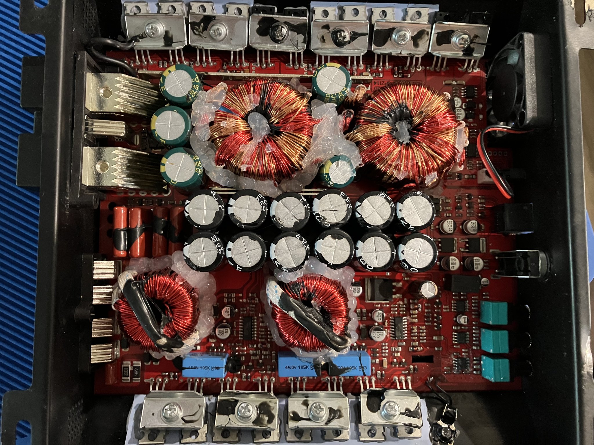

My name is Patrick, I live in Des Moines, IA. I’m originally from Grand Rapids, MN. I’m trying to get into repairing car amplifiers, and am attempting some repairs, have set up a bench testing station and repair station in my house. I’m excited to talk with people here, and really looking forward to learning some things from you guys who are experienced in this field. Does anyone know a good site to use for schematic diagrams by chance? I’m having a tough time finding a schematic for a Sundown Audio SAE-1500D v3. It flashes protection light when powered up. It looks like it has a burned diode (Marking says S30) on the 12v Offset Protection Circuit. I included a picture, in case anyone can confirm that this is indeed what I’m looking at? I got this amp off EBay to repair and to start learning the trade better.

If that diode connects between the B+ and ground, it's a Reverse Protection (RP) diode and someone likely connected it with reverse polarity.
Remove it and measure the resistance between the B+ and ground and post what you read.

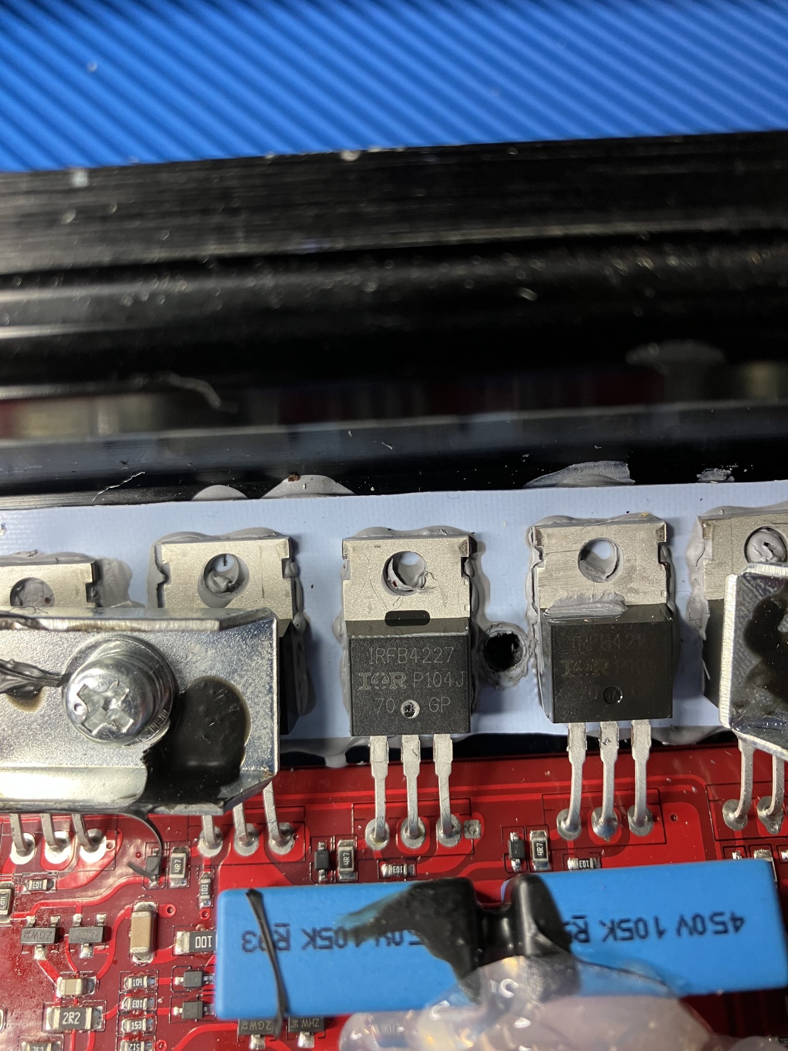

What are the part numbers on the face of the PS and output FETs?
Are any of the output FETs shorted?

That is indeed a reverse polarity protection diode as Perry pointed out.

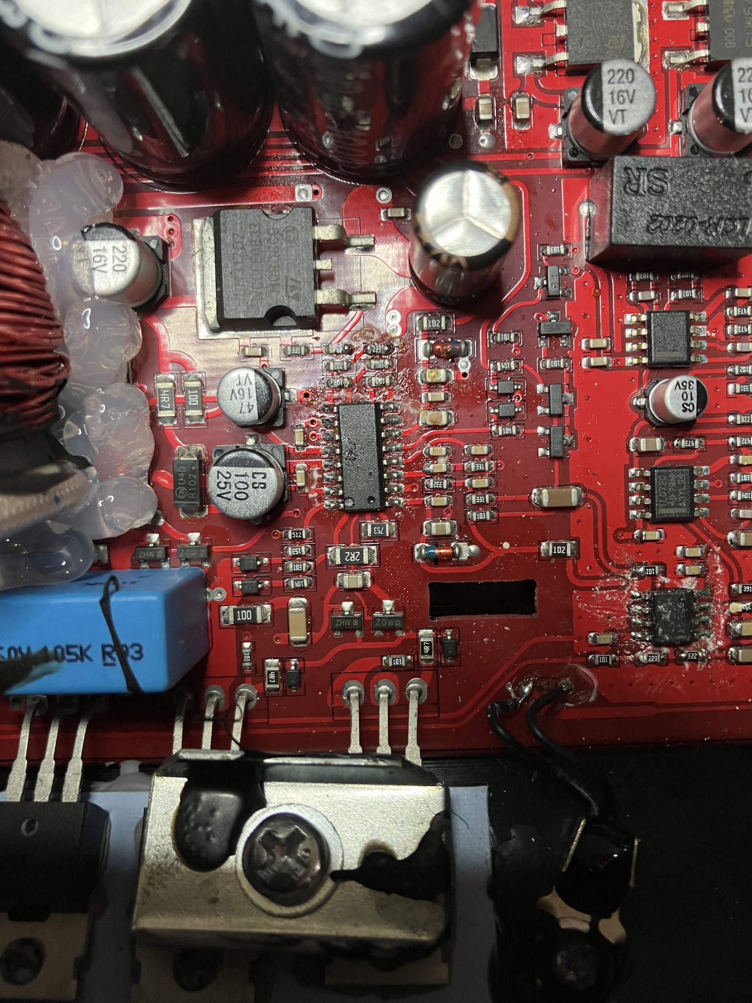

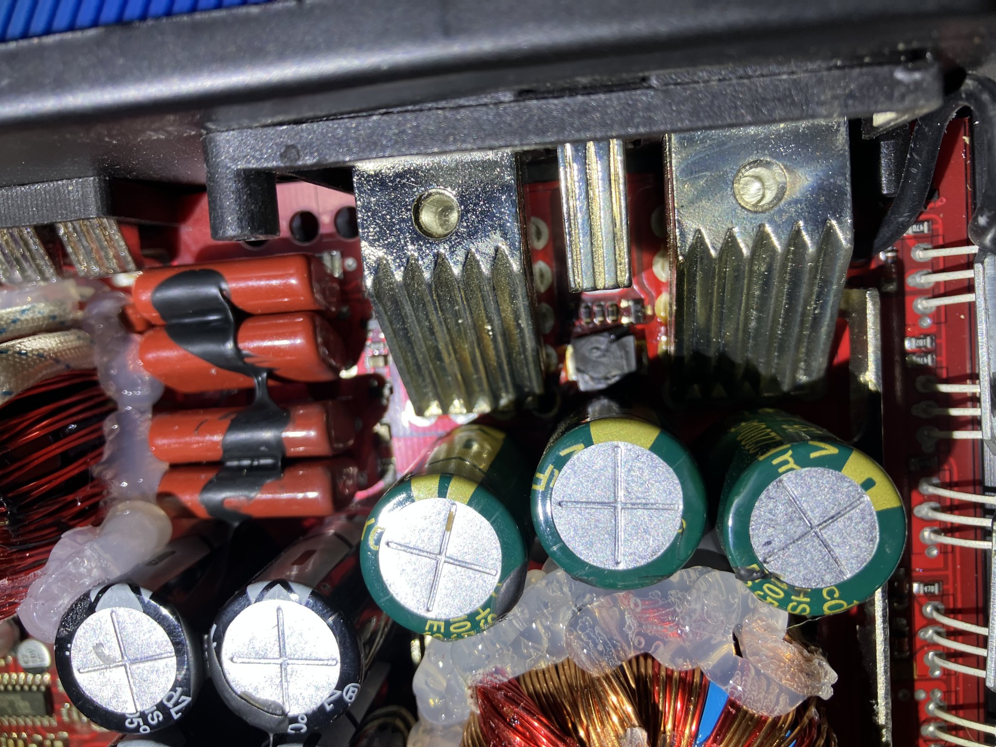

It's not clear from the picture but it looks like one of the output drive ICs is also damaged. (16 pin IC near the potentiometers.)

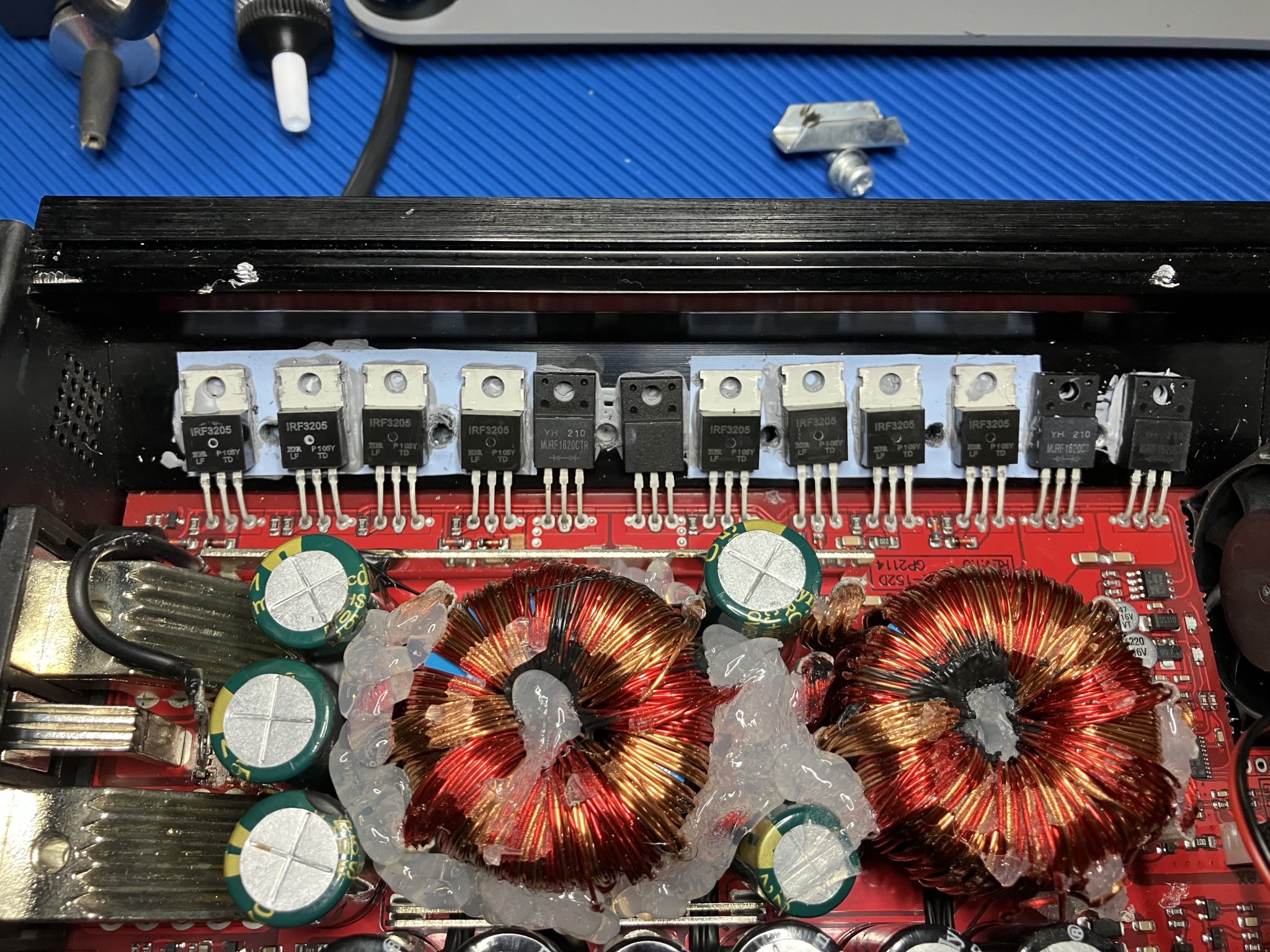

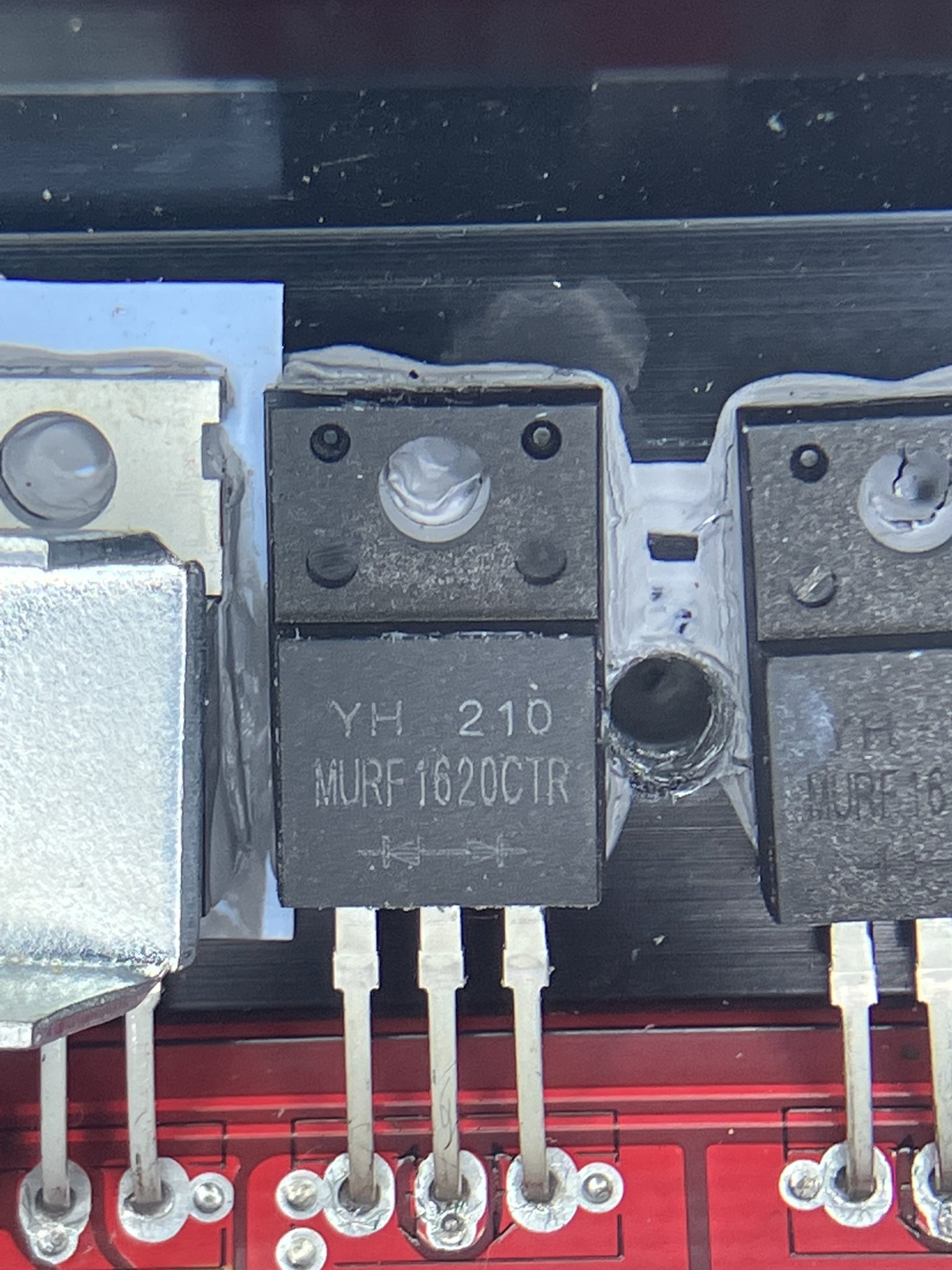

I included a picture from the PS FETs (first picture), and the output FETs (second picture).
I think the PS FETs are good, but I’m not 100% sure I tested it right. I’ve watched many videos, but they are all testing FETs out of circuit. Does it matter whether I am testing them in or out of circuit? Will I get the same results?

The reason that I wanted to know if the output FETs were defaced is because that would make a reliable repair more difficult.
The PS FETs aren't in the photos. The first photo is the rectifiers. They should have read 0 ohms across the outer terminals.
You will get different readings in and out of the circuit but when FETs fail, they commonly read 0 ohms and that can't be mistaken with something on the board skewing the readings.
I don't know what the remote should read but it's not shorted so that's good. The same thing applies to the PS FETs.

I’m not getting any shorted pins on the power FETs I don’t think. None of the pins read 0 ohms.
The last two pics are in response to the comment from the other gentleman about what he saw by the potentiometers, it looks like some kind of residue to me. But idk. Definitely don’t know how to test these.

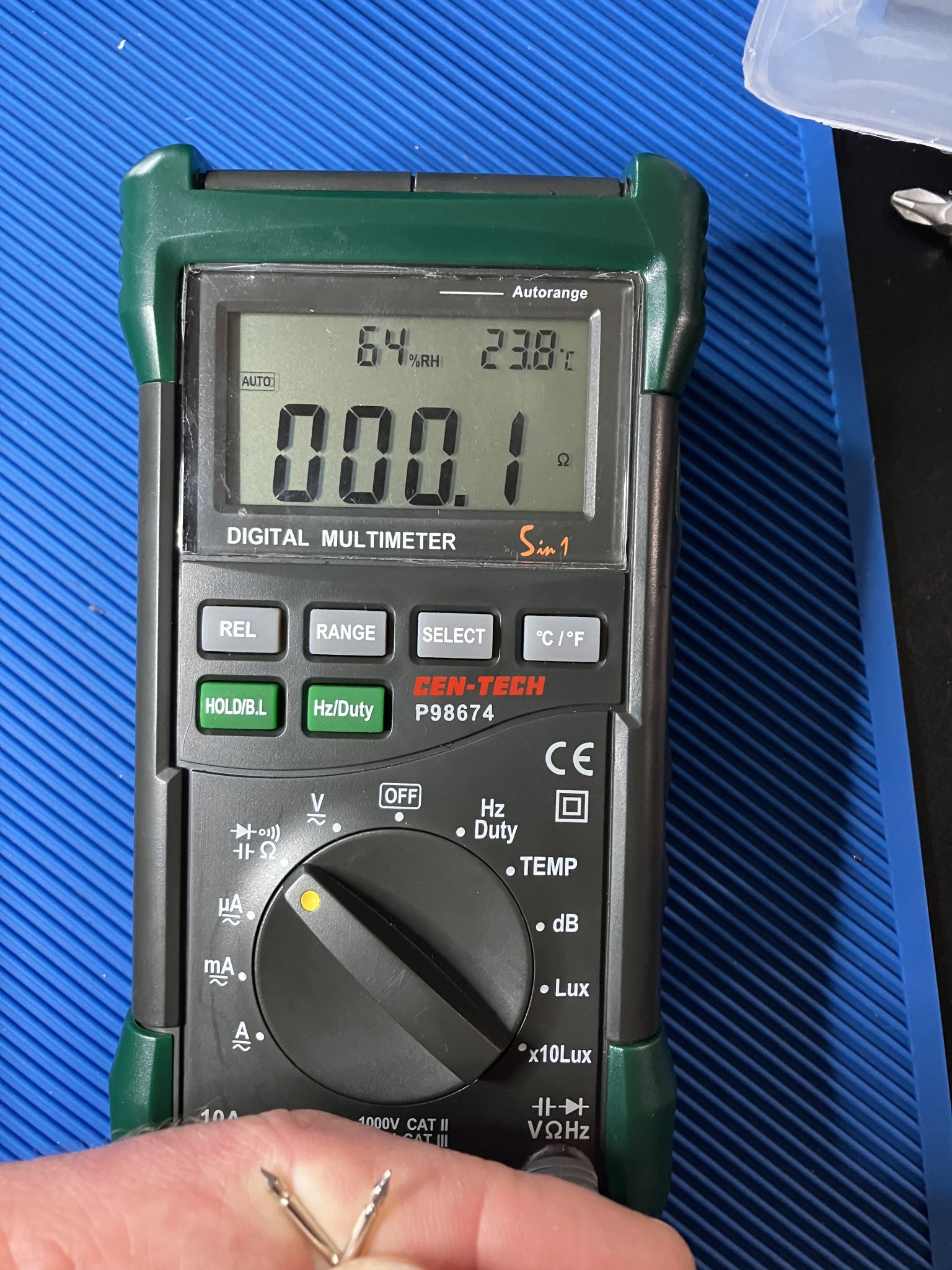

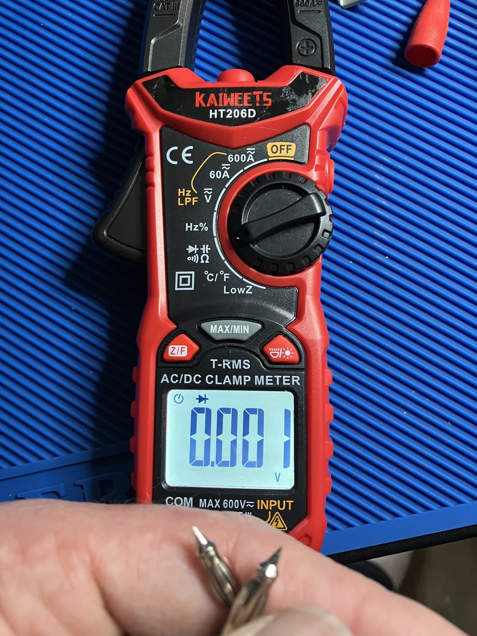

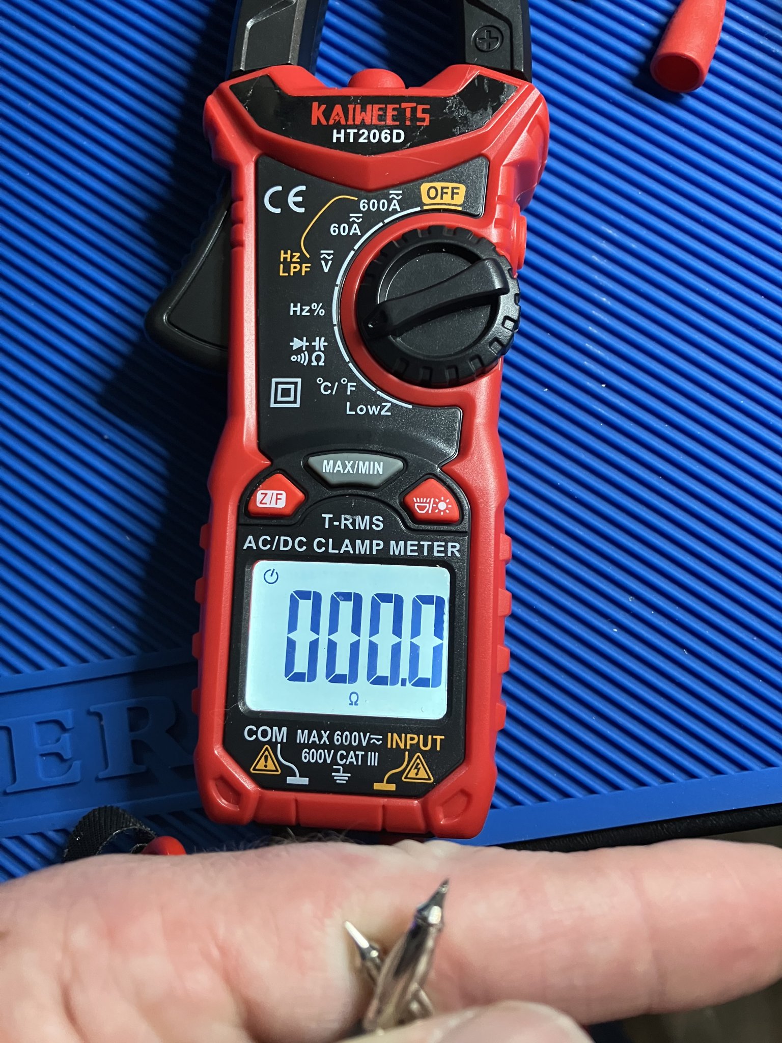

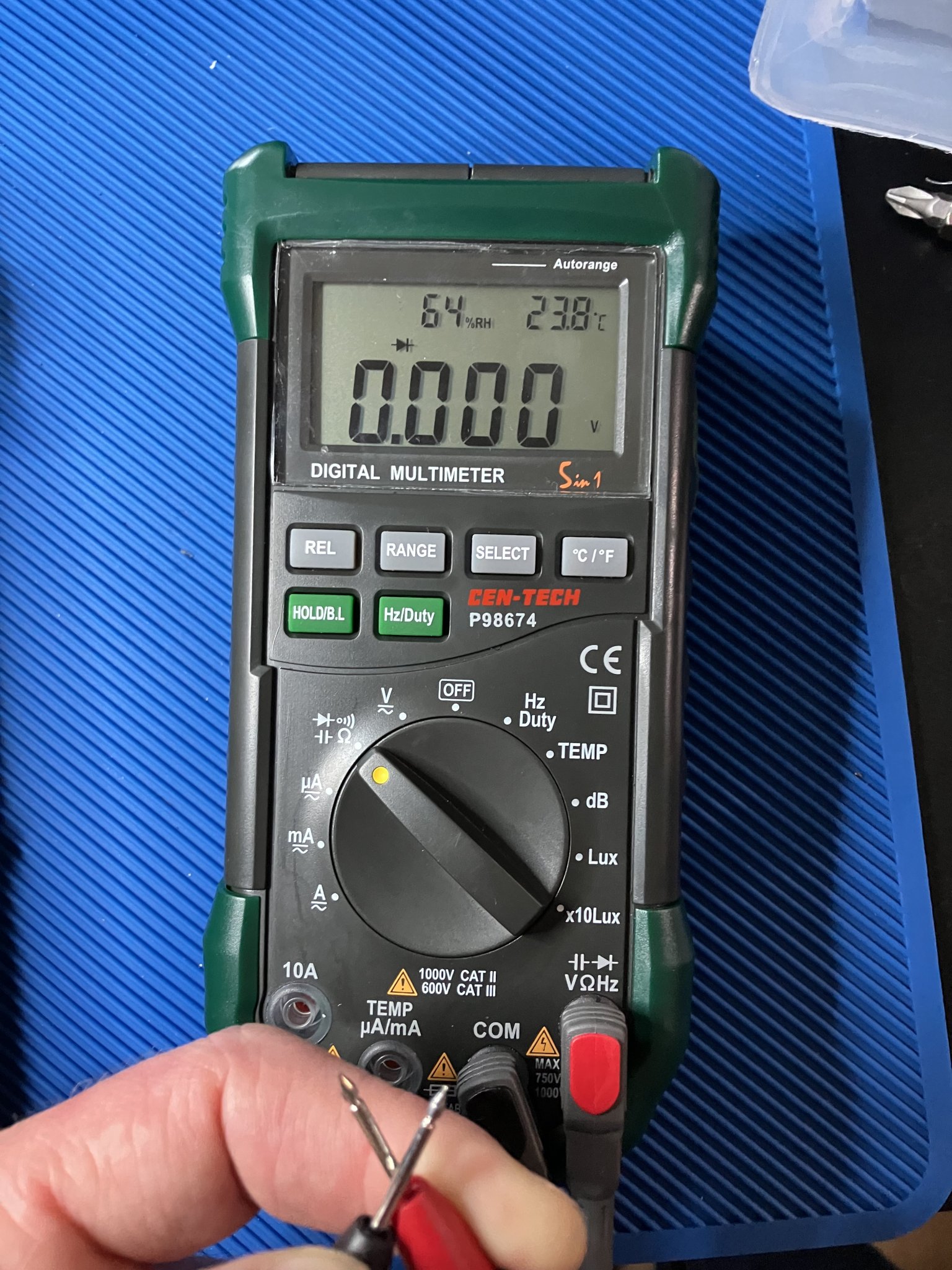

When you touch your meter probes together, what does it read on ohms and diode-check?
What make/model meter?
From here, on, whatever your meter displays for any reading (voltage, resistance, diode-check...), post the exact reading (all digits on both sides of the decimal, unless you're using something like a Keithley 2002).
I have two meters, they’re both kinda cheap. Ones a Harbor Freight Cen-tech P98674. The other is a Kaiweets HT206D. I took pictures of the readings you’re asking for.
The outer terminals of the rectifiers should read 0 ohms. Are you saying that you didn't read well below 1 ohm from terminal 1 to terminal 3?
When checking any 3-terminal component place the meter probes on terminals:
terminal - terminal
1-2
1-3
2-3
With the component out of the board, you should reverse the probe positions and repeat... on both resistance and diode-check to be thorough.
