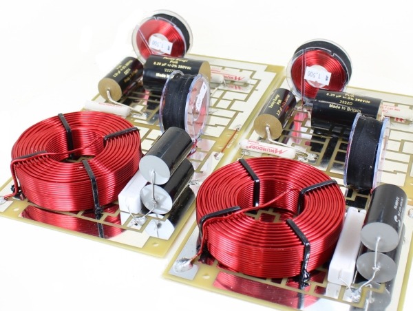

Putting together a feasibility to build the Helios tx project.
Can anyone enlighten me on the part specs for the crossovers, in particular the resistors? Wondering if they are 3k, 12k,5k,3.9k ?

R1= 5 Ohm
R2 = 3 Ohm
R3 = 3,9 Ohm
R4 = 12 Ohm
Resistors are missing the Wattage ratings from the schematic, in general anything under 5 Watts resistors are not suited for the purpose of speaker XO's 10-20 W is probably more suitable for this application. Higher wattage means the resistors can dissipate more effect before they burn up, and generally they will heat up less and be bigger in size.
L1 = 3,01 milli Henries
L2 = 400 mikro Henries
L3 = 1,5 mH
Inductors are denoted with gauge and type, but the resistance will only be in the ballpark without values
C1 = 2,2 mikro Farad
C2 = 8,2 mikro Farad
C3 = 17 mikro Farad

For the resistors they are R1=5ohm, R2=3ohm, R3=3.9ohm, R4=12ohm. You should be looking at 10W rating for the tweeter and posibly 20W rating for the Woofer but you can simulate in Vituix and see what power is ping through each component.

L1 has a description of 3.01mh 16 gauge iron laminate. Does that mean iron core. Looking at the picture it doesn’t appear to be iron core
It won't really make much difference. There's only 0.2 ohms DCR difference between the aircore and iron core. The iron core being the lower DCR (DC resistance). There are some that claim they can hear the difference between air and iron core. If given the option, aircore inductors are preferred unless very large inductance is required or lower impedance is needed to reduce losses. so Madisound using an aircore 14awg is perfectly fine.
