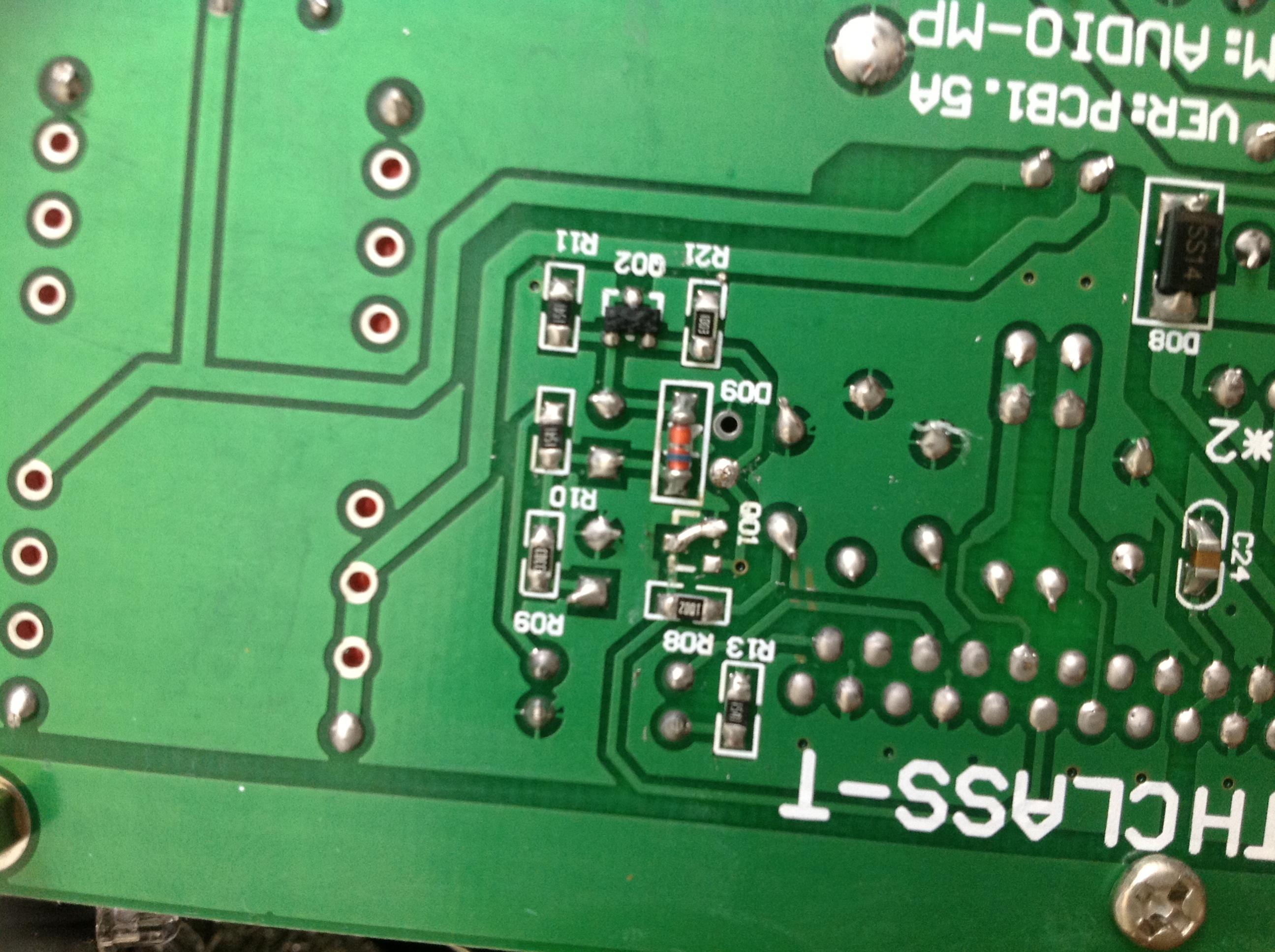

I contacted Helder. He is really cool and prompt with his response. He said that a 12V 7Ah battery is not enough power. He said you need a solid 13.5 V power supply for this TA2020 MK2. Weird. The Helder TA2024, Lepai TA2020 and the Yuanjing TA2020 perform well in the same system with the same battery. He also said that he would try and find a solution for me. Great guy.

fixing issue with MKII amp switch off
Hi there, there is a fix for this isue ands its elatively simple, the unitswitches on at 13.5V because there is a delay circuit that reduces the switch on pop.
This can be bypassed by removing the transistor that feeds the mute line, and shorting it to ground. this connects the mute pin to GND, and that switches mute off, allowing voltages as low as 11 volts.
you have to remove Q01 and short R08 to GND ( the end that's connected straight to the IC )
Then the issue is solved.
