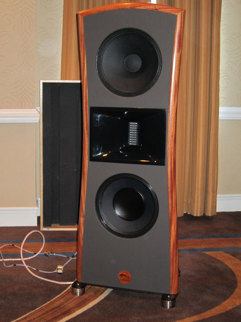

The Beyma TPL-150 is an AMT that also comes in a horn loaded version. Note that an AMT works by squeezing air between folded pleats and doesn't have the same "Bl" force as a compression driver so doesn't like to be loaded with any type of high pressure drop system.
Mundorf has some horn loaded AMT's on their website, it may be worthwhile for you to check them out. I think they are listed under the "professional" series.
