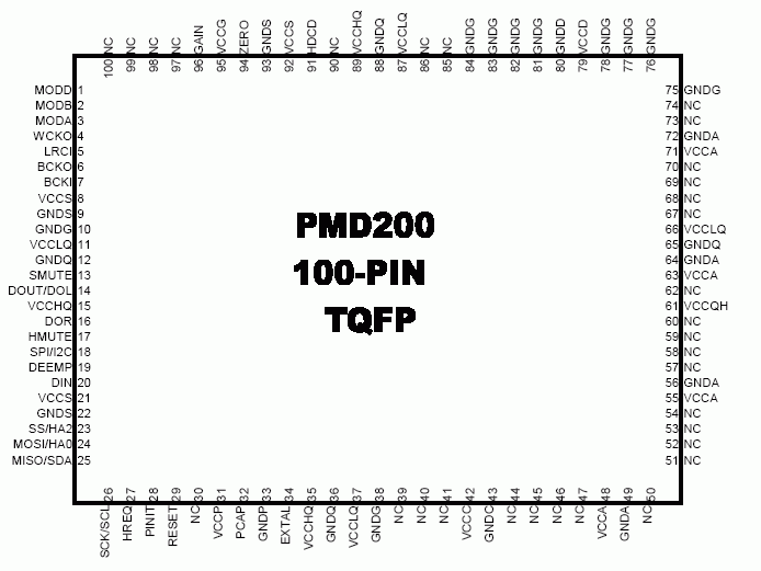

Well, it finally is unbearable. The desire to tweak my Shanling CD T-100. And I mean with more than just OPA627 plugins.
I have pretty much decided on what do around the DAC's and in the analog stage. Yet there remains a little problem. The stupid HDCD Filter.
What I need to know, does the PMD200 retain the "Hack" option to kill the on Chip (digital) 6db attenuation for the non HD CD's? If so, how to access? Has anyone got a datasheet (I have the one for the PMD100, but the differences appear large enough that this is useless)?

Hi!
It seems that a pin called "GAIN (Pin 96)" is the Gain-Scale-Control;
"Gain Scale Control (output) – GAIN will go LOW for non-HDCD
recordings, and HDCD recordings that do not use peak
extension. GAIN will go HIGH for HDCD recordings that use peak
extension."

Konnichiwa,
First thanks to all helping to locate the PMD200 Datasheet. Looking at the schematic of the CDP, the F*#%$£$ Filter is under software control and the signal is routed through the F*#%$£$ CS8420 even with upsampling off and the is too under software control.
Looks like I'll be connecting the PMD200 directly to the decoder with a reclocking daughterboard inbetween. Has anyone got a daughterboard PCB for 4 X 74AC74 and so on plus clock input (or on board KC7 or the like?). Then I can place the Digital Filter into hardware mode and take control. Why, oh why did it HAVE to be a 100 Pin SMD Chip with minimal pin pitch. I hated those even in the days when I still was fixing gear on a day to day basis.
