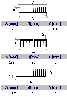

Here is my next question. I going to build class A amplifier - about 20-30W per channel. So I need good heatsinks. I found something like this in the picture. So if I used 4 of the biggest ones, 2 per side, 10cm in height would it be sufficient
But there is possible problem - they are not anodized
- pure aluminium. Did someone of you anodizing by himself - or mayby link to "DIY - anodizing heatsinks" 😉
But price seems good - 4 x 16z³ is about 16$ - for them all 😀 - is it good price?

OKI - forget about anodizing.
Is there a big difference in heat dissipation between black anodized and non-anodized aluminium 😕

Well - I have downloaded this page before but I didn't read it all - sorry if I bother You without reason
And about anodizind - I found it is quite simple operation - but dimensions of that heatsinks are to big to process them in my house
