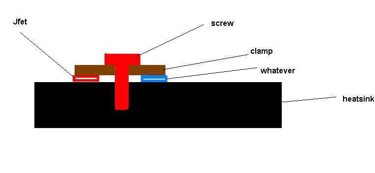

OK guys, i'd like to see some pictures of how you're doing this!
seeing as i'm going to be wiring my Zen 8 circuit point to point, i really
need the JFET to be secure.

mpmarino said:digikey doesn't seem to stock those 'whatevers'. any idea where to get one?![]()
what?
grey didn't send same number of whatevers as Jfets- in same envelope?
Oh, man...so that's why I've got so many 'whatevers' sitting here! I forgot to send the silly things out with the JFETs.

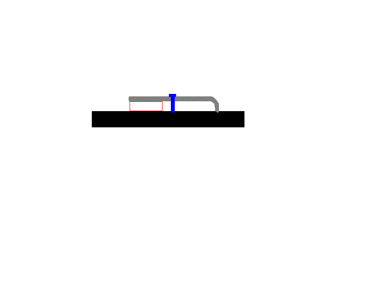

mpmarino said:Choky's solution is real good IMHO. The most common way I have seen a single device mounted in an industrial/heavy commercial app is as follows. The gray bar being a bent piece of heavy guage steel.
off course I am in right....
same as with clamping speaker baskets in some pro applications.........
See this heatsink.
where? what?
As I do not know what is whatever
i can use any other DPAK transistors which is useless or obsolete as "whatever".

The general idea will work, but a heatsink that small is going to get awfully hot with two or three watts going through it. Your other option, of course, is to limit the heat the JFET produces to something that the heatsink can handle.

Drill a hole in the top of that and you have instant screw on clamp.😎
Mount the JFet directly on the heatsink. This heatsink is then mounted onto the big heatsink with insulation in between.

I very much prefer a bolt on each side of the devices, as it makes for a far more even pressure on the device.
Steen🙂
