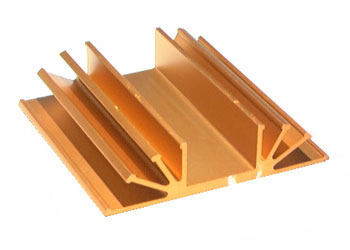

Hundreds of heatsink designs and shapes available, you´ll need something like this:
Artículo 5075 ZD-28
Dimensions:
Base: 104mm
Fin Height: 25.4mm
Core thickness 4,75mm.
Finless center width: 32mm.
Thermal resistance: 2.9º C/W for 75mm height (mounted vertically)
Compact size, no fan needed since sink temperature will rise 14*2.9=40.6 deg. C above ambient temperature.
Do the Math for actual junction rise above that: 7W * Rth JC +1.2 Deg C/W (mica + grease).

An improvement of course, but you must consider the whole chain end to end:
Junction > case > Mica > aluminum HS > air
