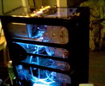

have a look at this link. u could allways go with a fan with a thermister on board that way u can a the full 12v and let the fan do the stepping. i of course went with thermaltake water cooler
works great🙄

got plexi?
