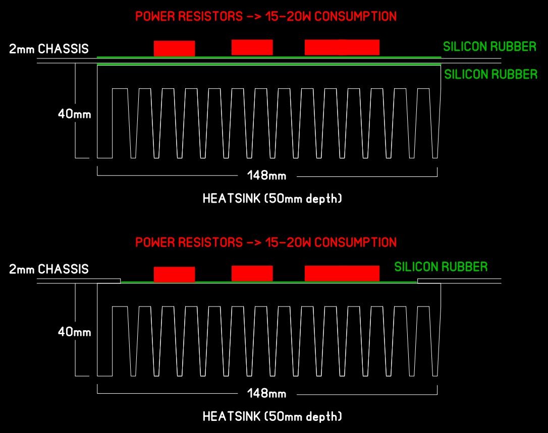

Hello everyone,
I am building a small guitar valve amplifier (this will matter later), and I will include a power attenuator. I have dedicated a heatsink to the attenuator part, and my question is whether there will be a significant difference in thermal spreading if I attach the power resistors directly on the heatsink (cutting a large chassis area off) or if was to leave the chassis sit in between.
I attach a detailed plan of the two placements. The chassis is made of 2mm AlMg3 (Aluminum 5754) and its total dimensions are 490 x 200 x 65mm. Since the amp is a guitar combo, all valves (and the heatsink) will be facing downwards - thus, I expect the chassis to get a bit warm or hot, regardless of the attenuator usage. The heatsink is bare aluminum, having a theoretical thermal resistance of about 1 C/W.
Correct me if I'm wrong: I assume that in the case of leaving the chassis sandwiched between heatsink and resistors, I will get a poorer thermal transfer to the heatsink, but "gain" a bit thermal spreading on the chassis. Whereas on the other case, thermal spreading to the chassis will be minimum, and transfer to the heatsink maximum. Do you think that the two solutions will differ significantly in:
(1) steady state resistor temperature
(2) steady state chassis temperature?
I understand that usually, you mount everything directly to the heatsink, but I was wondering if this could really make a difference here. Also, is there a way of calculating the thermal resistance values for the application? I tried some online calculators but got very different results.
Thanks!

Convection is hard to model well, conduction in the heatsink is simple by comparison. Here the convection is important so I'd suggest experimentation is simpler than trying to model accurately something with a mix of air convection and metal conduction.
Well experimentation is always best, but this would require cutting off a chassis area, which is irreversible! 😛
My plan was not to cut the chassis at first - but again, assembling the amp and then deciding that the best solution was to cut the chassis to get directly to the heatsink, is practically impossible to implement.
I have given it some thought and I believe I must decide based on theory.. The difference could be slight, but hey, this is what a scientific discussion is all about - learning and planning based on what seems right at first.
The problem is not the heat transfer from the amp to the heatsink, but as Mark alluded to, the heat transfer from the heatsink to ambient.
Putting the heatsink upside down underneath the amp is the very worst you can do.
Second best is on top, best is sideways a bit elevated so that you have some air flow through the fins of the sink.
I do not know your reasons why you want it the way you showed it but from a heat management point of view you can't do worse.
You should be ready to at least double the heatsink or maybe more to give the amp a fighting chance to survive.

I am well aware that this is the worst orientation - this was the only option for me layout-wise, as I said this is a guitar combo amp with certain compromises.
I understand that deciding the best between two bad solutions might not be optimal compared to planning the best solution in the first place, but this is what triggered my question.. I always overengineer things, but hey, sometimes it's ok to not go for it. This is actually the experimentation part for me.
Still, would this mean that maybe spreading the heat across the whole chassis would help better than rely on the heatsink alone? Or maybe this would mean the chassis could become untouchable compared to the heatsink solution?

Adding the chassis as a heatsink will certainly help.
Unless it gets so hot that you can't play anymore.
Hard to say in advance.
BTW What is the purpose of those power resistors? Surely there must be a smart way around that?

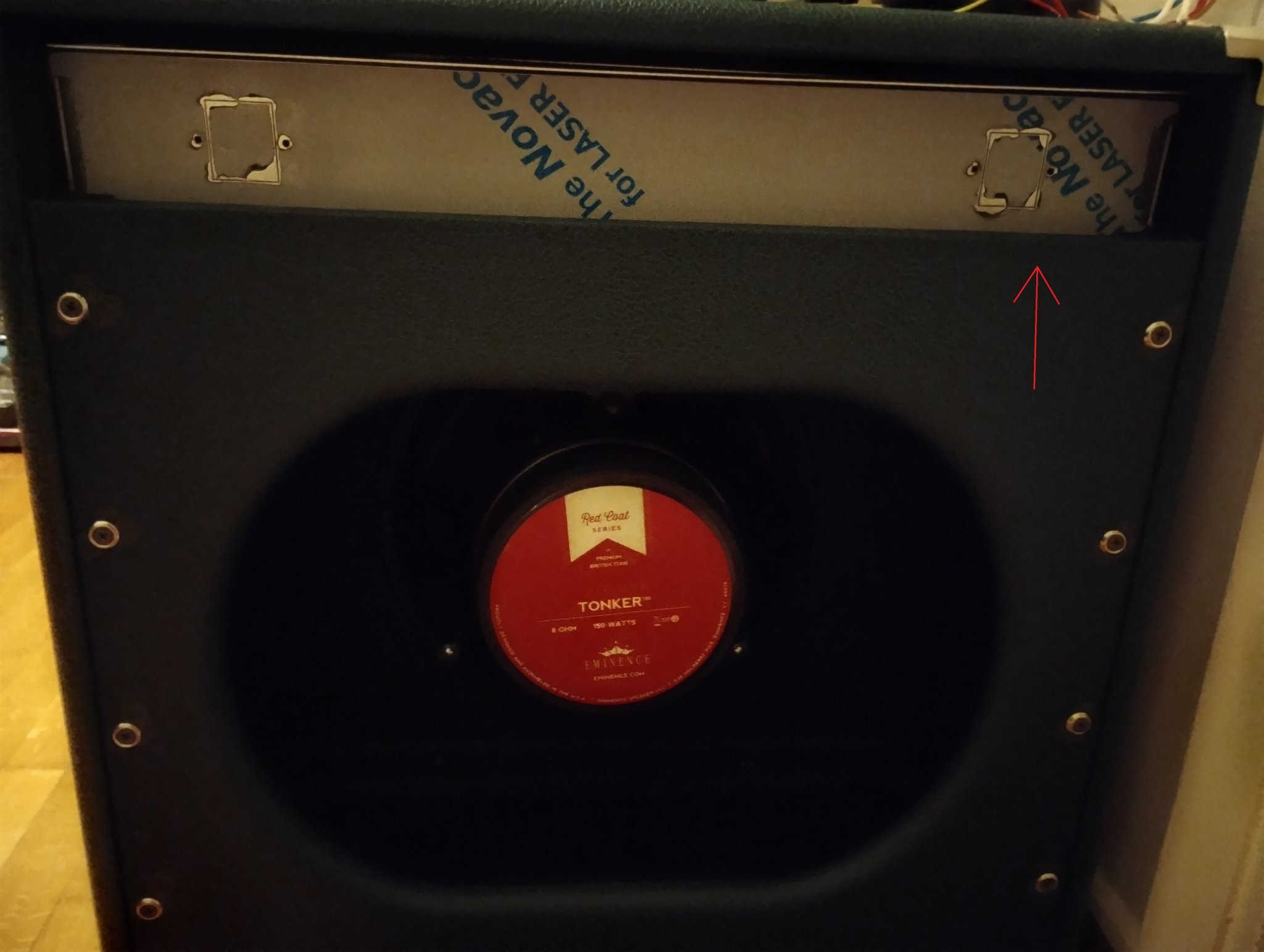

Maybe you can show a picture of your current cabinet, because at this point it's a little hard to understand the whole context?
Thanks for the answer! Exactly, the reason why I did not put much effort on this was that it is quite unlikely that 15W will be dissipated constantly.
I will not use the output valves as triodes, but I will include a switch for ultra linear operation.

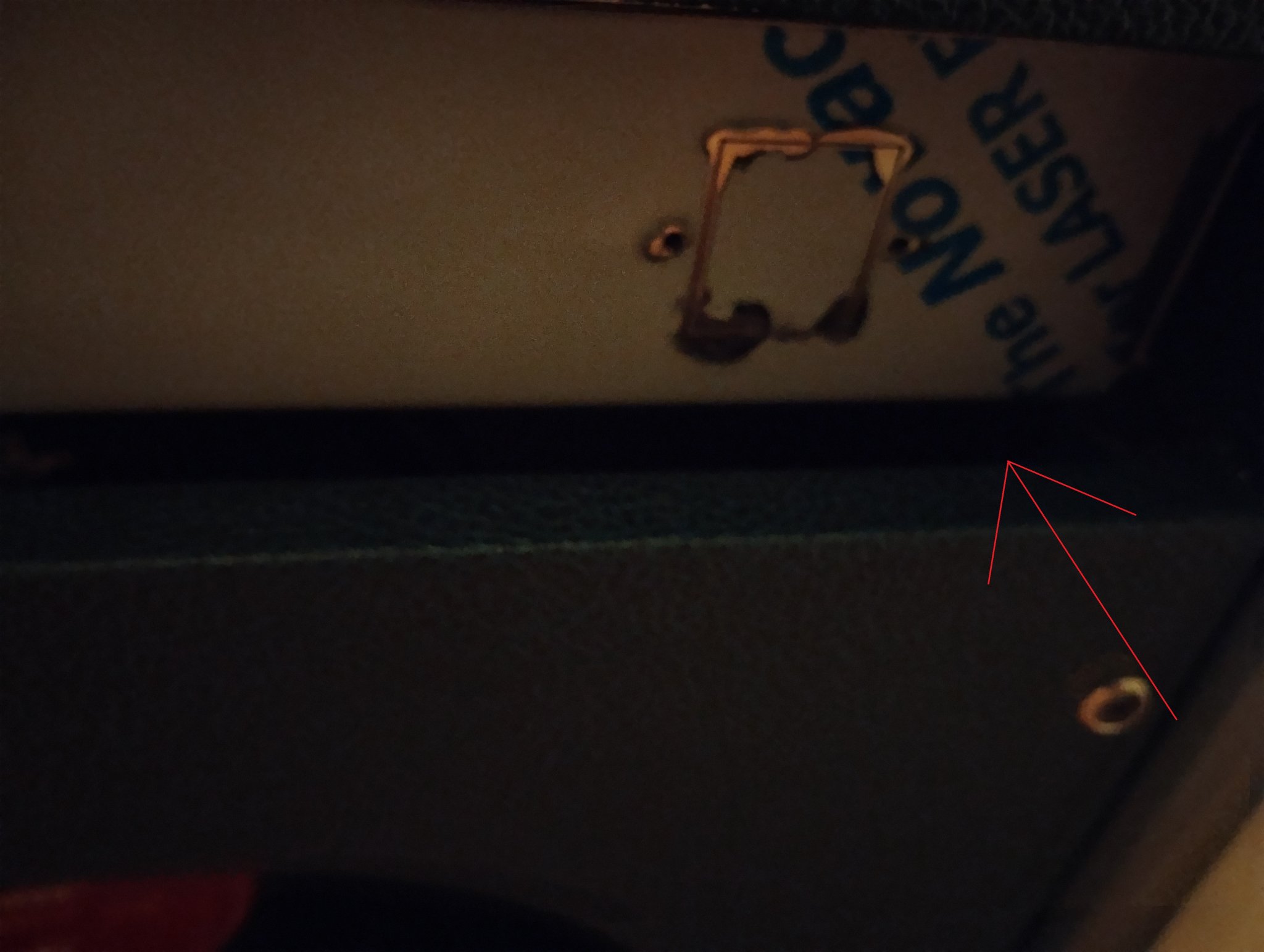

I attach two pictures (the amp is not assembled yet) - one of the back of the amp, and a small detail on the gap that the chassis will have from its back wood panel. The red arrow shows the approximate location of the heatsink - outside and underneath the chassis, close to the edge.
It is a quite typical combo guitar amp arrangement - I am not sure I have properly answered your question, if not tell me what more I can send.
Everything goes downwards, so heat is always a bigger problem.
Mount the heat sources directly to the heatsink. Unless both surfaces of the chassis are mirror-finish, perfectly flat, you'll be adding thermal resistance.
If chassis is aluminum it won't hurt and in fact help heatsink.
Horizontal heatsink is the worst but the real point is: will it be enough?
I guess it is.
Horizontal aluminum chassis have been used as heatsinks since forever in guitar amps .
Is it "the best"?
No.
Is it available and "enough"?
You bet.

You should be thermally Ok (are the fins sticking out the back, I'm confused, you said chassis Top) but I got to thinking by the time you lay out all the chassis drill-throughs accurately enough (got a milling machine?) and tap the sink + the grease mess you may be better off just getting the rectangular cut out in the chassis to clear the resistors. I guess you could screw it together first.. When you don't need any electrical isolation any kind of washer is just a problem unless you're in some kind of volume production situation where it's just cheaper.
I think it will still be ok if upside down behind that slot but the closer to it and further away from the tubes is obviously better. Please run it and post temperature measurements.
