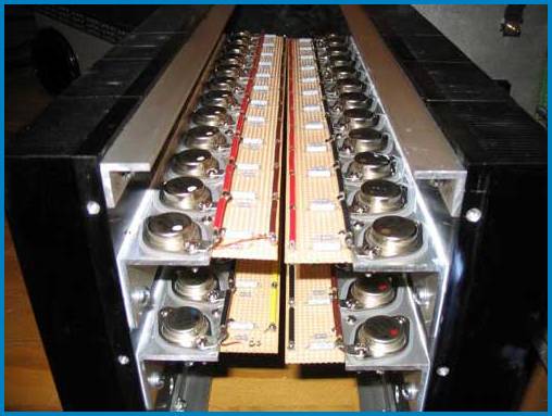

Most of my amps are based on L shape 4.5mm aluminioum corner that then is attached to the heatsink with bolts and screws ......
In between always and of course is as much paste is possible to ensure better heat transfer from one element to the other.
(Many times crossed my mind to make my own paste made out of the normal white paste we buy at the hardware shops but mixed with aluminioum powder which i can have plenty from local aluminioum shops . Never tryied that but sounds like a good idea )
One other thing i know very well is that not all L shape aluminioum is good to be a heatsink since it is very importand what material is actually made of .
And finally specially made L shape are sold in shops with the iner corner rounded which quicker transfers heat to the main heatsink.
The idea crossed my mind lately is to weld the L to the main heatsink ......since i can do that now i will give it a try and let you know .
In between idlike to listen to your opinion about that
one will say why not buy ready made heatsink that is already shaped to meet your standards ....Then i have to answer that i have so much hetasink in my shop from various projects that i have to convert to fit any amp i construct, and also there is so much heatsink from classic 2N3055 style transistors and i really like to make this usefull again by welding parts on it so it can be used for other devices also

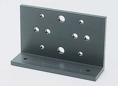

Using L-shaped aluminum bars has been used many times
for TO-3 devices this is one of the best ways
in my country of sweden, and in other parts of EUROPE,
www.elfa.se
they sell the follwing special bars
specially made for TO-3 or other transistors

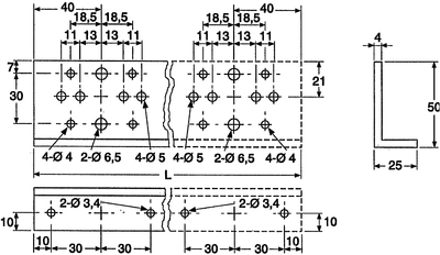

They come in two lengths:
- 80 mm wide, either drilled for 2 x TO-3
or not drilled any holes
- 160 mm wide, predirlled for 4 x TO-3
or un-drilled

These are the dimension
of the L-shaped brackets.
These www.elfa.se will sell to anyone in Europe.
Manufacturer: Austerlitz
L shape bracket to provide heat conducting connection between transistors and heatsink. Undrilled, or drilled for transistors and heatsink.
Material: Aluminium, black anodised.

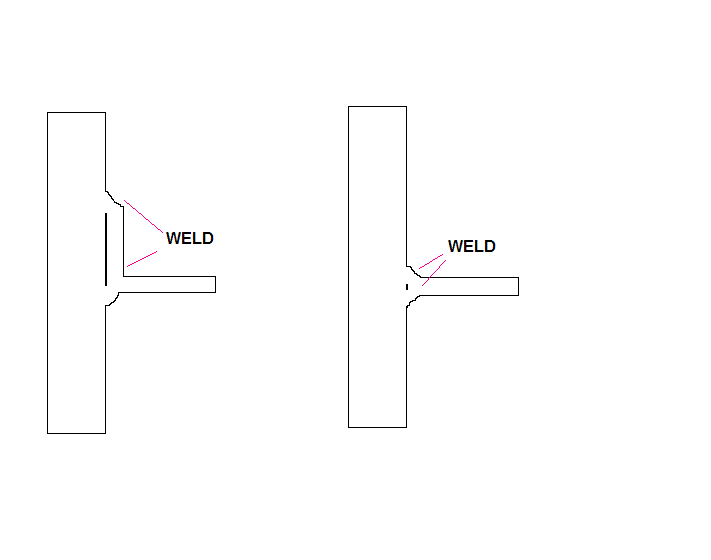

the question remains :
if the L shape will perform beter with paste bolts and screws or welding

Welding aluminum is tricky - you need shielding gas and the parts need to be heated up before you start or they could warp.
If you can weld aluminum cleanly, welding will be the best way. Welding would connect the metal parts together without a joint between, just continuous metal.

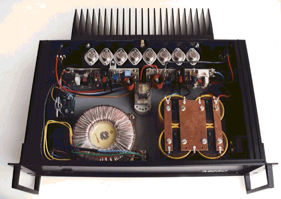

this is the road most diy builder takes
TO247 or similar are most popular cases
Nelson Pass has told me once he was in favour of TO3.
I prefer TO3.
A ot of constant heat Class A amplifiers are thing me and Mr. Pass have in common.
1. Metal Case TO3 have max Tj=200 C
while Plastic case TO247 most are max Tj=150
This means an extra 50 C temp margin if use TO3.
2. Nelson Pass pointed out that TO3 metal, with 2 screws
are not sensitive to if you fasten screws TOO TIGHT.
They are mechnical robust, in compare to plastic cases, like TO247.
So they are not as easily mechanically destroyed.
In most plastic case transistors, with only one hole,
you can cause internal damage to the package ,
if you use too much force to fasten the transistor.
This of course one issue with TO126 (BD139 etc).
But also TO220 & TO247 variants needs special care to draw your screws
with proper momentus of force. Not too much .. not to little.
3. Two screws are better than one, fitting a big transistor tight and distribute the pressure.
As this puts the pressure more all over the backside of transistor
that is to be in full contact with heatsink.
Now, for Class AB moderate power and lower Class A idle power,
it is no big deal using TO247 .. there are some rugged such.
And you can use very large heatsinks instead + parallel devces if you wish.
IRF240 / IRF9240, for example, has got this 50 C degrees lower.
Max junction of 'only' 150 C.
Nelson Pass uses them 😉 😉
Maybe because he has learnt DIY Audio people prefer PLASTICS 😀
But if you are purist & not want to paralell + you want to use higher amount of idle power,
for higher output in Class A (or very high power Class AB)
then TO3 is one way to go.
I can recommend this.
And in this TO3 case it is nice to be able to attach TO3 devices
using these L-Shaped bars.
Anyone that has drilled very big heatsinks, for TO3 .. will know 😀
Lineup Transistor Choice service for home builders
Lineup
Pass DIY A75 build mount of TO3
here you have an example
what can be done with TO3 METALLIC HOUSING power transistors
Nelson Pass DIY, A75 power amplifier:
http://www.passdiy.com/gallery-misc-framed-leftframe.htm#A75
Lineup 😎
Lineup 😎

Re: Re: thanks bonsai
If it's not a full pen weld then there will be an air/gas gap between the faces.
If a flange is attached to the face of the heatsink then full pen can be achieved, but we still have to contend with the difficulties of distortion free aluminium welding.
However, the thermal conduction path of a welded flange is considerably smaller than the thermal path of a bolted face.
Test it to find out which is better.
one cannot achieve a full penetration weld when attaching the face of an L bracket to the face of a heatsink.MJL21193 said:Welding would connect the metal parts together without a joint between, just continuous metal.

It doesn't need to be to be better than the bolt-on. The welded area need only be as thick as the thin profile of the angle itself. Conduction of any energy is only as efficient as the weakest link in the chain, in this case, the thinest section of the angle.
Instead of welding an angle, weld a flat piece perpendicular to the face of the heatsink. See illustration:
AndrewT said:one cannot achieve a full penetration weld when attaching the face of an L bracket to the face of a heatsink.
Hi Andrew,
this is what ia also
had in mind ....since if you can weld there is no point on using L shape on the other hand by this logic you can go in higher thiknes
