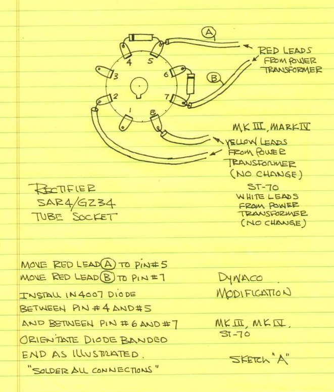

You can do the diode mod which is adding SS diodes in series to pins #4 & 6 of the rectifier tube which will help it last as it takes some of the load off of it while keeping the slow warm up the the GZ34/5AR4 is famous for. It should improve the bass a little.
Then you can experiment further by removing the tube and jumpering in SS diodes. Use the newer faster & quieter UF4007 for a few cents more all mentioned over the older IN4007.
You can also buy aftermarket plug in tube SS rect. subs. Google. Copper ones.
The mod shown in the diagram uses unused pins on the rectifier tube to mount the SS diodes. Pay attention to the polarity.
The mod also helps the rectifier tube last when you have a power failure where it flashes off and on which someone can accidentally do with your amp.

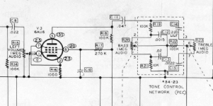

New question about the tone controls
Recently I have replaced the original PEC tone packages with discreet components.
The question I have is why each knob seems to operate differently now. The treble seems responsive as it should but raises the volume when turned up whereas before this wasn't the case.
Also, the bass doesn't seem to do as much as it used to. If turned all the way down then I can detect a drop in bass some, but not like before. From half way to all the way up doesn't seem to do much either.
I've also replaced the pots from original as well. They are alpha dual-gang 1meg. Although the treble pot is close to 1meg, the bass side for both Left and Right are closer to 800K.
Could I need to wait for the parts to break in? It doesn't seem like something that time would help.
Any clarification on why this would be different or how to troubleshoot would be much appreciated!

I've also attached a pic of the new tone control setup for review. As mentioned, the Bass control isn't very interactive, and the amp seems woofy when controls are at 12 o'clock and the treble boosts volume when turned up noticeably. I can't recall too well how it sounded when the old packaged controls were in there but it seemed like they did more than they are now. I also believe I have wired up the new tone section properly based on the schematic.

You might need a squarewave generator and scope to sort this out, because passive tone controls often don't work like you expect them to. As an example, the Dynaco SCA-35 kit assembly instructions require deliberately offsetting the knobs on the control shafts to achieve flat frequency response at the straight-up setting.
Edit: I see what looks like .0022 uF caps in four places, but the schematic shows them in only two places. And I don't see any 220pF caps, which the schematic also shows in two places.

To answer the question about the components, you're seeing both sides of the amp there (left and right channels).
I've attached the schematic here to help visually match up what's going on in the picture. I was originally going to use a perf board to mount all the components to but then was unable to imagine a way to attach all that, so soldering directly to the pots it is. Also, it makes it easier to follow the schematic. Makes you appreciate how say a fender deluxe schematic can be transformed into the eyelet board layout they have!
All those caps are panasonic film. Is there a way to hear the amp flat to rule out tone controls that doesn't involve to much work? Ideally I have a reference tone and A/B the amp in and out, adjust the tone until it matches, and then see where "flat" is. Right now the biggest thing is the bass being too present. Almost like someone having turned it up too much and getting that really overwhelming mids sound. Maybe the combination of tubes and the new components (which are a year old at this point) are making for an unfavourable sound?

Your schematic differs from the original Heathkit schematic I retrieved. See attachment. Based on what I know about passive tone control design, yours probably is incorrect. If you want to hear the amp sans tone controls, just replace the tone stack with a simple resistive voltage divider of, say, 390K and 47K attached to the right side of C11 (Heath schematic) with its tap going where the treble pot wiper went. This divider should yield roughly similar attenuation relative to passive tone controls set flat. Tube rolling is a fruitless exercise in most cases. You can make a lot more progress by spending the money on books and test equipment instead.
I do have the original manual as well which looks like the screen you posted. Same tone network too, just different layout. One thing that caught my eye was the 220uuf value for the treble side.
In my screenshot, the left and right side of the pot has .0022uf values, which is what I have put in.
In your schematic, it outlines the left side as being 220uuf (which is 220pF, which is 0.00022uF). I'm wondering which is right? How much difference could that one value make (220pf vs 2200pf)?
