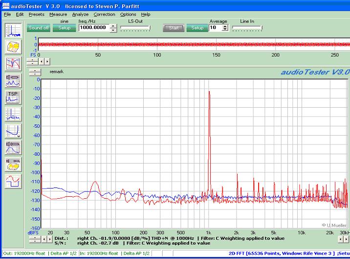

I have an IG-18 (1969?) that I just finished doing most of the mods per the Williamson article. I have not done the driver transistor pair yet as I am waiting on parts. I have a pair of 2SC2235/2SA965 on order (ebay) to try.
I also have an HP333A that shows almost identical distortion numbers, so I believe the plots I'm getting with AudioTester V3 thorugh my M-Audio M-192.
I get less distortion (0.008%thd) and higher harmonic/interference with the IG-18 than I do if I use the computer sound card output (M-192). This is at 1Vrms.
A LM317 may be next after the driver transistors.

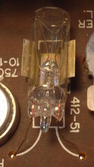

Now, a question -- what is the lamp type used for L1 in the IG-18? I no longer own one. but need to know....

The lamp does not have any markings. The circuit board has an HP part number of 412-51.
In the instruction/assembly manual it's just "Lamp".
After a lot of searching and asking in other fora, it appears that the lamp MIGHT be a T2 wire lead type 120PS -- 120V @ 25mA, 4800 ohms hot, perhaps 500-800 ohms cold. If someone with an IG-18 or -5218 can measure the cold resistance, it would really help to pin this down. An IG-18 is on its way to me now via USPS, so more fun lies ahead with before and after results of greening.
The bridged-tee frequency selector is in the negative feedback loop and the amount of neg. feedback keeps the unit from oscillating at any frequency except for the tuned frequency. With the 10:1 ratio capacitor values Heath used -- which are both good for tuning and very practical, because caps can be shared between ranges, making for lower cost -- the attenuation of the tuned signal is about 15-16dB, making the attenuation approximately 6X at tuning center. This means that the positive feedback leg has to have an attenuation of the output signal of approximately the same amount. If you assume that Heath thought that the feedback adjust pot should operate near the middle of its range, then the ground leg of the feedback attenuator would be around 375 ohms. For 6X attenuation, the feedback leg would have to be around 1800-1900 ohms -- a very reasonable value for the 120PS lamp with some current running through it.
Thx Jim -- can you easily unsolder one leg of the lamp and measure it again? It's very hard to estimate the true value when it's in-circuit with all the DC paths.

With one leg lifted I measure 258 Ohms. I'm glad I opened it. I found an unsoldered joint, now fixed.

Thx, Jim -- wow, that's a lot lower than I expected. Now I have to rethink that lamp type -- 120PS doesn't seem to be the one.
