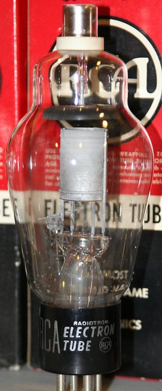

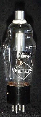

There is yet another caution that pertains to NOS American made 866As with the larger bottle size from the 60s & 70s etc. This is compaired to the smaller size of European manufacture and later American types. See the sample pixs below. The older fat bottle types have a coating on the plate, and sometimes on the cathode shield too, that flakes off when heated. The flakes can, and very often do, get between the plate and cathode causing serious damage to the tube. It's like a small internal explosion. You can usually spot these tubes because there will be a slight orange-peel texture to the plate surface. Flaking happens rather quickly even as the mercury is vaporizing. This same problem is also common to the older 816s and 872s. Although I've never seen it with the European 866AX types with the screw on plate connectors.
