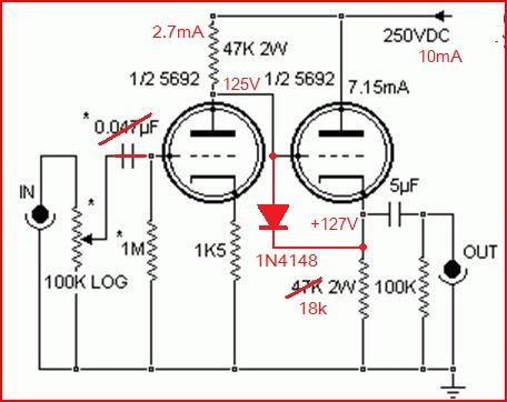

so don't float the heaters - elevate them
connect the centre tap to an elevated voltage source - it doesn't require current, just a voltage reference. Typically, you would aim to be at around 66% of the h-k max, but as long as you are within the range in this situation its not critical.
One trick is to reference the heaters to the cathode itself take the centre tap back to the junction of your bias and load resistors in the cathode of the cathode follower. Again, through a high value resistor, since we don't want current from the heaters entering this circuit!
Sorry about the messy, confusing diagram - ask if you need explanation. Others, feel free to criticise and comment.

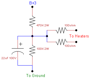

If you're truly worried, you can "elevate" the heaters if the power source is isolated (like most transformers and some SMPS). Tie 300k to B+, tie 75k to that, the other end of 75k to ground. Connect middle point of 300k/75k to heater where you would NORMALLY connect it to ground.
Again. Probably not required at all though for life/safety.
It looks like this. You can use the values in this picture insteadf of 300k/75k if you like. The values aren't critical but most people try for ~80VDC+ Cap is bonus but completely unnecessary.
Likewise, the 100R aren't required. Just tie it to one end of the heaters.
Some people report lower noise with an elevated heater though. YMMV.

Elevating the heater just means to make the heater more positive with respect to the ground. Your circuit, you have ~125V at the cathode making hk voltage of 125V provided you grounded one side (or a centre tap) of the heater supply... Don't float the heater even if it works... It's the best way to find "Gremlins" in your amp later on LOL
If you tie the heater to the B+ through resistors instead of grounding it, you can lower that difference. For instance, 125V - 80V = 45V. within spec of the 100V they say on the sheet.
I find the only time I would really need to elevate is if I'm making a cathode follower with a B+ higher than 350V...
A 0.1uF or 0.22uF (with adequate voltage rating) can effectively be used instead of a 22uF capacitor. These low value caps are also usually film caps which are better at filtering high frequency noise than electrolytics. Just FYI.It is, but I wouldn't worry about it.
