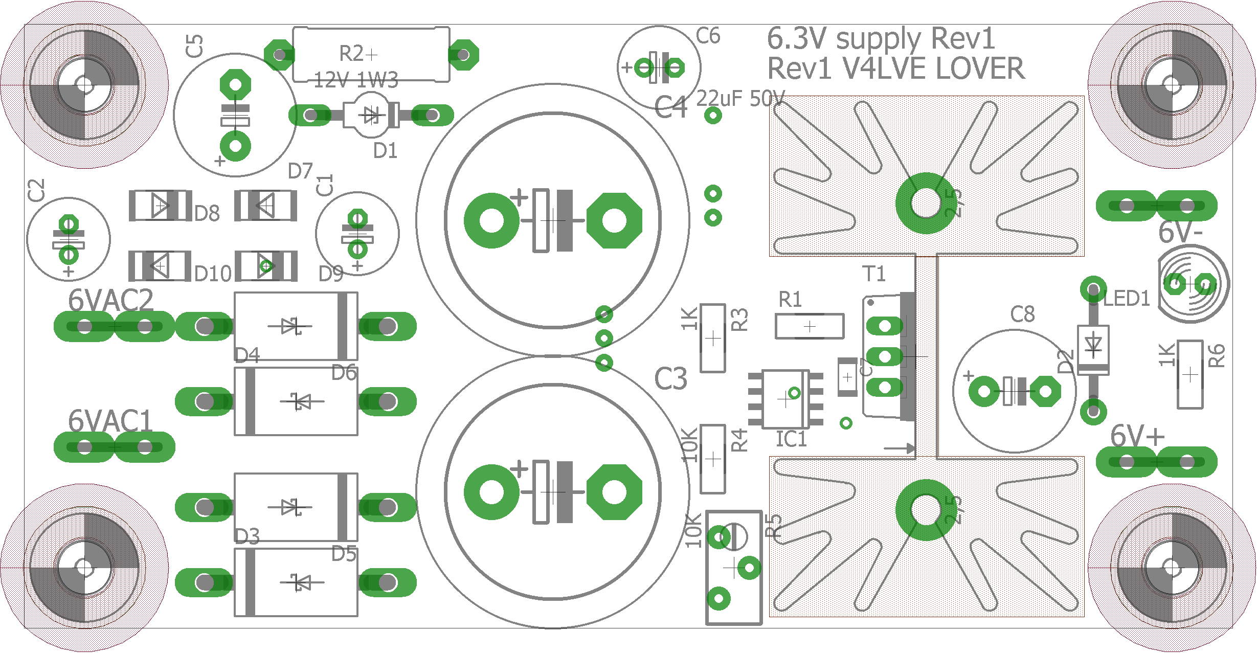

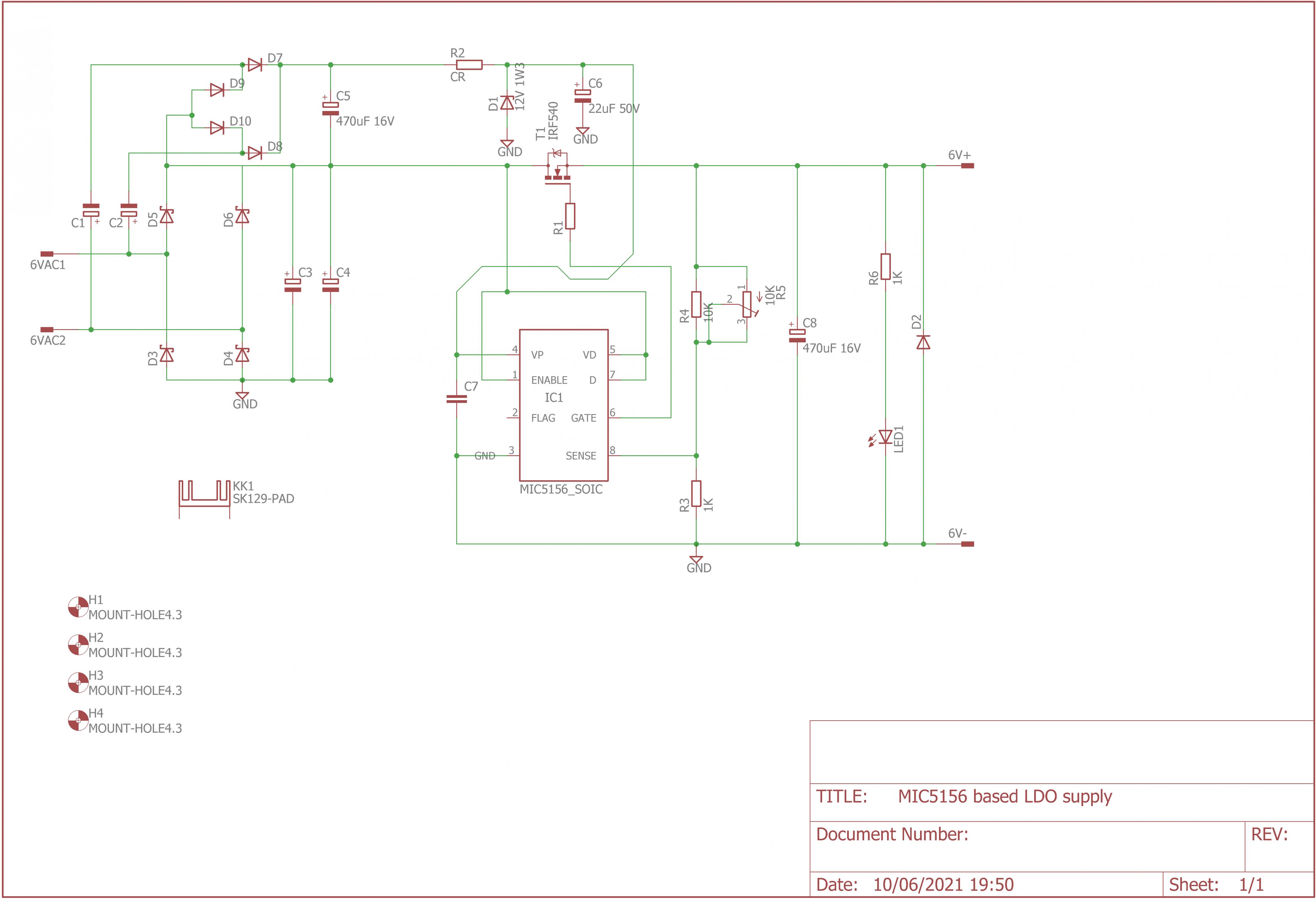

Attached are the gerbers for a simple board using the MIC5156 LDO controller in SOIC-8 to provide 3A of 6.3VAC input 6,3VDC output* This is what you want when efficiency is the goal.
*from a 6A AC 6.3V winding.
An improved version exists with a DIP8/TH version of the controller, but id rather see the geriatric ward struggle.
