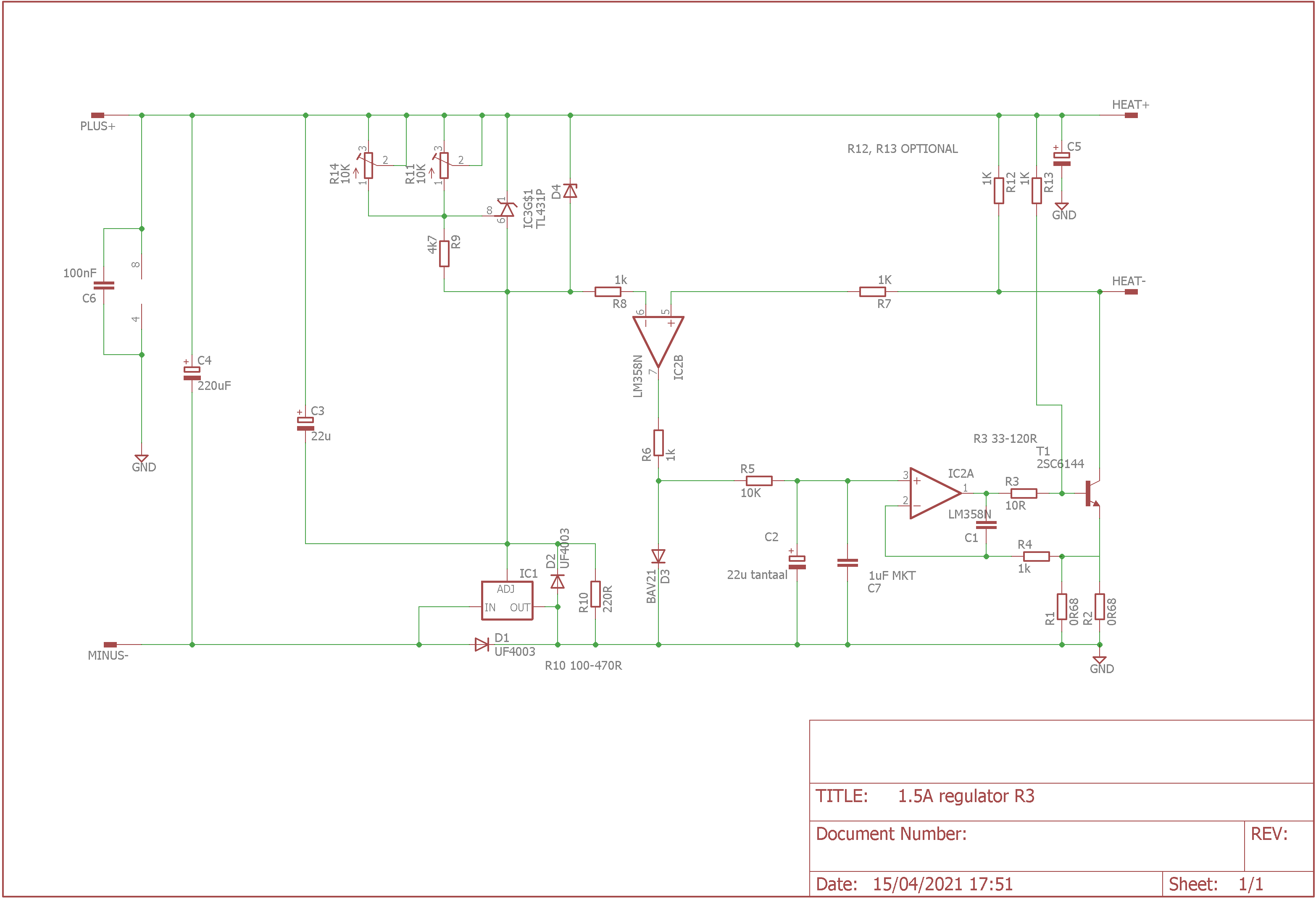

Attached you will find the schematic of the regulator i designed for these kinds of tubes.
Put a big wirewound power resistor across the regulator. Size it to provide two thirds of the current required to run the filament.
The regulator will provide the start up current and then loaf. However it will regulate the voltage all the time!

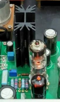

example : for my 6.5V heater requirement, I use 9Vac trafo output (use 6Vac-7Vac) should be fine but 9Vac is that i have. previously i use 15Vac, eventhough i use 2 stacked heatsink, it's very hottt. now with 1 heatsink it still fine
maybe you can test it using regular heatsink vs bolted to chassis and monitor the temperature

You're looking at 2-2.5 W dissipated per regulator. I'd use a small board-mounted heat sink as those shown in Post 10.
Steel isn't fantastic as a heat sink.
It may be that the regulator would survive on the steel heat sink, but you'll get better reliability if it runs cooler.
