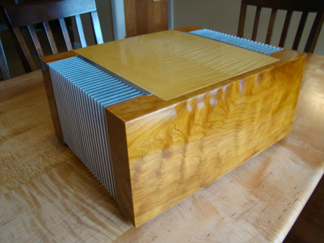

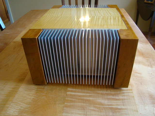

i have this heatsinkUSA 10.080" profiles 6"long. and each of them can handle 65W without any problem. i run 250W dissipation on 4 of this sinks. they are running at about 25c above ambient.
10.080" profiles 6"long should be 0.584c/w according to AAVID, and 65W*0.584 = 37c above ambient is their estimate. They would say 10-12 inch is the correct size for 65W. They are just trying to sell more heat sink than what we actually need?, I don't know...
