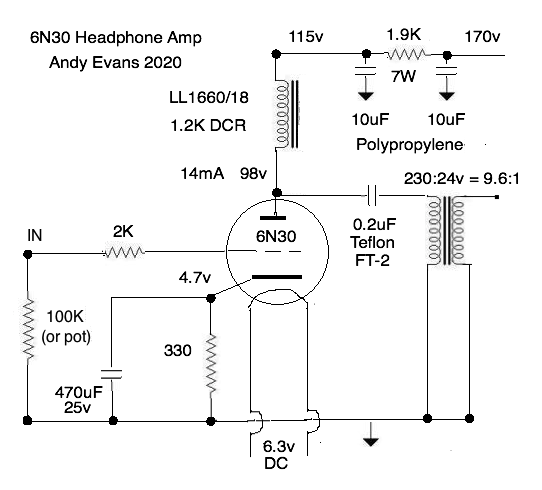

I just built a headphone amp with a simple generic parafeed circuit. Very similar to Jim Hagerman's Tuba but with different parts. If he's still doing kits that's an option. In my case I used a couple of mains toroids as OPTs, 230v/12+12v. This gives me 9.6:1 step-down and sounds excellent. Many choices for a plate choke. Jim uses a Hammond 157G, and you could use Hammond 126B or 126C with just the primary connected. I like using Russian teflon coupling capacitors, but a good polypropylene would be OK. I used a 6N30 but plenty of alternatives for a mu of 1K to 2.5K. Care should be taken with high gain tubes to avoid oscillations - grid stoppers, ferrite beads etc. Oscillations would be a health risk for tinnitus in a head amp.
So here's the circuit. I used a separate PSU with tube rectifier, choke input and all polypropylene caps.

So far in parafeed I've tried out the 6N30 (mu=15) and 6J1P (mu=28) and I have more than enough gain. So next step will be a 4P1L (mu=11). I'm not sure why you didn't use 4P1L instead of 2P29L? I have both, so can try out the difference. I'm hoping for enough gain so I can use a DHT. I'm still using plate chokes since I have some nice ones. With a gyrator I'm even wondering if I could use a 26 at 7mA current? That would be nice.
why to waste ll1660 interstage as a choke?
rather use https://www.lundahltransformers.com/wp-content/uploads/datasheets/2765.pdf
https://www.lundahltransformers.com/wp-content/uploads/datasheets/2774.pdf
