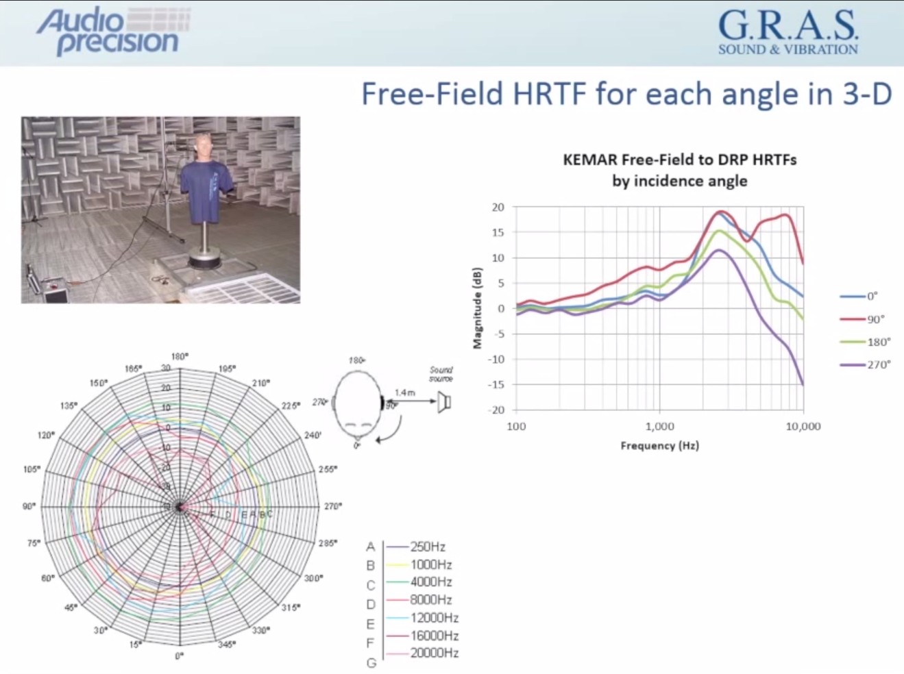

You need an instrumented head/ear canal model with mics mounted where the eardrums are. The ear canal makes a difference. That is why it still sounds good.

Different applications: Headphone Target Response Curve Research Update | InnerFidelity
The headphone speaker is close to the ear in the near field not in the far field like a loudspeaker or a musical instrument. The diffraction of sound around the upper body, head and ear which our brain expects to be present is missing. The distortion of the headphone frequency response is an attempt to compensate for this as well as one or two other things.

This is how your body - torso, head, ear external and internal - modifies sound before you hear it. Headphones, depending on whether they're over ear or deep insert, can bypass some or most of these modifications. The theory is that building the mods into the headphones results in a more natural listening experience.
