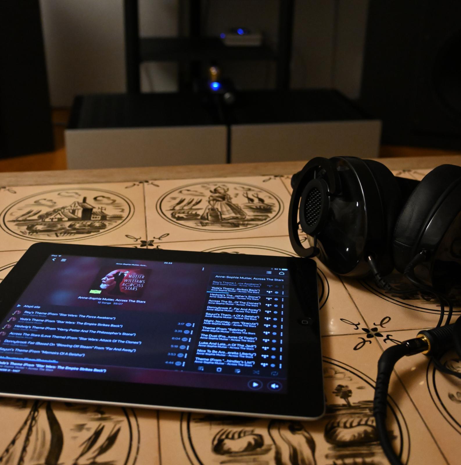

I got my Grado extender cable and it works very well. Then I also tested my camera at ISO 6400. In the background is Starving Student II and the two M2X mono blocks which was switched off for this test. For the AudioQuest headphones the CCS configuration of SS II is the best match as these AQ headphones are already a bit on the "warm side".
Whammy is also a very nice amp for these headphones. I will try this amp again later as I now can sit relaxed and listen to music!
It is good for the late hours…….but still I prefer the large speakers with M2X powered on....
