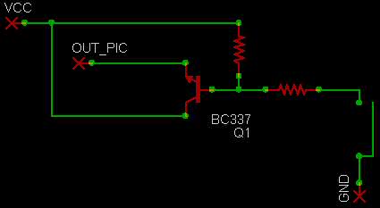

I'm currently working on a pre-amp with built in headphone amplifier and I would like to mute the output of the pre-amp if headphones are plugged in. The headphone jack has a single switch in it (link here) that I would like to use to send a signal to my PIC to mute the output. Attached is an image of my intended circuit.
Would this work? The PIC has an ADC I would be using, so that is not an issue.
Thanks, and don't be too harsh...I'm only a newbie 🙂
EDIT: The little unconnected wire there is supposed to represent a switch...crude I know 🙄

I don't know much (anything) about PIC but I assume that the mute works by applying a voltage within a specified range to a pin. If that's right the key would be to create voltage reference on that range. I don't know how fussy a PIC device is but assuming you already have a clean regulated PS, wouldn't a simple means be to just take a DC feed off the power supply and drop it to the control voltage by means of a zener diode. Then just wire your swith in series with the control voltage.
Alternative: Use the switch to control a DPDT reed relay that switches the preamp output signal either to the headphone amp input or to the preamp output jack. A good reed relay is very quite and should do no harm to the signal. It has the advantage that you can locate where it keeps the signal path short but the contol switch can be where it is convenient. The wire carring the DC control volage can be on any reasonable length and run most anywhere.
You are using an NPN-transistor as a "high side" switch here which I would avoid. Use a PNP transistor instead such as BC327. Also, you need a "pull-down" resistor from the emitter (OUT_PIC) to ground to make this circuit work. Something in the 1-100kohm range would work fine. Most microcontrollers have internal pull-ups/downs that can be activated. It was many years since I used the PIC's but IIRC they have internal pull-ups on some ports.
If you want to make this circuit even simpler you could emit the transistor and just use a pull-up resistor from the headphone switch to VCC although you have to watch out for ESD. It's up to you.

Is there a relay on the main output to do the switching? How would the output be muted? Is there a "power-on delay" to prevent thumps at switch-on?
You don't have to go via the PIC. Whatever mutes and unmutes the output can be arranged so that the output is on when power is ok AND the headphones are unplugged, otherwise it's off.
Hope this helps.
Yes, there is going to be a relay on the main output. As for controlling the possible thump from this, I'm using a 'soft mute' circuit design that should prevent it.
