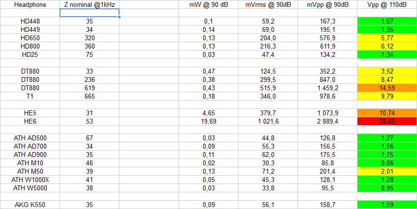

Thanks for your explaination.
On this website, they give us results of headphone tests : Headphone Data Sheet Downloads | InnerFidelity
So now I can calculate the voltage of some headphones for a specific audio pressure.
(With measurements I've done with my headphone, I can determinate that I usually listen music between 86 and 90dB. According with Blues, it's a little too much...)
Thank you for having answer my question 🙂
BT

So, if i've understood, you adviced me to design my amp to drive headphones at 120dB ?
Even if i'll never reach this level (for continuous audio level), there can be some audio pic which need more power to be well listened ?
For exemple, with my HD448 (35ohm), 0.1mW for 90dB, it will be 100mW for 120dB, so 1.9vrms. My amp should deliver 5.3Vpp
