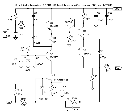

I do not wish to infringe IP, however if the OBH11SE revision "B" is an older design perhaps you could post the schematic for reference? Or perhaps the schematic with the values blanked out?
G.
It is out of production for more than 5 years. Here is the main part of the circuit, omitting power supply, volume control, input and output arrangements. It is class A SE output, so the output devices require heatsinks.
Cheers
Alex
